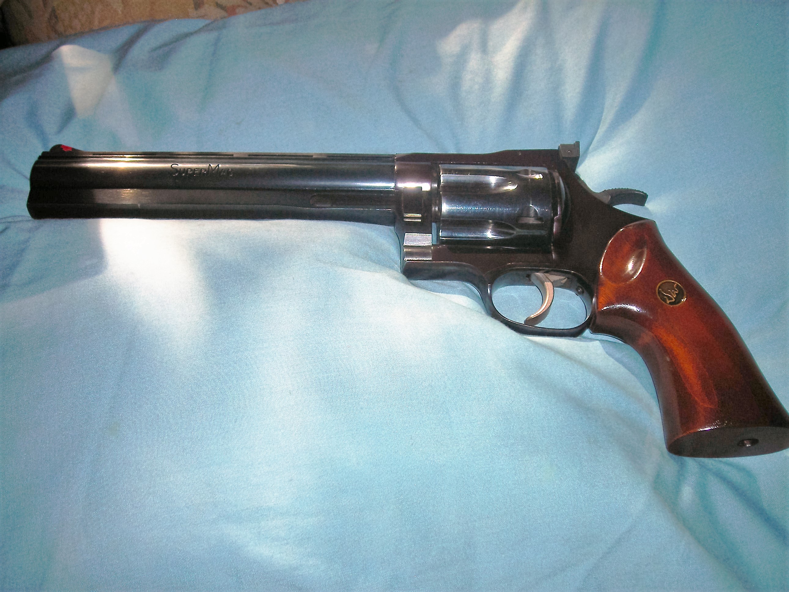

Got the new Dan Wesson to the range yesterday, indoor. No one there at 2;15 ?? So we had the whole range for a while.
Sorry got no pics, just a shreaded target [if you want to see it] :lol: But OMG, Jamison 357 Max 158gn JHP rounds I got from Midway for about a buck a round. Mike was standing behind me loading his 45 and felt the shock wave !! My face blew back :shock: , but VERY little recoil and accurate !! DA or SA. I asked the counter guy how bad it was out there ?? I had it in my bag w/I came in, so he didn't see it, but did w/they did FT a few days ago.
He said "If I didn't know who and what was shooting, I'da came in looking for a HP rifle !!! :mrgreen:

Man that is a beauty!
Henry88
Re: 357 Maximum test
Post by Henry88 » Sun Aug 07, 2016 5:41 pm
RetiredSeabee wrote:Man that is a beauty!
x2 RS
If a Colt Python and a Smith & Wesson had an over sized offspring...............

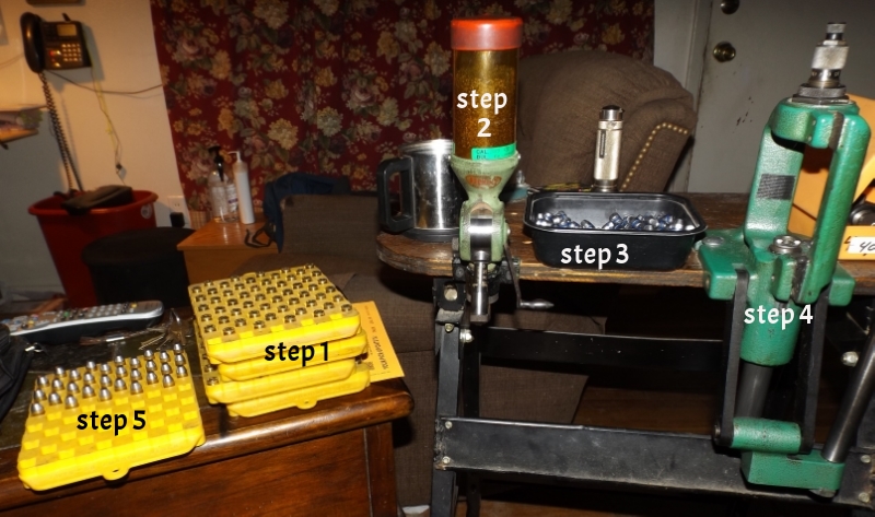

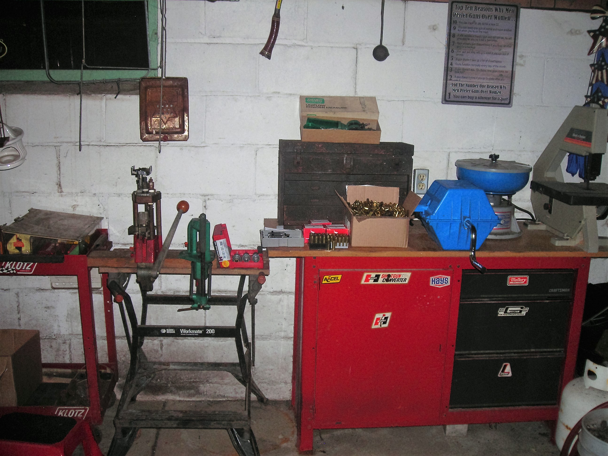

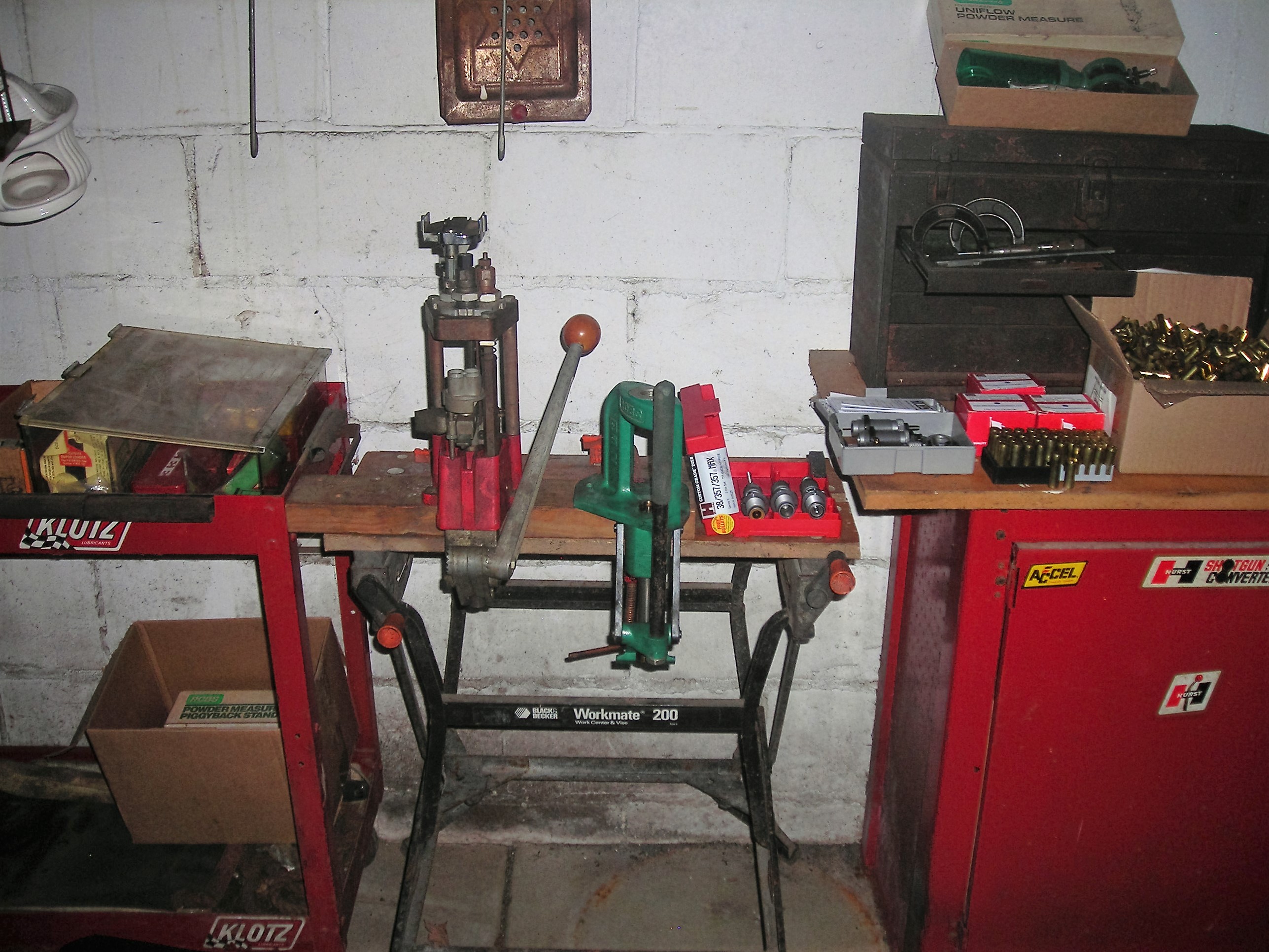

Now on the ammo,JEBar, I am finally ready to start reloading. My pardner Mike got the press off his bro after bro had gotten div. and moved back w/elderly mother. Just found THEM and got 'em here yesterday !! All I need now is primers, powder and lead. will be using 180gn for 357 Max !!
Recommended to prevent flame cutting the top strap. And 158gn for 38 & 357 Mag. Then there's the Henry 44 and DW 445, both 240gn .429, got lots O brass, but need more 357 Max. I think I can use same powder in all.
Funny thing about those Jamison rounds, I saw Midway's Muzzle vel. also, check this out, same ammo and I saw it elsewhere too. 1825fps
https://www.cheaperthandirt.com/product ... e=&from=fn
I needed brass anyhow and the only other places I know of, is Reeds or Black Dog for live ammo for 357 max or 445 SM, Both around 2.00rd !!
Here's my loading cave :D Oh and the LEE press had 9MM dies in it !!

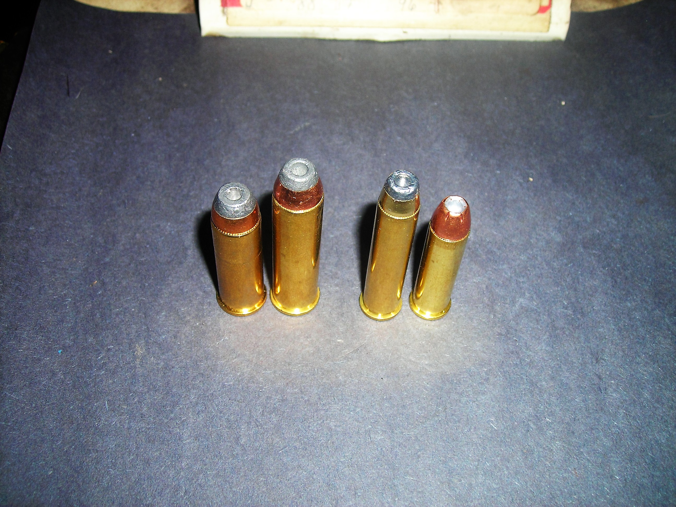

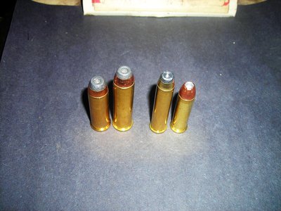

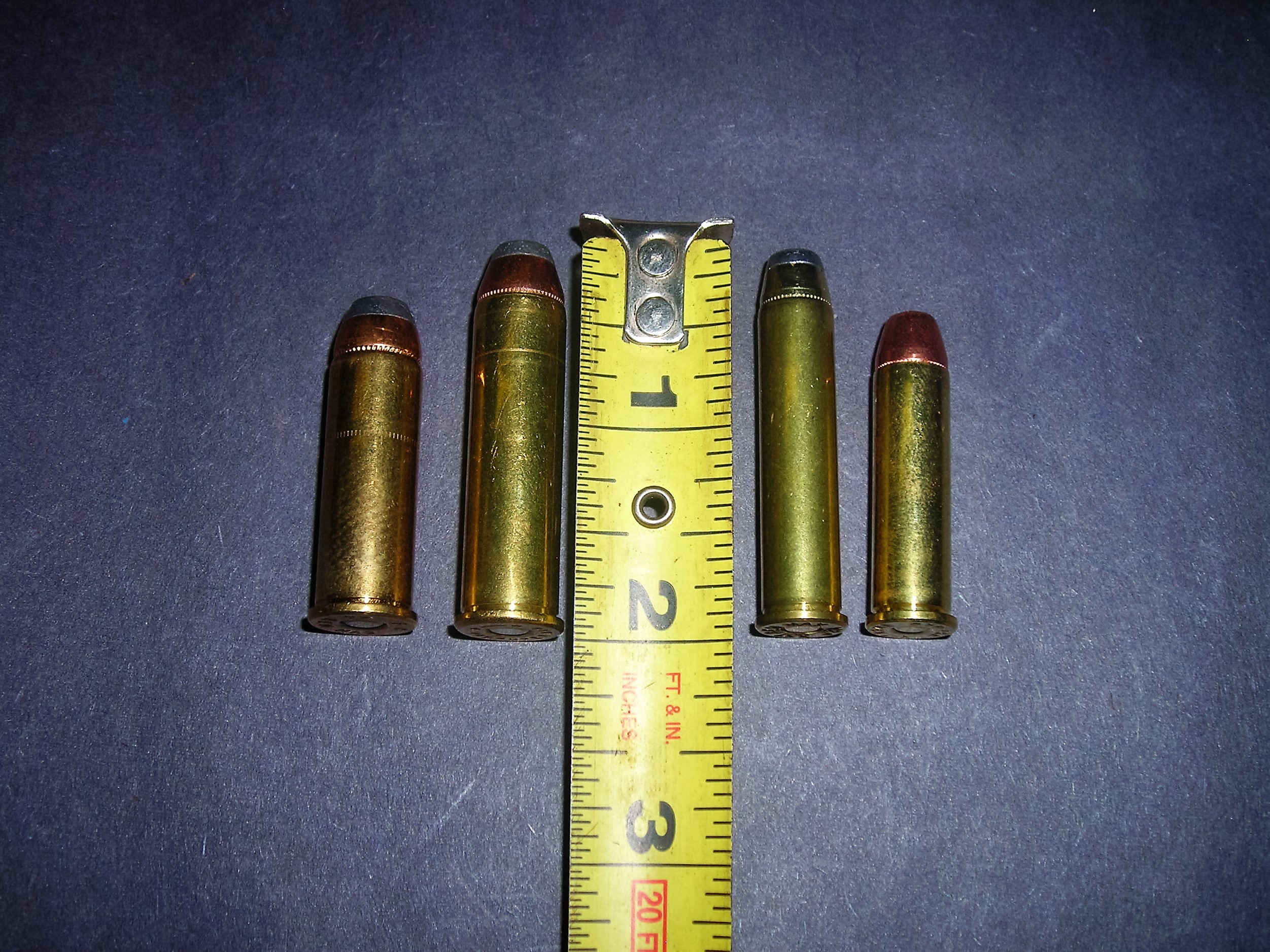

Now I'll do my best to splain Super Mags in short. DW made them [Elgin T. Gates, mainly] to compete in IHMSA shooting at 100 and 200 meters.
They needed a handgun round w/enough power at those ranges to knock down metallic targets. So E.T.G. came up with a stretched out case for more powder and a larger frame/cylinder to accept the longer round. Cases are 1.610" in .357, .375, .414 and .445. .375 ammo very $$$ and brass hard to get,the rest are a Magnum case lengthened to 1.610". Last week a ETG marked SS 414 sold on GB for $6335.00 :shock: and another is over $3000.00 now !!
Here's a pic of 357 Mag & Max and 44 Mag & 445 SM rounds [not every trip to the range type of guns, just FUN]
