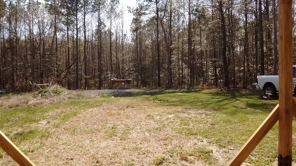

Dirt or sand will work well. I built a box 3ft x 4ft x 16 inch and filled with sand as a test at my range. Nothing we shot at it penetrated up to .308 rifle.
Then I built a 11x10x 6 foot tall enclosure and filled it with 22 tons of sand...basically a contained sand pile with of course an open front.
Works very well as a berm keeping rounds from traveling thru my woods.
Will be adding another berm next to it at some point.

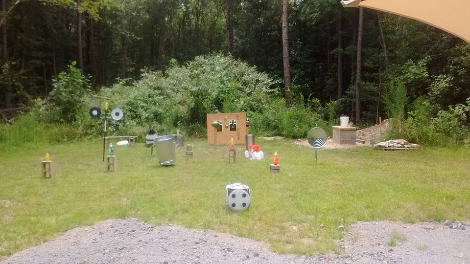

Here is another target area on my range that was a large pile of timber from clearing the area and is grown up with weeds.
I like to use that area for shotgun targets or close in steel targets. That old sand box I mentioned before is behind the target board with the two paper targets. And don't shoot the white bucket to the right....hand pump for well under it! :lol:
