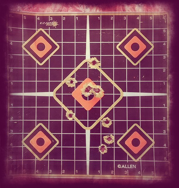

Had the range to myself as usual, temperature about 22F today. Not much wind and was tempted to do some longer distance shooting with my Frontier percussion rifle, but I am trying to figure out the sights and have struggled a little. Fixed rear buckhorn sight and blade front sight. I have read that many file down the front sight, and I can see that may be the way to go.
Shot today at 25 yds only, 50 gn of Triple 7, .015 patch and .490 lead ball. Shooting from 1 knee. Once I got the elevation figured out, the last 3 went straight to the middle. 1st three were the low ones on the right. The bullseyes were with the front sight almost as high as the horns on the buckhorn rear sight. So some filing to do, but the good news is once I get it dialed in, this rifle is deadly.
I shot all of these without doing anything in between shots other than the odd dry patch. 9 shots total. Got home, cleaned, scrubbed and lubed with Ballistol. Checked down the barrel with a high power light, and it is shiny all the way to the little patent breech reflecting back at me. Pulled the nipple and cleaned it out too, blowing air through the flash hole. Pretty happy with the results today.

not surprised at all that you are getting it figured out .... nice target .... if/when you file the front site, go slow .... as you well know, cutting it down is one thing .... going to far and trying to add some back is a whole different matter .. ;)

Nice "tuning" target RR! How many rounds thru it now?
Re: Frontier .50 Dec 14th, pre-1840...
Post by RanchRoper » Mon Dec 14, 2020 10:04 pm
9 today... maybe 20 or so?
