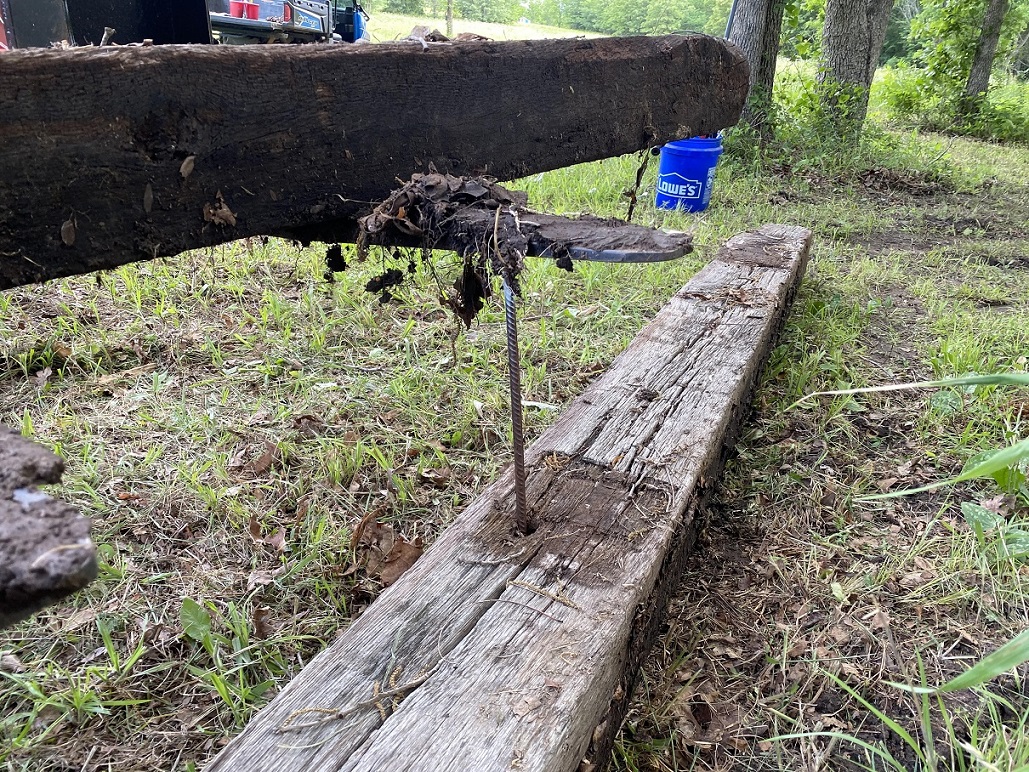

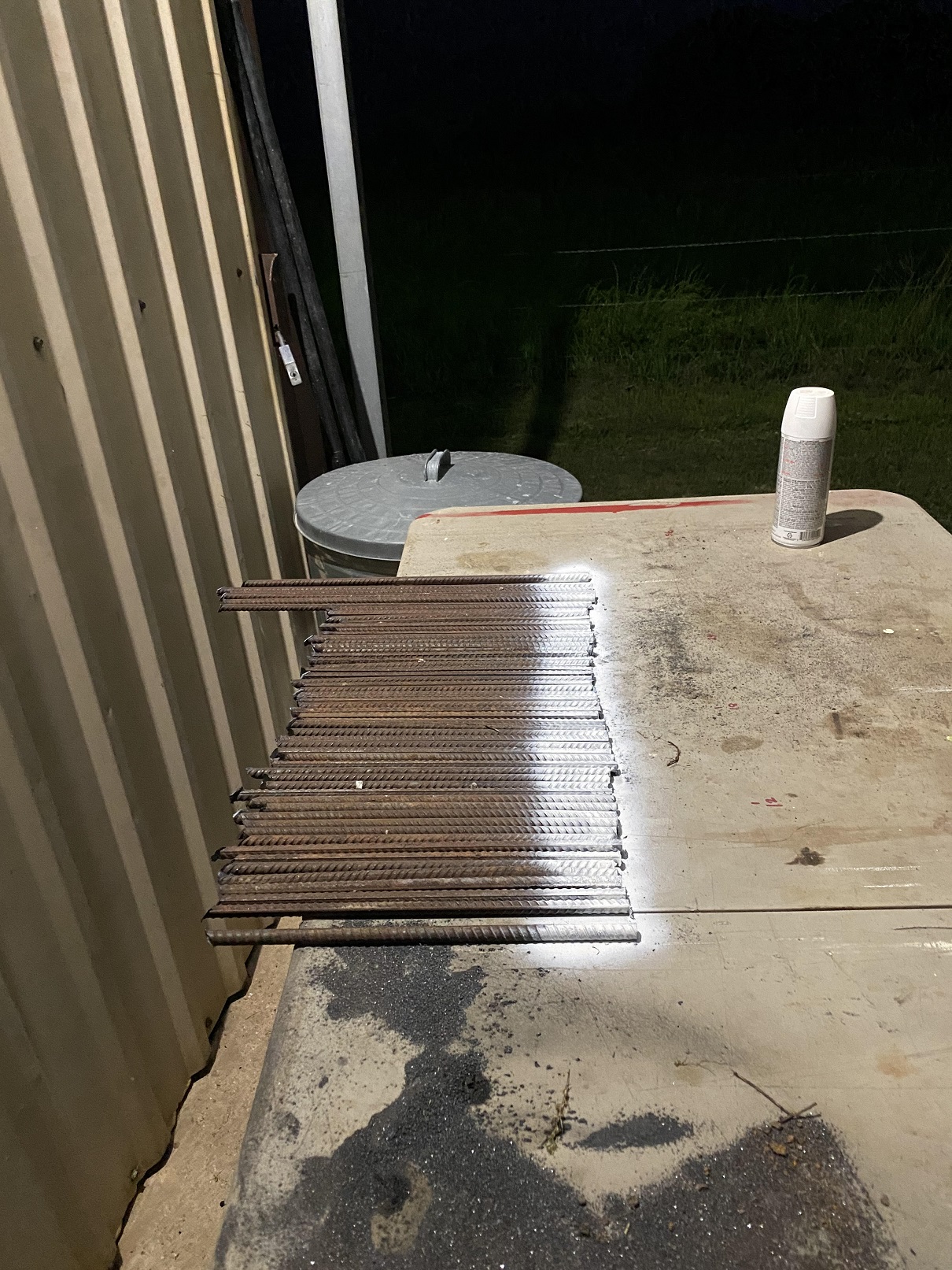

I cut the spikes at 36" squared, then cut them at 18" at a 45 degree angle to make them easier to drive in. Left some at 24" to anchor the base ties to the ground so they wouldn't slide or twist.
I pre-drilled holes thru the Ties with a 1/2 drive hammer drill, and a LONG bit. Then used the forks to drive the spike in.

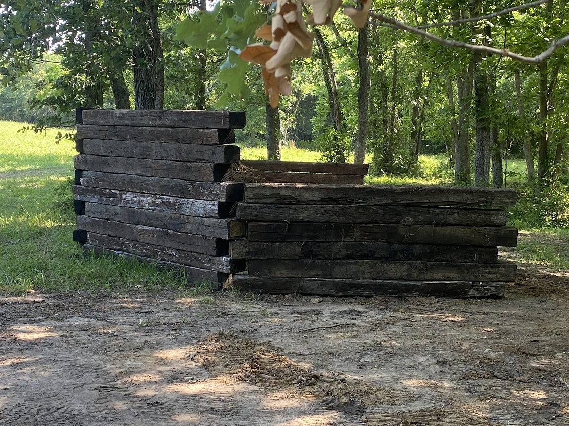

As I said, I had the legs on either side overlap the back of the wall, shifting the wall Ties left and right to interlock. As you can see here, it's like stacking lincoln logs as a kid.

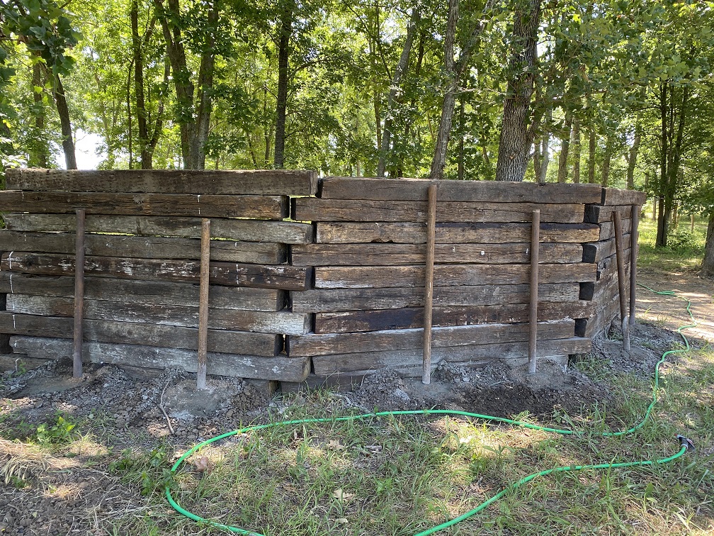

These are the posts in the back to support the extra weight / pressure of the dirt inside the U shape.

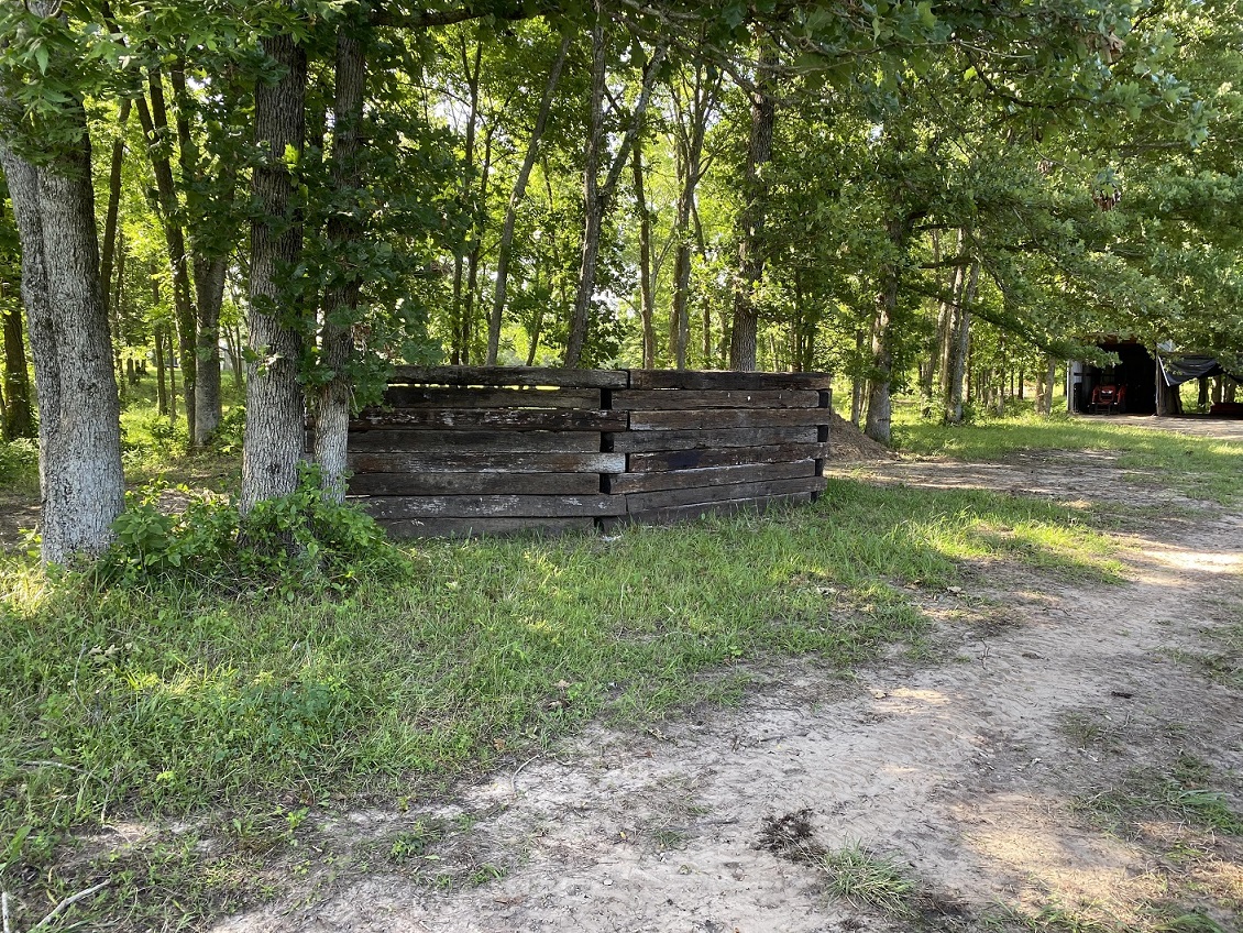

Toward the end, I had reached the end of the reach of the lift for the tractor, so we used some of the leftover ties to extend the legs of the U on either side, making them longer.
I will continue to add more dirt to the range until it settles in well. It will eventually pack down hard. Every now and then I'll have to add dirt to the front of the berm to fill in where the rounds impact. "Range Maintenance." But... it's nice to have a place to shoot here on the farm. The shaded range gives me up to 90 yards. Here is a view from 75 yards....

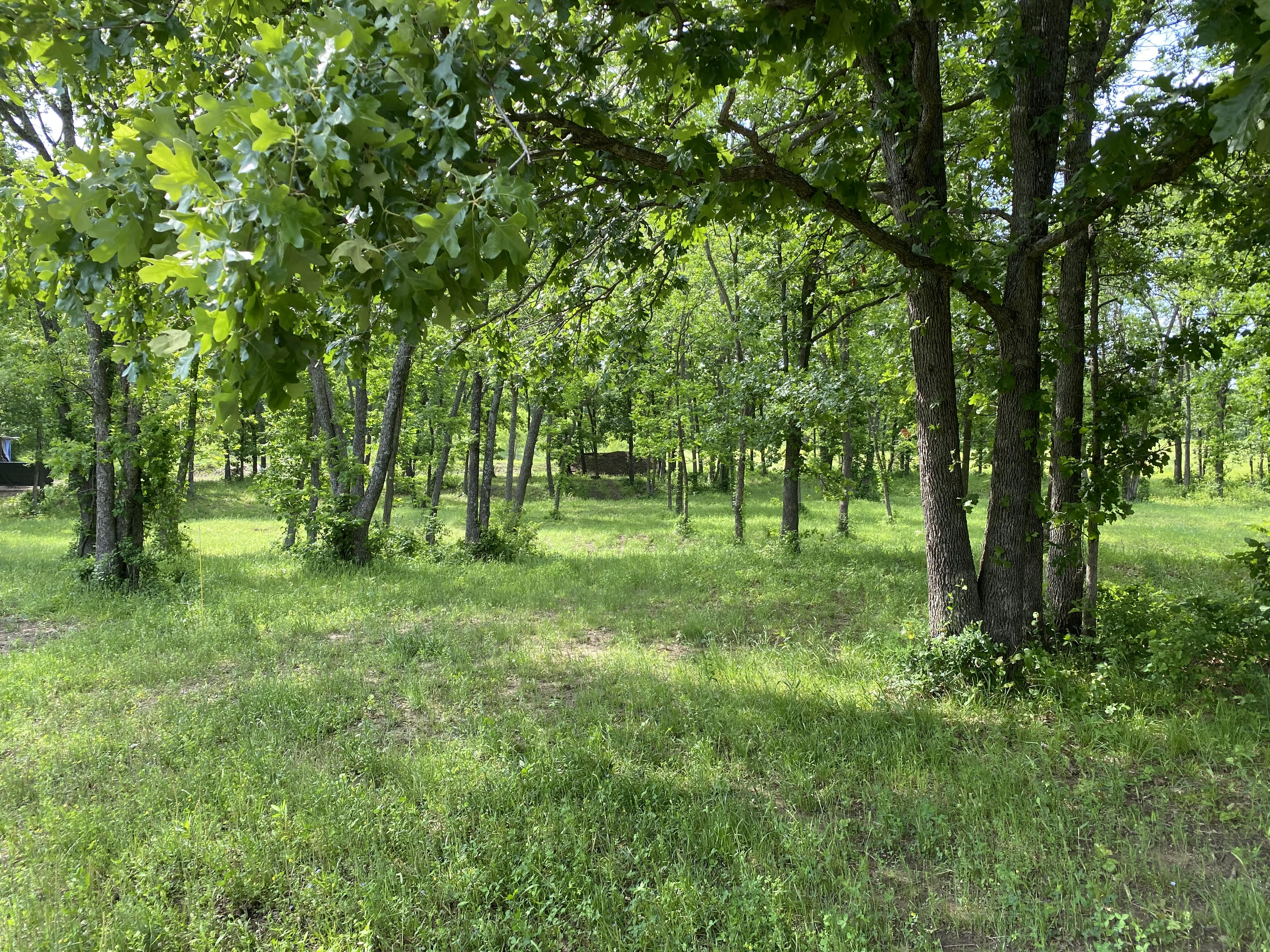

Most of my shooting will likely be at seven and fifteen yards for draw and fire.
Twenty Five yards or so for "Target" shooting with the handguns and some rifle.
Fifty for the larger calibers...

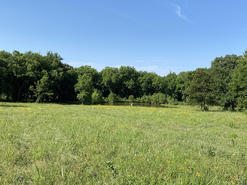

I may test the Varmint stuff at 75 and 90 just to KNOW where they hit, but most of the shooting on the farm, due to the layout will be in the 50 yard range.
I think the longest shot I could safely take would be from the North pasture down toward the pond dam.

Thanks for taking the time to repost your pictures, it’s exactly what I was seeking. A couple of questions, did you drive the 18” rebar thru two ties and then into a third or thru one tie into a second? When you predrilled the holes I suspect that the top tie was drilled and the tie under it not drilled in order to anchor the top tie? I’m thinking with the 18” length you drilled thru two ties (7” each) and four inches of the rebar then driven into the tie below.
From BOM below.
My ties were about 9" thick, and covered in old creosote and years of dirt and gravel. Some weren't completely flat. Hence the gaps you see in the pictures.
I used an old machete to literally cut away layers of dirt and gravel where I could. A half inch hammer drill with a side handle was used to drill thru them. I drilled thru BOTH and the hole was the same size as the rebar. I wasn't worried about "nailing" the ties together, but pinning them so they couldn't slide or move. The weight of the ties kept them down.
