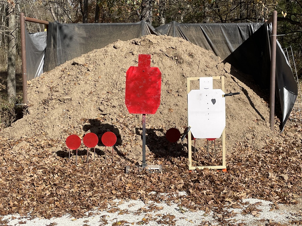

The pistol range setup I originally conceived hasn't worked as well as we had hoped. We used some steel L shaped corner posts for pipe fencing, popular in Texas and Oklahoma, and reinforced the spaces with Cattle Panels and then heavy Tarp thinking that would hold back the dirt long enough for it to take a set. I had orginally planned to put layers of tires in place to add to the stability, but didn't get a chance to pick up a trailer load before we started moving dirt, and then forgot. :roll: Short memory. As you can see in the pic below, after a year or so, the settling dirt pushed thru the sides and back of the weak idea I had to retain the dirt berm and I knew I was going to have to come up with another plan. :shock:

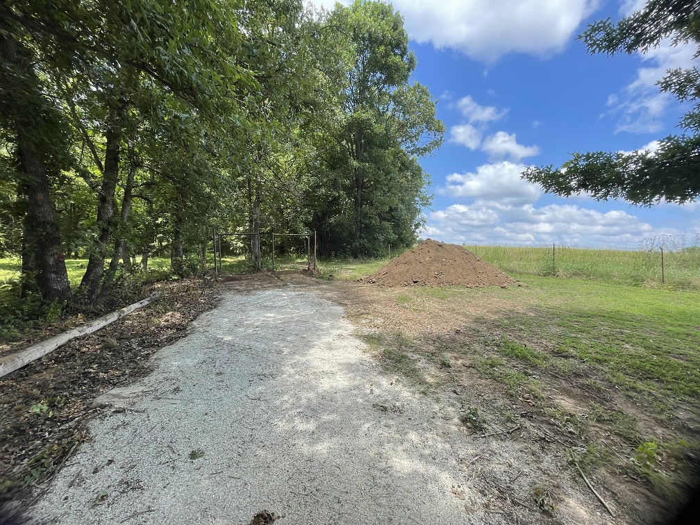

Over the last week, I have moved the dirt, panels, and tarps. The dirt I piled close by so it will be quick to move BACK inside the frame when the new project is done. The scraps of tarp and the panels went to the dumpster.
02 Dirt moved.jpeg (485.17 KiB) Viewed 58 times
The frame is now cleared and standing ready to receive the cut sections of phone pole, stacked across the back and sides like lincoln logs. They will be secured to the poles by rope until the dirt goes in, then it will hold them against the poles. Every other layer will have a section of rebar inserted into the top of the pole, and bent around the frame. More to come as the project moves forward. MY potions are done from the seat of the tractor... work smarter
