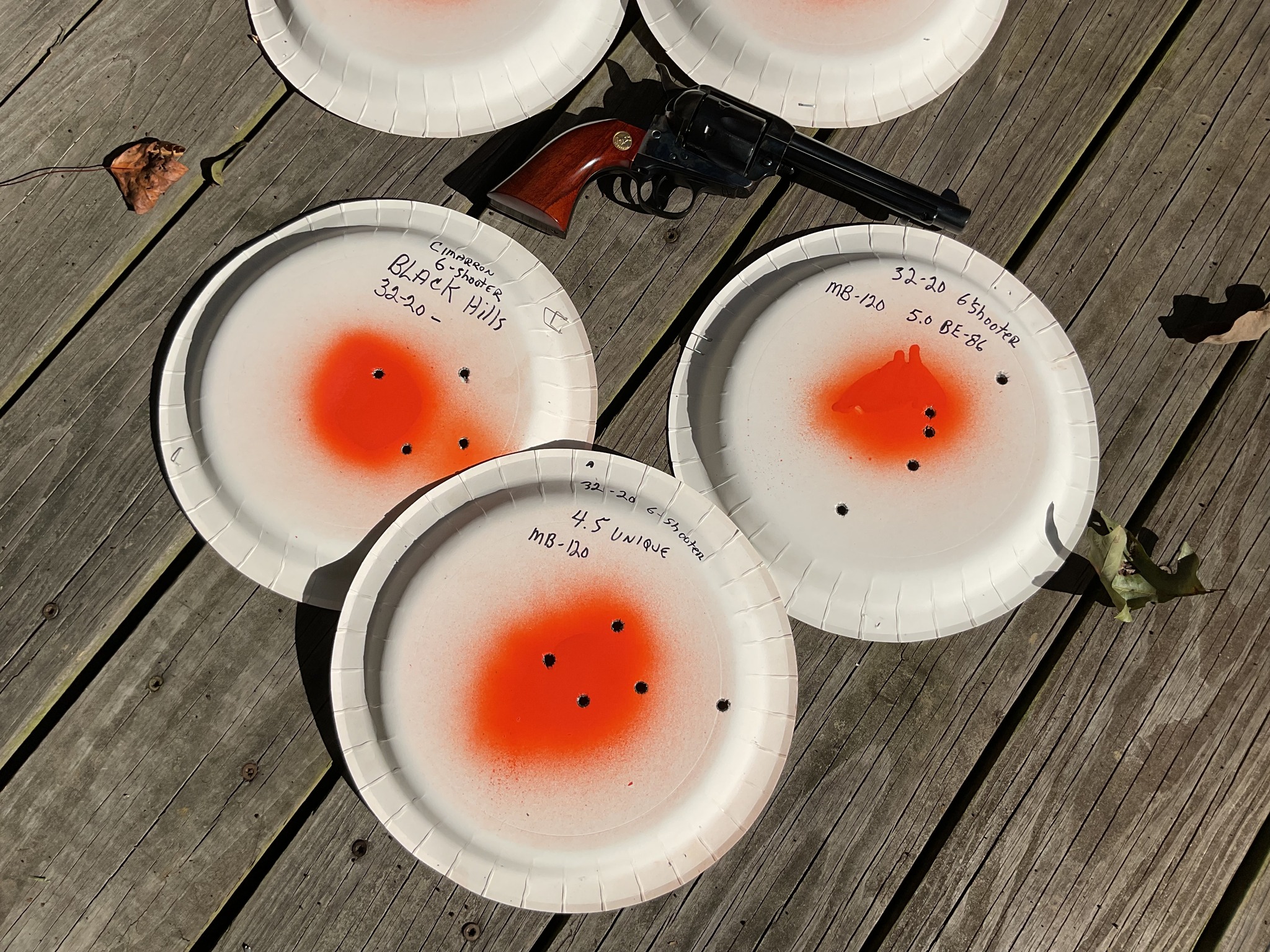

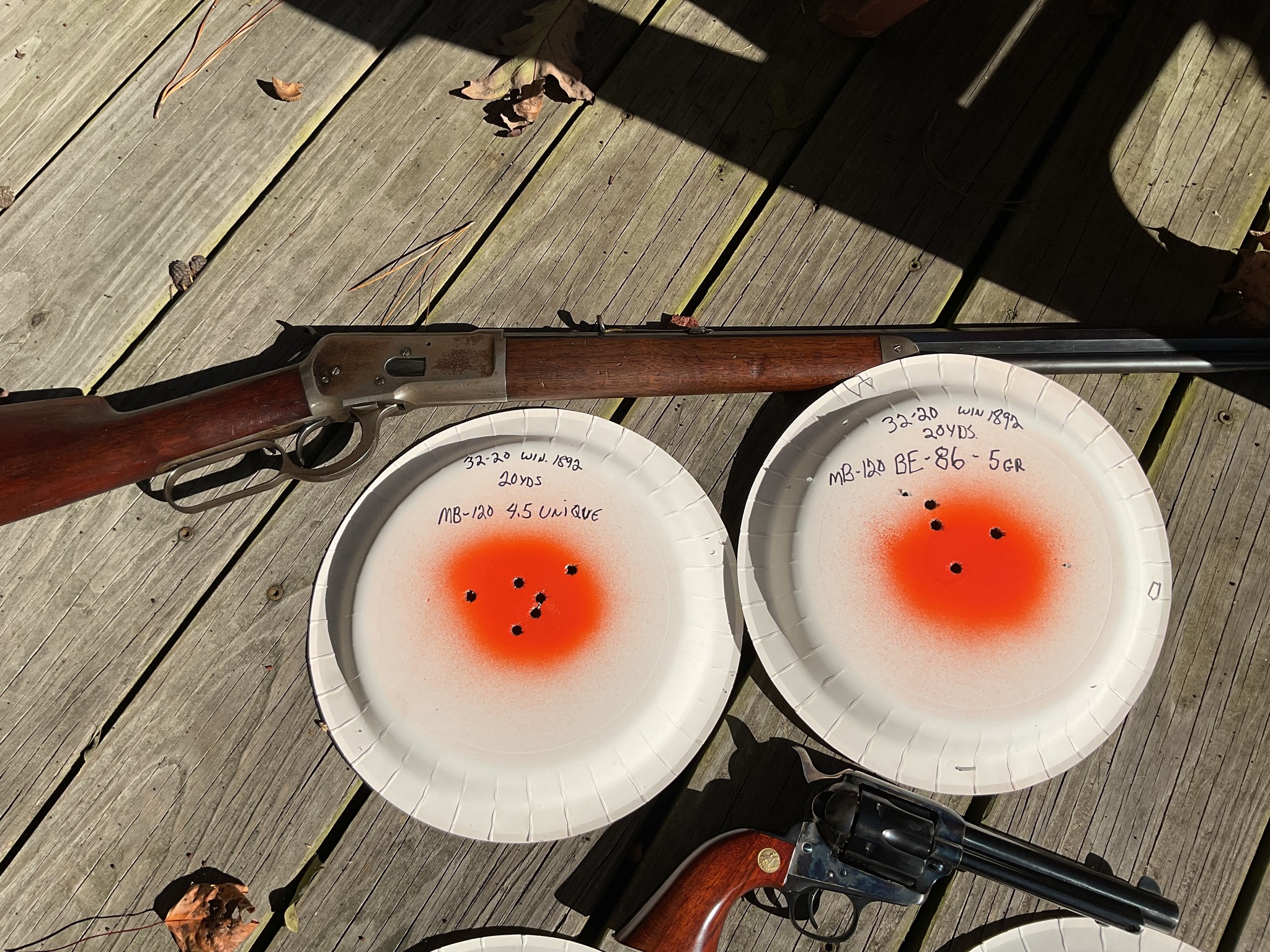

I tried for an hour to post up a range ammo test of my 32-20 loads and it never sticks again. Maybe the pictures are not loading right but it's the same way I have done it.

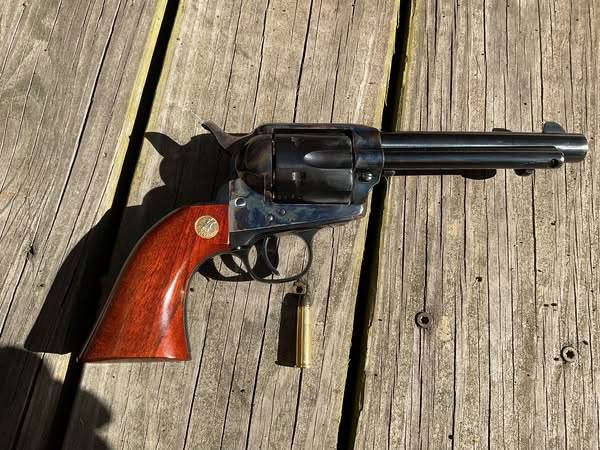

Unique at 4.5 gr. with the 120 gr. Missouri bullet look like the best for the Winchester 1892 and the new Cimarron Model P six shooter.
BE-86 at 5 gr. was a wider group but had about 100 FPS more speed.
Cimarron Model P 32-20.jpg (72.22 KiB) Viewed 1702 times
Unique again tightened it up a bit.jpg (1006.8 KiB) Viewed 1702 times
Unique groups better but BE-86 gives a bit more speed   1270-1300 FPS  Unique  and 1380-1416 FPS with BE 86.jpg
Unique groups better but BE-86 gives a bit more speed 1270-1300 FPS Unique and 1380-1416 FPS with BE 86.jpg (1.03 MiB) Viewed 1702 times

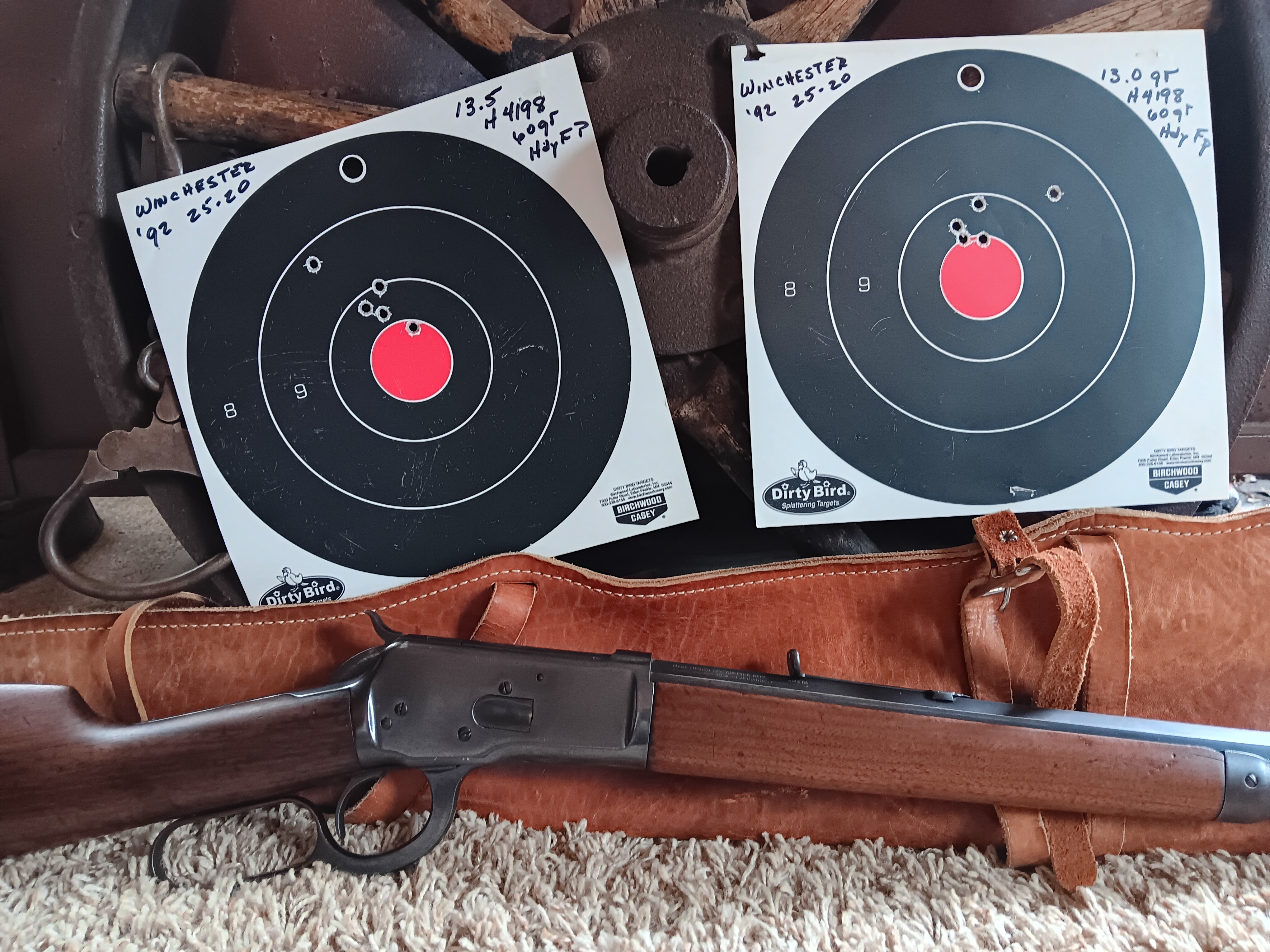

Might try some 4198 if you have any, it's worked well in the little 25-20 of mine.
A couple of 50 yd targets.
Re: 32-20 load tests using Unique and BE-86
Post by fortyshooter » Sun Oct 05, 2025 10:02 pm
That is a nice load!
