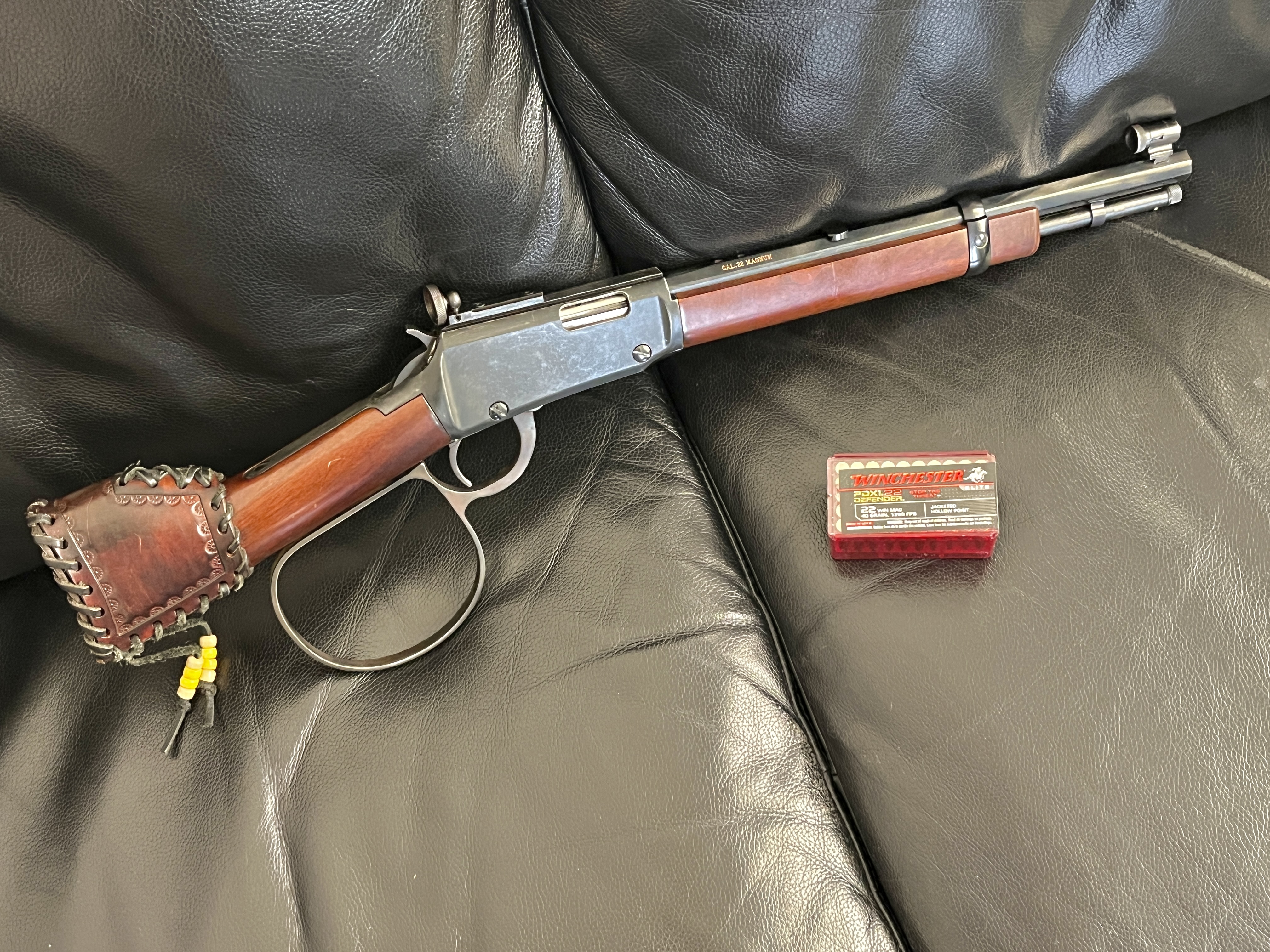

I haven’t shot this octagon mare’s leg in at least a year. That changed this morning when I shot offhand into bullet traps at 25 yards. It took me three shots to get on target and then I didn’t miss. Ten minutes of shooting and I’m ready to mow the lawn before the rain comes.
[attachment=3]IMG_4031.jpeg[/attachment]
I made it from a factory .22LR mares’s leg and a Frontier.

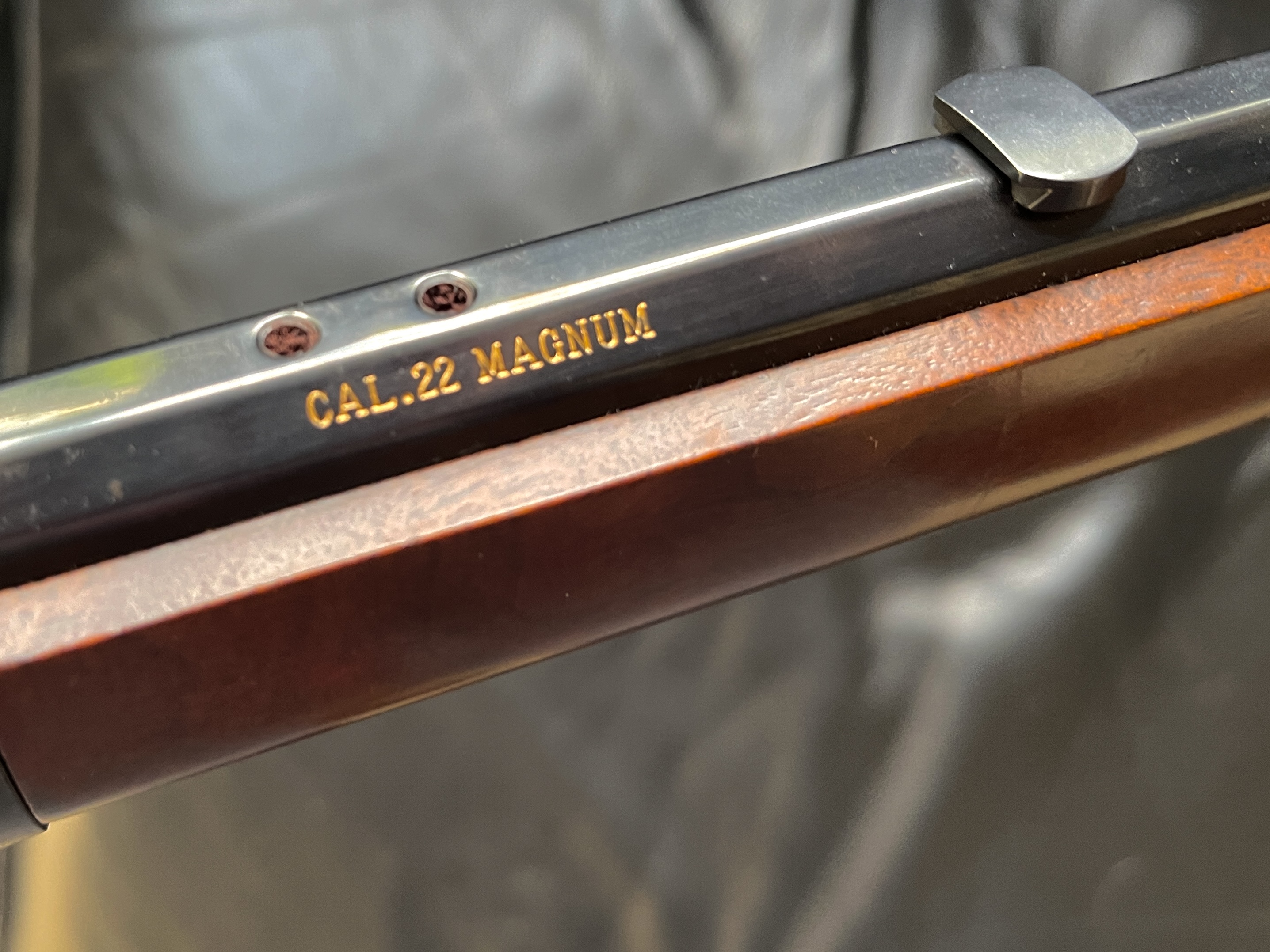

It’s the only one I know about and is in .22WMR.

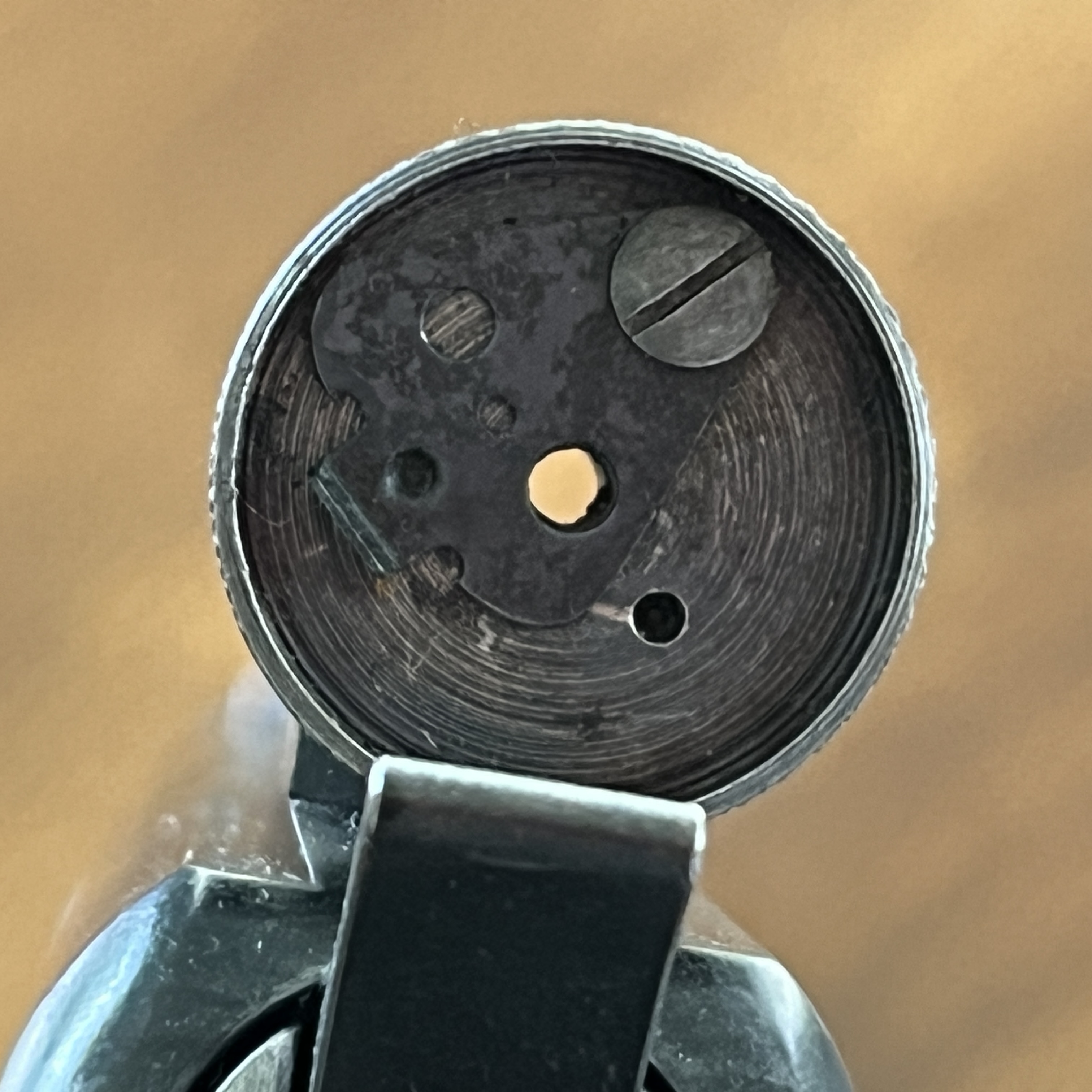

It has a receiver mounted Stevens 3-hole peep. This extended the sight radius from seven to fifteen inches.

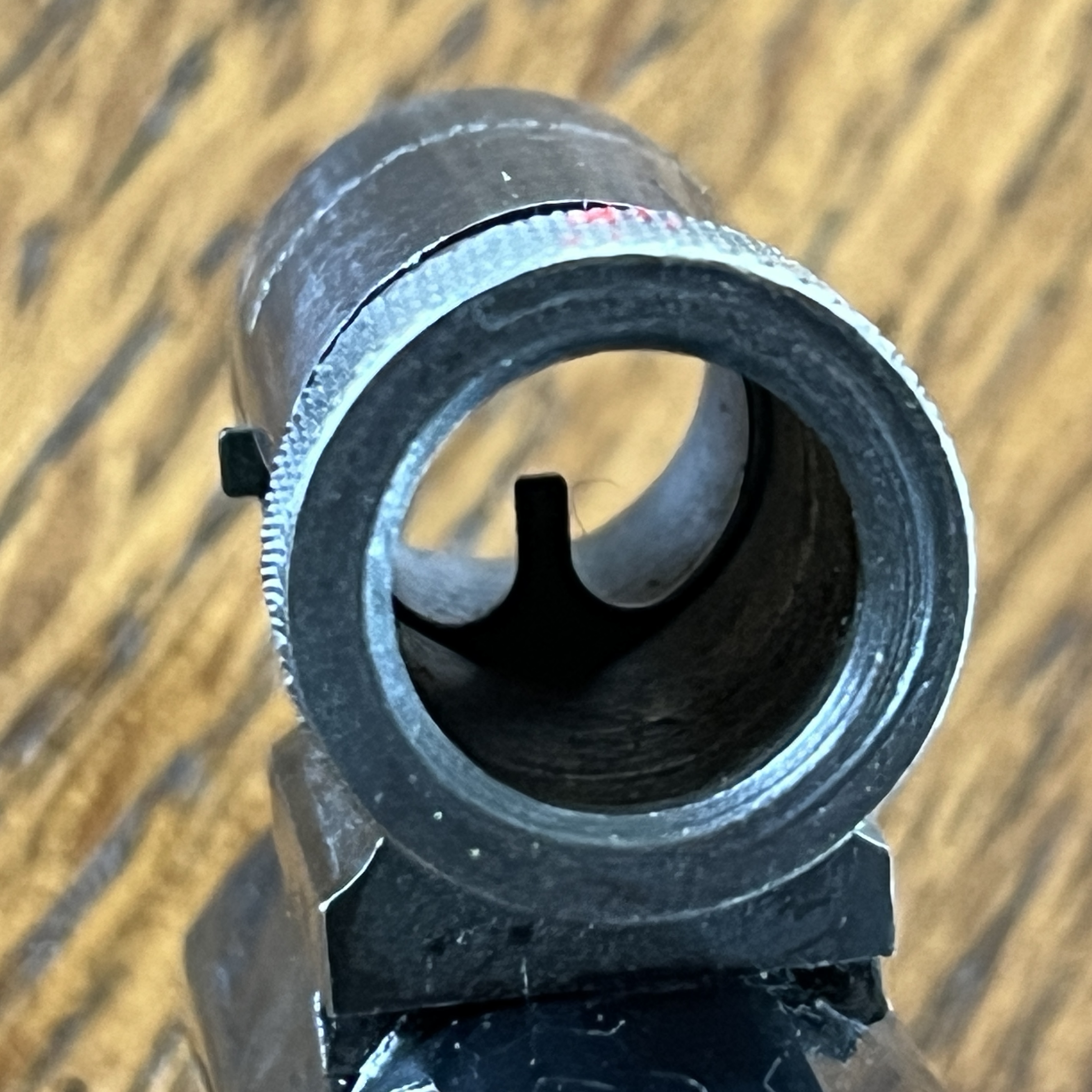

And a Marbles globe up front.

Great to see you out shooting with an old friend like that, Gene. That ML looks like a great plinking gun. You've put a lot of work into it.

That is one trick sight on that Mare's Leg Gene!
