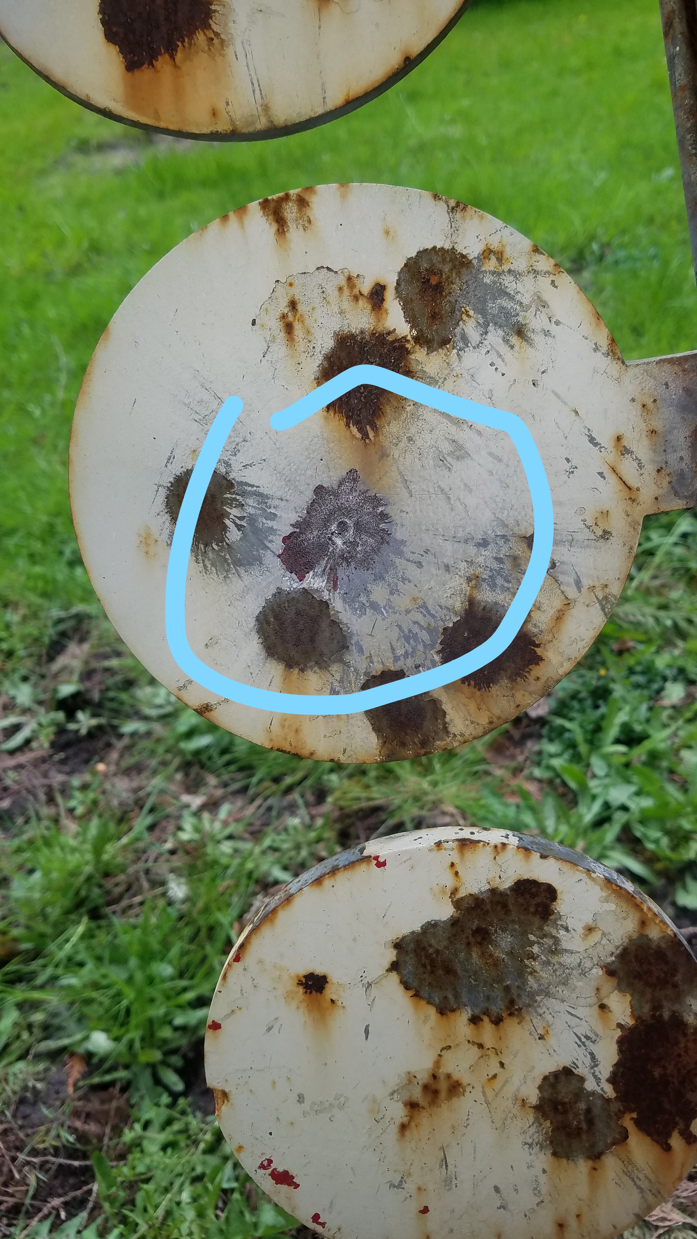

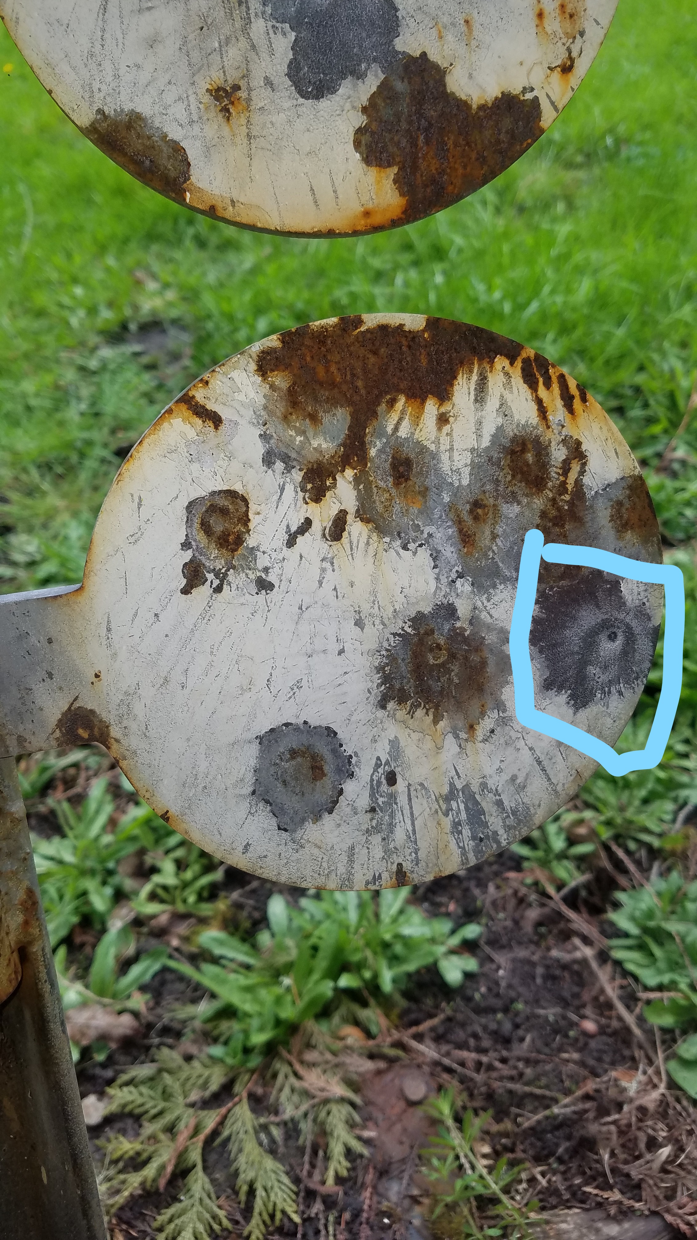

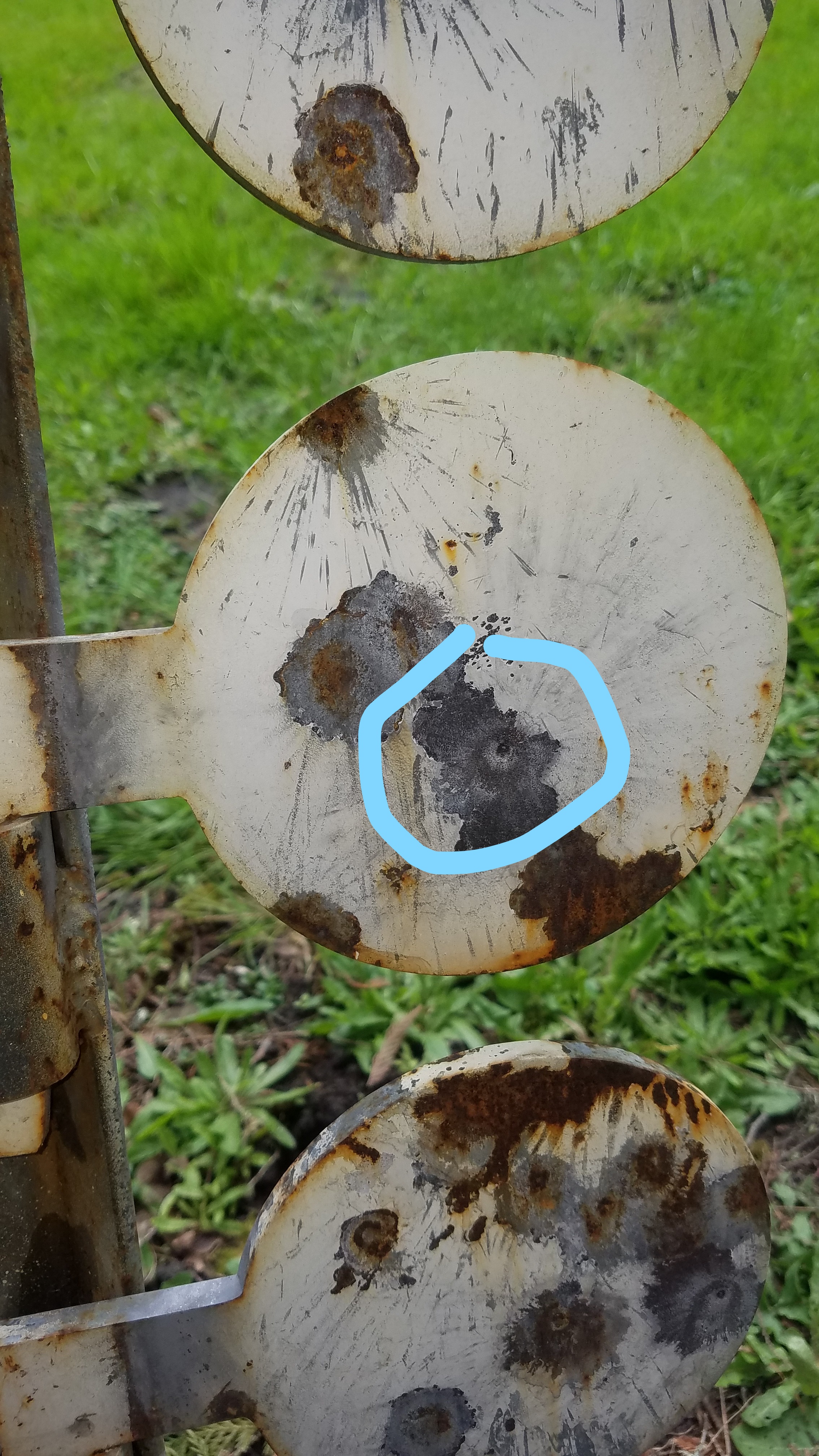

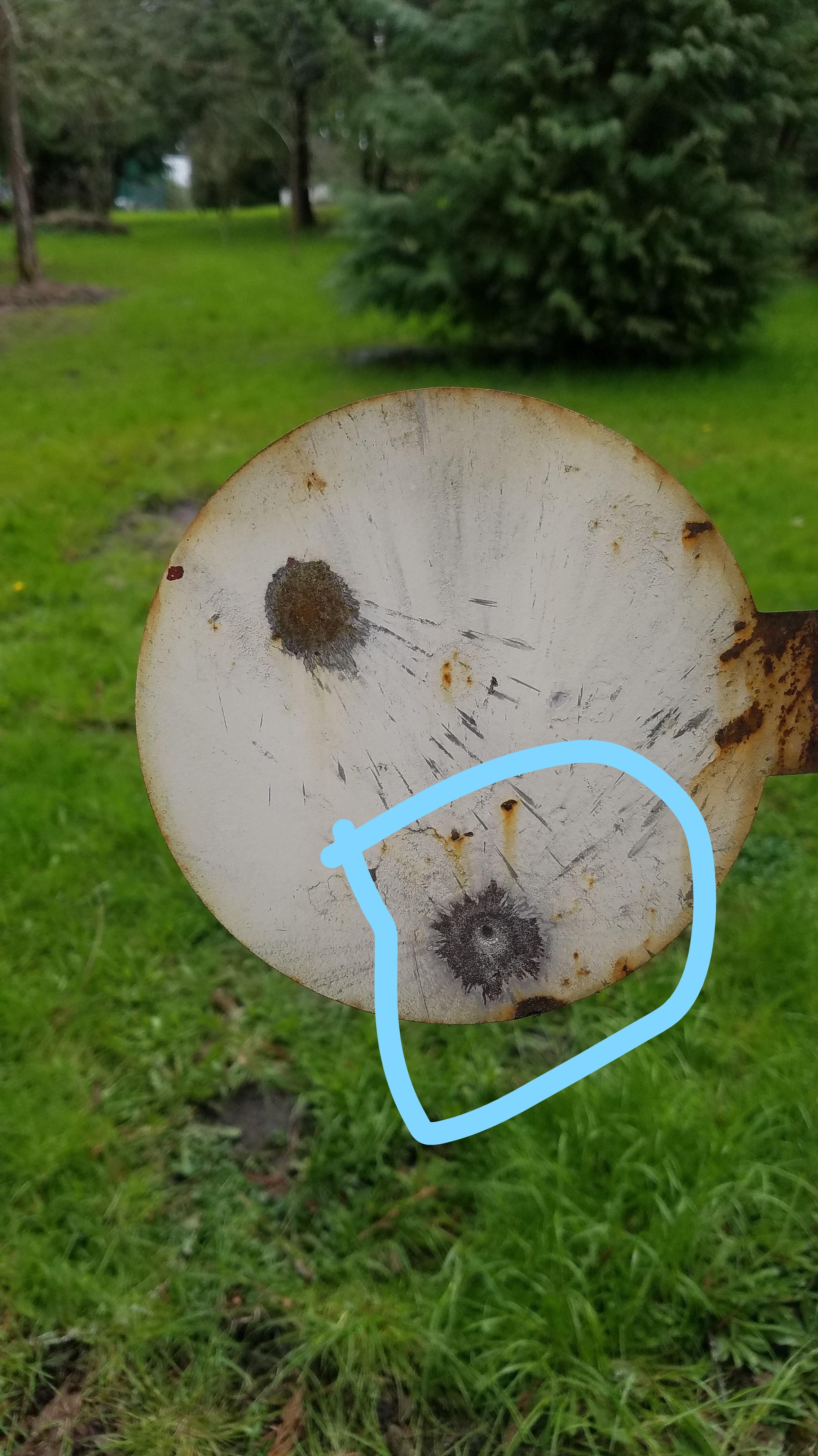

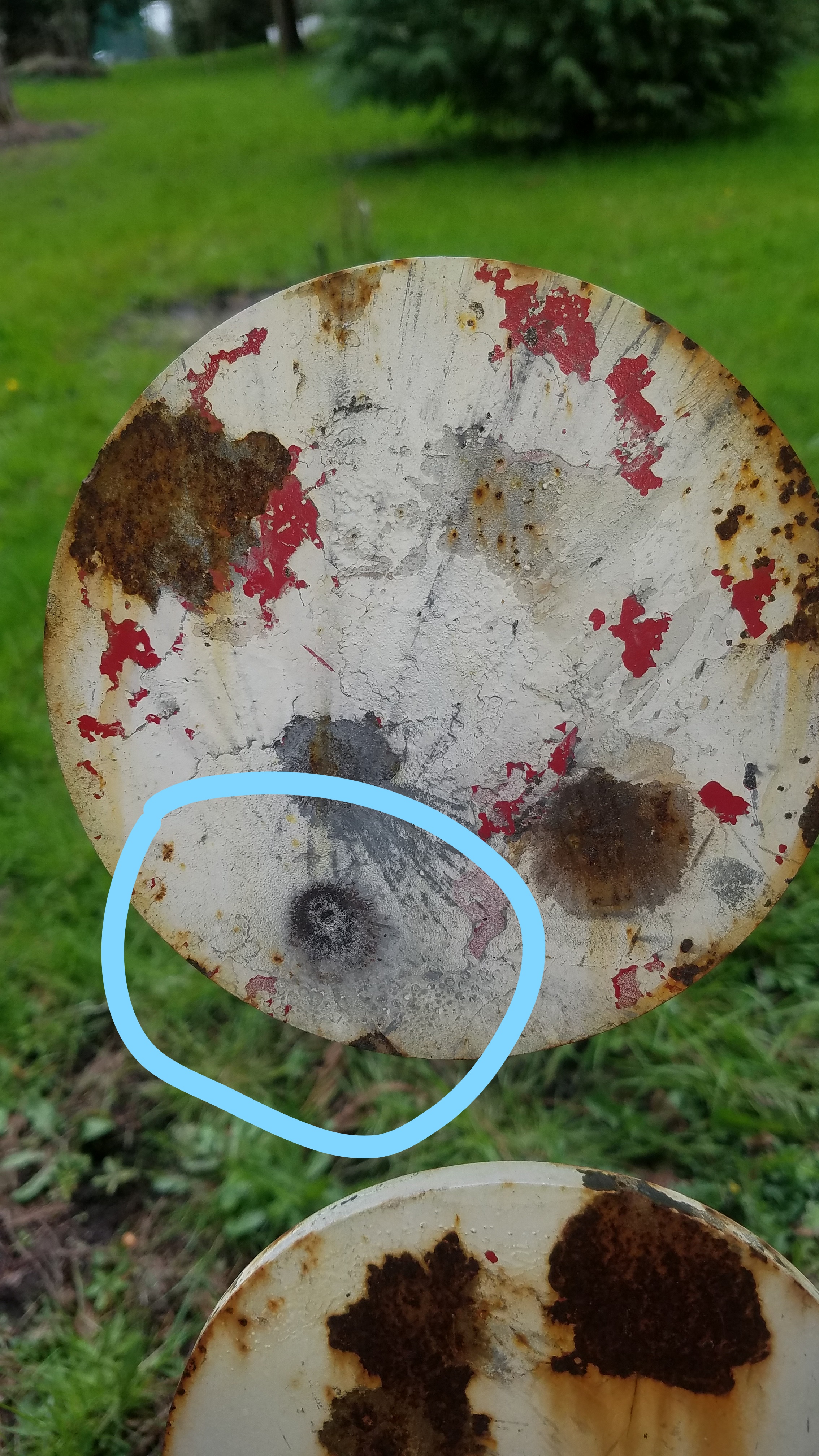

Test results firing 4 CFE223 powder test loads from about 55yds. These are quick shots using a branch in a bush as a rest. Five shots, one with a factory round to compare the 'felt' difference with the 4 CFE223 rounds. No discernible difference. Didn't repaint the 6" paddles, so circled the impacts in the pictures to make them easier to spot. Pictures are of the back side of paddles after they had flipped over. I cleaned the H009 afterwards. It was pretty dirty. I likely did not shoot enough rounds to get the barrel hot enough to test the anti-copper fouling properties of the powder. That will come later.
