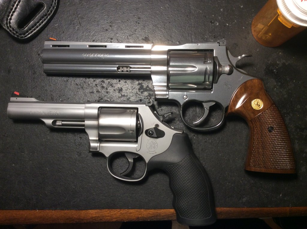

Hogdon HP-38 is readily available at my LGS and picked up a pound of it to try with light 44 Mag loads. The revolvers were the Anaconda and the smallest of 44 Mag DA revolvers the Smith&Wesson M-69. The Smith M 69 has the lightest SA and DA action pull of any of my 44 revolvers...yes including the Anaconda! It is a very handy piece to carry and with mild 44 Mag or 44 Special loads is a treat to shoot and it shoots well. Note size difference to
Anaconda!

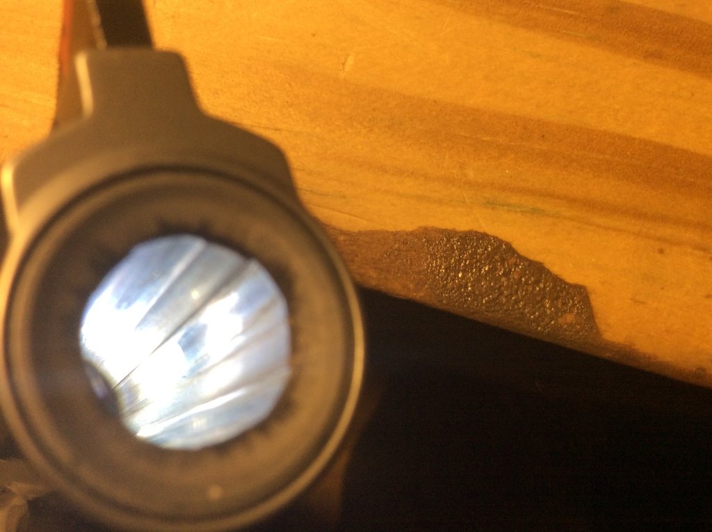

Another thing is the lead I get after shooting the Hi Tech coated lead MB bullets thru the Anaconda. Tried the 200 gr 12 Bhn and 240 gr. semi wad cutter 18 Bhn bullets. Usually 3 or so clean out shots of an FMJ bullet will clean the bore up like on my M-69 but the lead still sticks to the Anaconda outside rifling grooves which is the bore size after 6 FMJ clean out shots! Don't like having to scrub the lead out and this after 15 shots of MB bullets.
Picture shows bore after firing clean out FMJ rounds....not good. I will clean it out and then slug the bore and check the bore size. The inside bullet grooves came out clean but not outside shooting the XTP .430 diameter bullet.

You never know how a revolver will shoot until it is in your hands. For the money I was expecting a trigger at least as light as an off the shelf Smith and Wesson and am disappointed in the Anaconda on that issue. I get light leading with the Smith M-69 and none from my other 44 revolvers shooting same loads here. The Anaconda cylinder throats measure right on for a .430 bullet at .431 so maybe a bore issue?

And I really do hate a revolver that has a leading problem. It does sound like a bore issue on the Colt. I've had a couple of Ruger 44 mags that had a constriction in the bore which caused leading, but also screwed up accuracy. It's not uncommon with Rugers. Just run a tight patch down the bore and check if it hangs up a bit at a certain spot. If it's just a rough bore, a polishing job might be all it needs.

Have you slugged the barrel on the Colt? My old model Trooper shoots best with no leading using cast bullets sized .356 so maybe the Colt 44 is bored a little tight.
