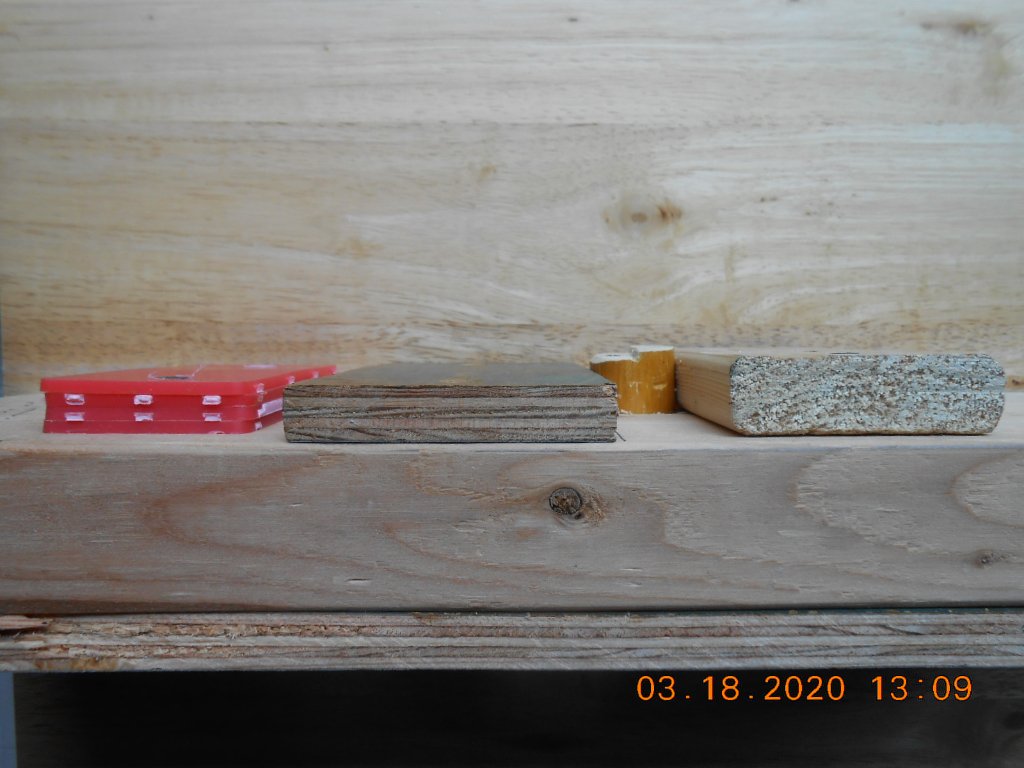

I chatted with a good friend who has many shop skills and good collection of tools. Similar to my earlier project of the wood re-loading stand I built for my Trapper pistol, he brought over some tools I don't have and we made a "barrel pin tool" out of scrap wood, a dowel rod, and plastic construction shims. He came up with a creative design where the pistol is held on either side of the barrel pin by only metal, and the spacing keeps the wood away from any contact with pressure points of pounding. It took very forceful blows on the barrel pin to get it loose and out. Now I have the barrel pin tool for any future dis-assembly and re-assembly. Not much different than my wood reloading stand... plain-Jane design and unfinished wood, but works pretty well.
