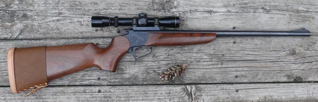

I'd go for door number 3. I've done that very thing with aftermarket leather lace up pads and filling the space in a crescent buttplate with foam. Looks good and no alteration to the gun needed. I also use these leather slip on pads on some of my contender carbines to increase the stock LOP, since I'm not too comfortable being that close to the scope these little carbines.
