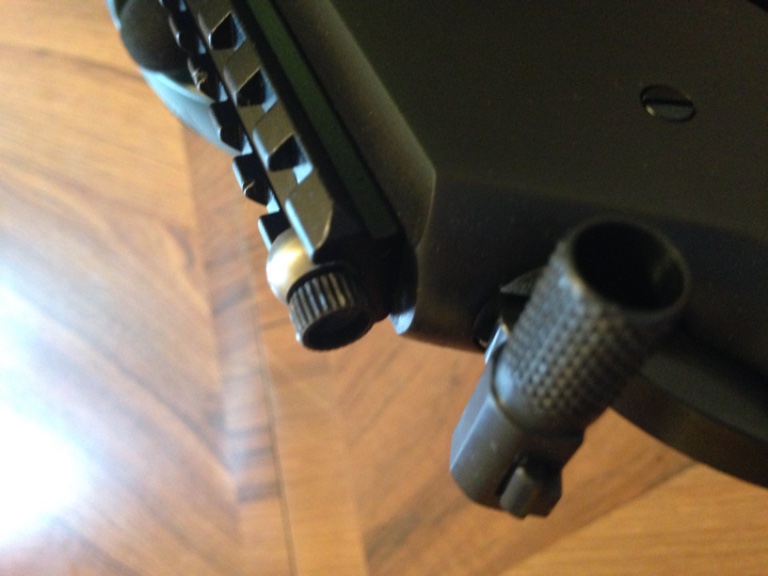

Hey Marvin! I am having trouble posting my discussion on this subject. I too, wanted the option of rail mounted optics, or peep sight.
I installed an 83B rail, Werner I believe. This made scope and red dot optics readily useable. QD attachment is handy.
To make it easily convertible to iron sights, skinner peep, I installed a Skinner Low Pro peep as the rearmost rail mounting screw.
It took some 'fitting', but was not difficult.
With the right scope rings, it was even useable looking under the scope through the rings.
I'm not sure if this helps, let me know if I can describe it better.

I have the Henry .30-30 in brass. I bought this mount (63B) for it. Look into putting it with Cofisher's Skinner Low Pro peep implementation.

Mags, will that rail you linked work on a Henry BB steel receiver? Thanks.

I don't know the hole spacing on the BBS receiver.
But this is the hole spacing of that mount I got from Amazon.
Hammers Marlin Rifle Scope Rail Mount https://www.amazon.com/gp/product/B01D2 ... UTF8&psc=1
o-------o---------------------o-------o-------o-------o
|_0.5_|_____1.85______|_0.5_ |_0.4_|_0.5_ |
Please let me know what the spacing is on your BBS. I've been curious for a while what spacing the BB-RSM mount has.

The steel receiver requires one modification. Using your diagram, starting at the left, the first two holes align at the rear of the receiver. The third hole ALMOST aligns with the forward receiver hole. I had to file a little to get the screw to line up correctly.
This is a steel carbine 357. I am not sure of the larger caliber spacing.

The spacing is 2.9" front to very rear hole. Back two are 0.5" apart. The HOO6 and HO12 spacing are the same.Mags wrote: ↑Fri Oct 11, 2019 11:59 am.

Might fit if there is a little slop in the mount holes to accommodate the 0.05 difference (2.85 vs 2.9). Or as Cofisher did, file the mount hole to elongate it a little bit. Also check to see if the front edge of the mount stops short of the open sights on the rifle barrel. There is 0.8 inches from the center of the last hole to the front edge of the mount, or 1.7 inches from the hole of interest.
|____________2.85___________|_________1.7________ |
o-------o---------------------o-------o-------o-------o------------| (front edge)
|_0.5_|_____1.85______|_0.5_ |_0.4_|_0.5_ |___0.8__ |

Yeah, might just try that rail.A little tweaking will be easy enough. We shall see. Thanks Mags.
