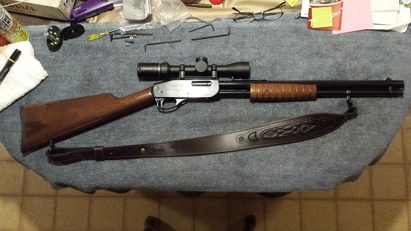

I use a Burris 2-7 X 35 Slug Gun scope on my .357. It is a nice, clean looking compact scope with great clarity.
IMI Timber Wolf .357.jpg (101.13 KiB) Viewed 4745 times
Re: Scope for 357 mag
Post by Rifletom » Sat Sep 07, 2019 3:52 pm
Nice set-up roddy. Not familiar with that Timber Wolf.
Post by roddy » Sun Sep 08, 2019 10:58 am
The Timber Wolf was produced back in the late 80s by Israel Military Industries, and imported by Springfield Armory. There were versions in .357 and .44. They have a 10 round tube magazine that is loaded from the bottom of the receiver like a shotgun, an adjustable stock, and a built in scope mount. They're well built, lightweight, easy handling, and accurate...if I could only keep 1 of my guns, this would be it.
The original intended purpose, believe it or not, was in law enforcement. Back in the 80s, a lot of coppers still carried .357 and .38 spl revolvers, and this carbine was meant as a special purpose trunk/companion rifle that would use the same rounds.
