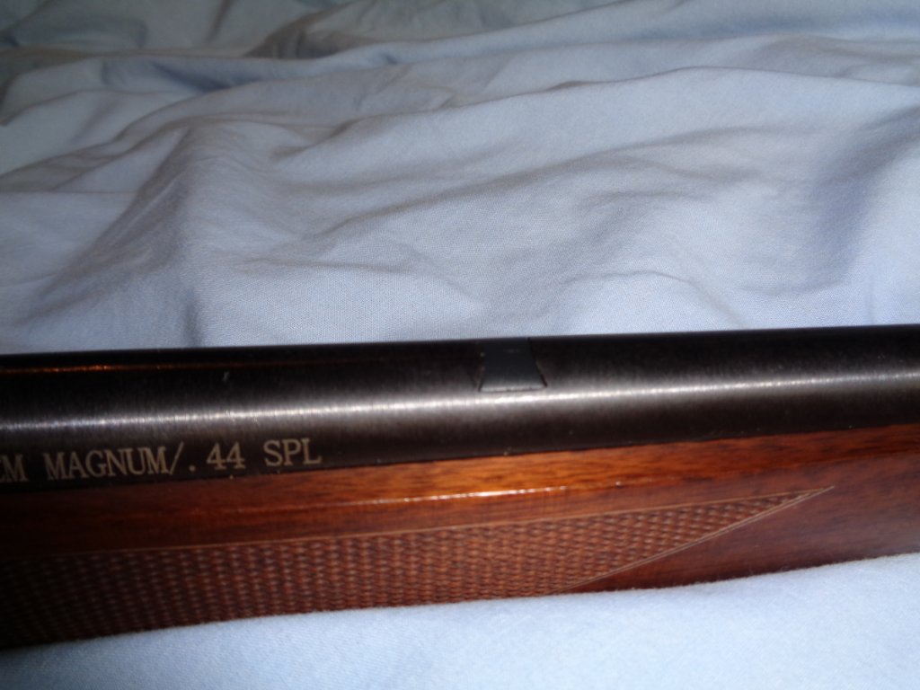

The round dovetail fillers look great on steel Big Boys, but they don't work for the octagon barrel models.

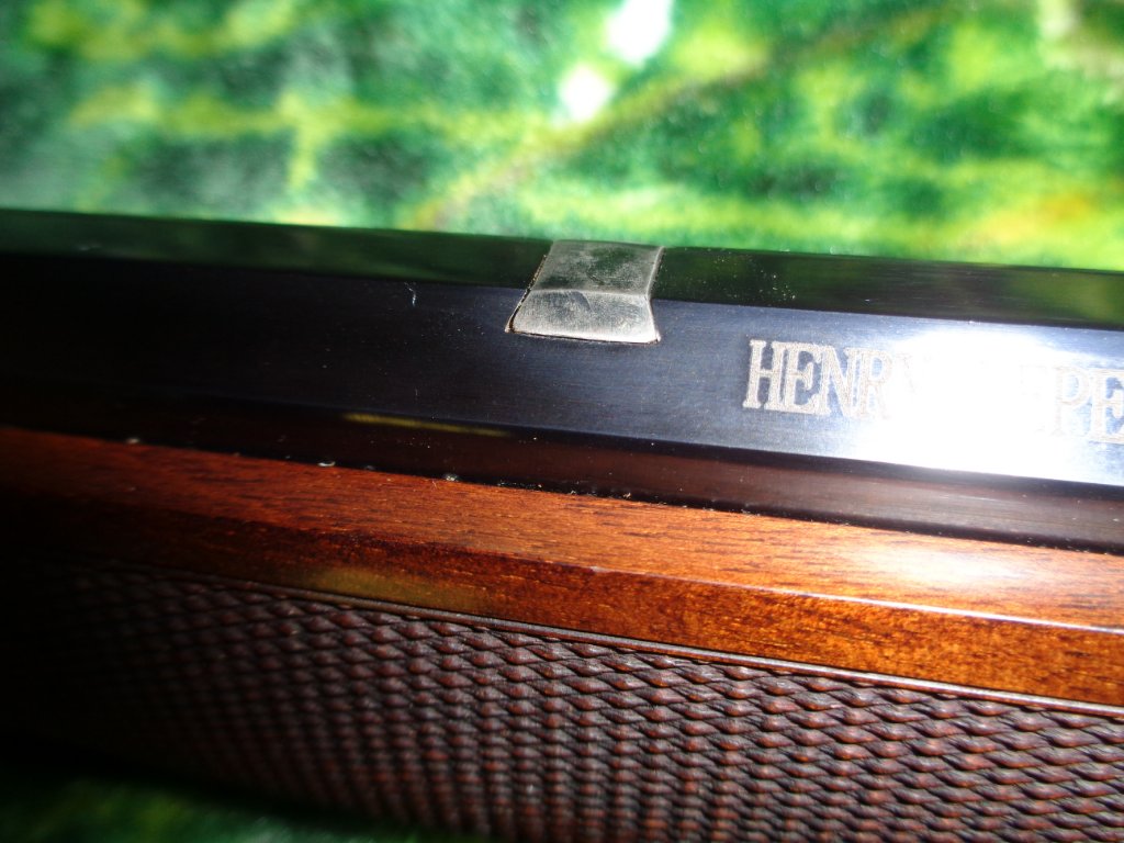

I never really liked the offerings from Marbles or Skinner, so I bought some 3/8" steel dovetail stock from Brownells and filed/ground a steel filler for an octagon barrel. I used some cold blue to try to match the barrel bluing, but it hasn't really worked - not dark enough - needs more bluing work - but I think it looks better than a standard "oversized" filler or a blank slot.

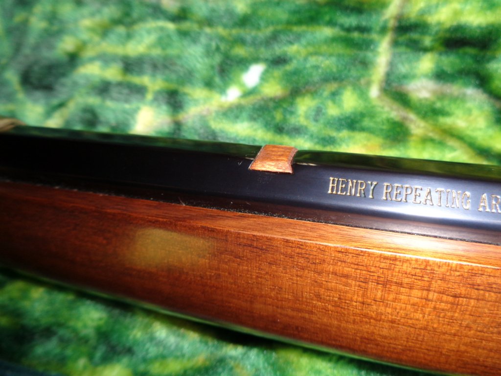

I also tried making an octagon filler out of wood and then staining it to match the stock on a Henry - it's a lot easier to make than a steel version, but I think the steel looks/performs better...

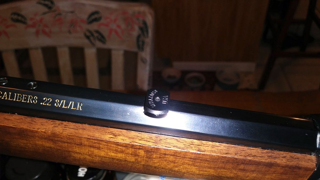

Sorry it took me so long to post this - I have no good excuse!
Anyway this is the Williams dovetail filer with set screw.
