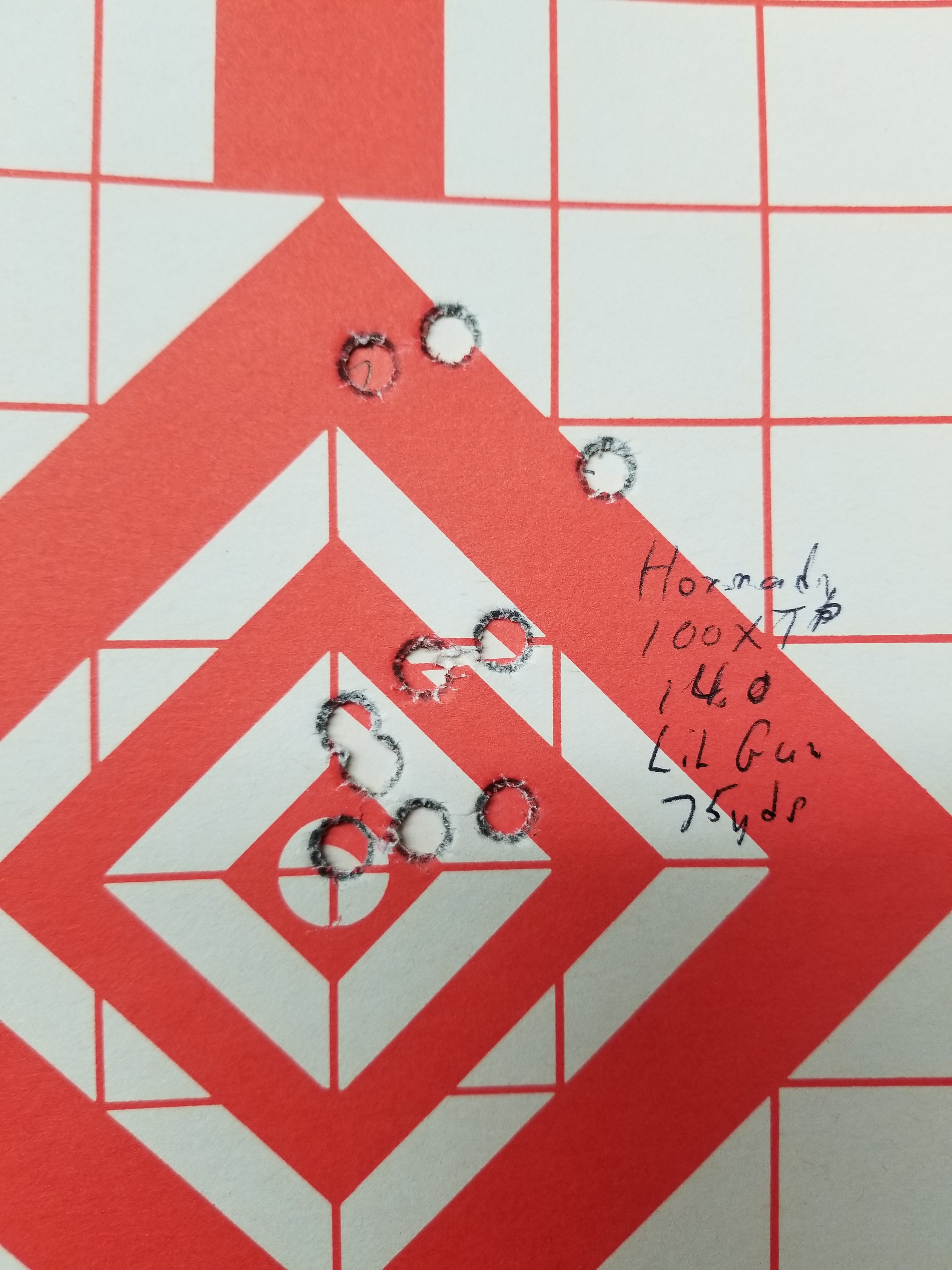

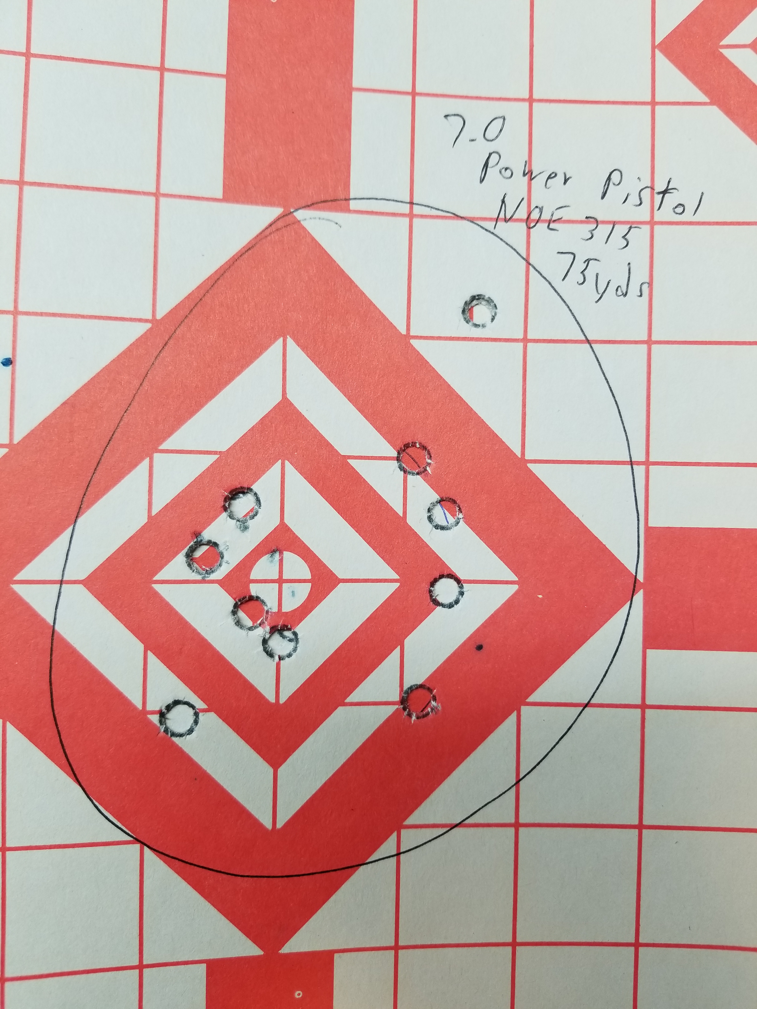

Here's a couple loads I shot while trying to find what it likes. Both were shot at 75 yards. The first one was shot with an NOE 315118 cast bullet sized .313. I had similar results with a Lyman 311316 and 10 grains of 2400. I've only tried a few jacketed bullets. I really wanted to find a good shooting cast load so I haven't tried any other jacketed loads. These were shot before I added the Skinner sight with a 6 power scope.

rigger wrote:Here's a couple loads I shot while trying to find what it likes. Both were shot at 75 yards. The first one was shot with an NOE 315118 cast bullet sized .313. I had similar results with a Lyman 311316 and 10 grains of 2400. I've only tried a few jacketed bullets. I really wanted to find a good shooting cast load so I haven't tried any other jacketed loads. These were shot before I added the Skinner sight with a 6 power scope.
Nice shooting!

It is noted that you had one and three impacts higher than the balance of the string....pls advise which ones were the high...(ie. 1st, last, etc.). If the high impacts were random, would you say it was called?
rigger
Re: Skinner Express and 327 Federal Carbine
Post by rigger » Thu Jan 25, 2018 6:44 pm
The XTP loads three highest velocity were the 7th, 8th, and 9th shots. They were 1819, 1773, and 1838. The average for the string was 1745. Extreme spread was high at 183.6. The lowest shots in the string were 1 and 4 at 1665 and 1654. They weren't called. The next highest was 3 at 1762. It hit right in with the other 7.
I'm not sure on cast load which shot was the high one.
