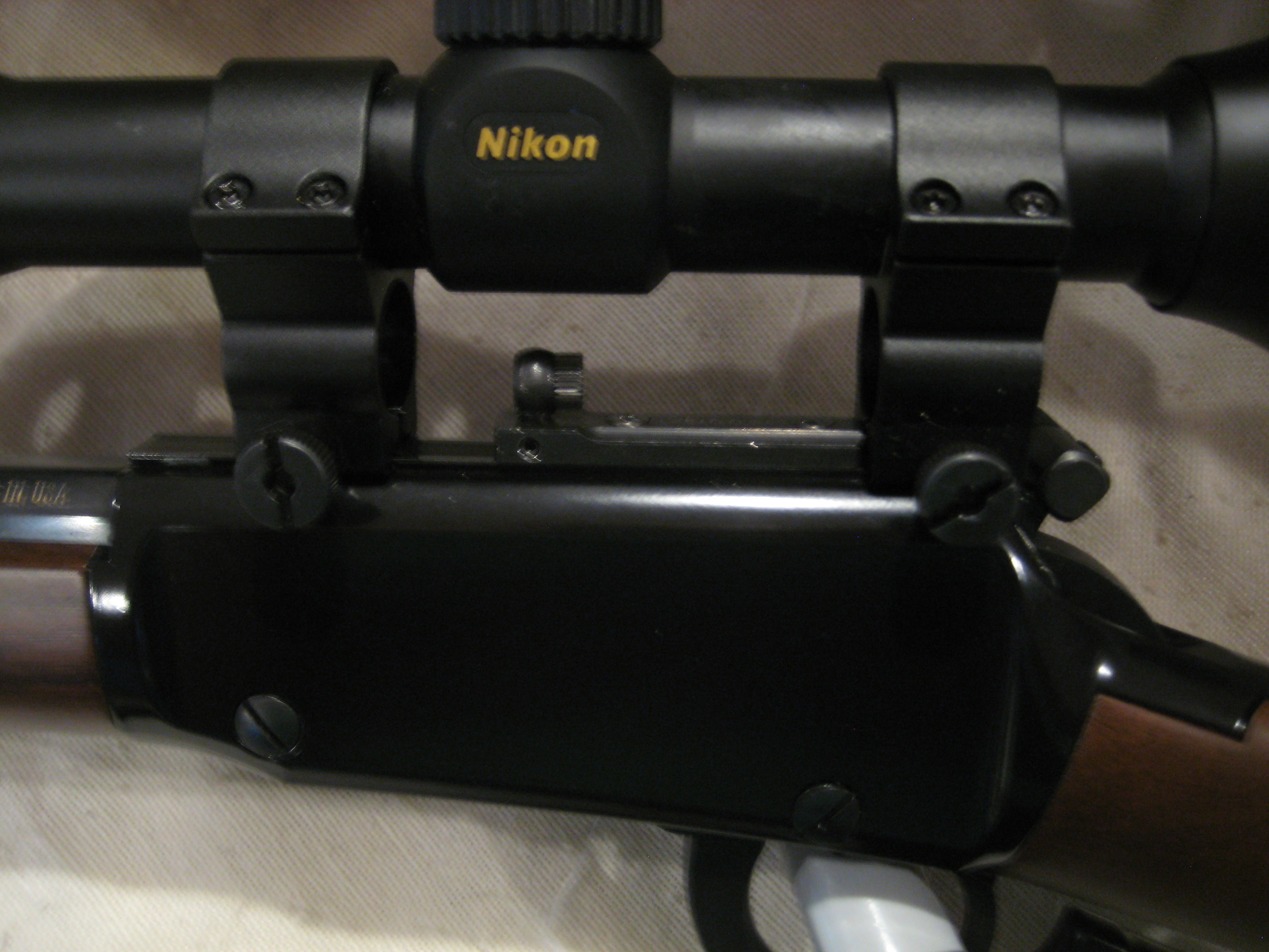

Got an SGC in 22 magnum with the Skinner receiver mounted peep. Worked pretty well at 25 yds. This weekend, at 50 yds I got a group somewhere north of 4". Just can't see well enough to shoot something small. So, I had some see thru mounts and a Nikon 4x to put on it. Mmmmm........ Not enough space in front of the Skinner, so took the Skinner off. Was thinking about moving it forward, which would require either me or a gunsmith drilling/tapping another hole. Then, the light bulb went off!!! I could turn the sight around and remount it. There would then be enough room to install the scope mounts. One in front of the Skinner and one behind it. Worked like a charm. Will have to re-sight everything this weekend.

please, if at all possible post a picture of your mod

Finally got a pic.....
