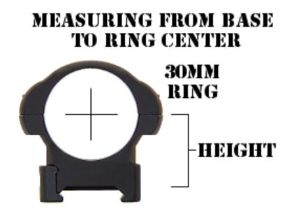

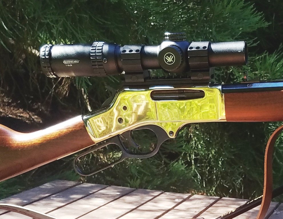

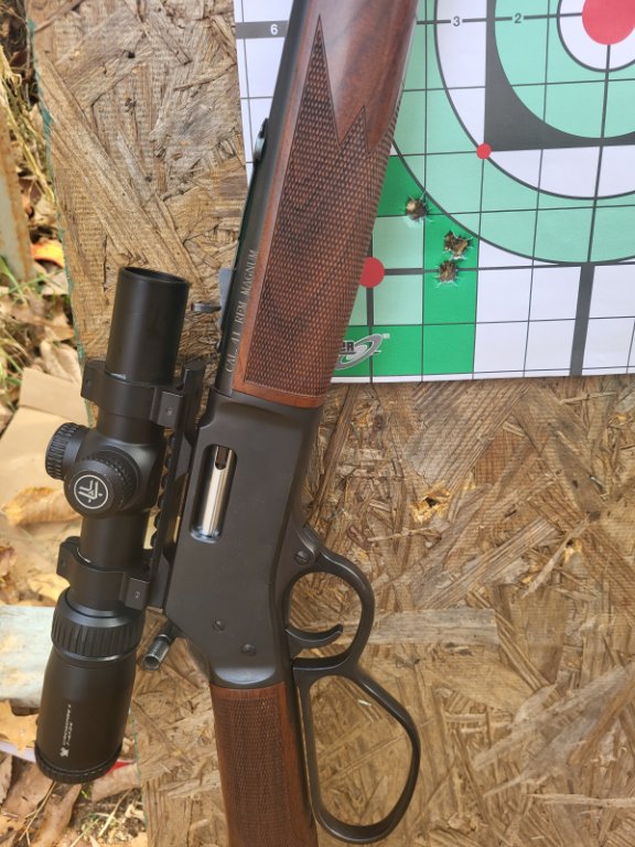

ALSO! I ordered a set of the Medium Pro Series 30mm scope rings (PR30-M). I'm concerned with these rings I may have interference with my hammer. Will these elevate the scope enough to keep it off the hammer?
Yes there is a power off setting for the reticle.
I have the Vortex Strike Eagle 1-6x24 scope with 0.97in height scope rings on my 30-30. The PR30-M rings are 1 in high rings so you should be fine with the scope being off the hammer. I recommend getting a Hammer Extender (Grovtec), though I didn't need one.
I wish I had gotten the 1-8x24 version of the scope. The 1-6x24 didn't quite cut it beyond 75yds or so.
Ring height picture Image
Rifle Image Image
