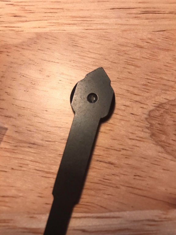

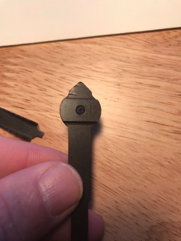

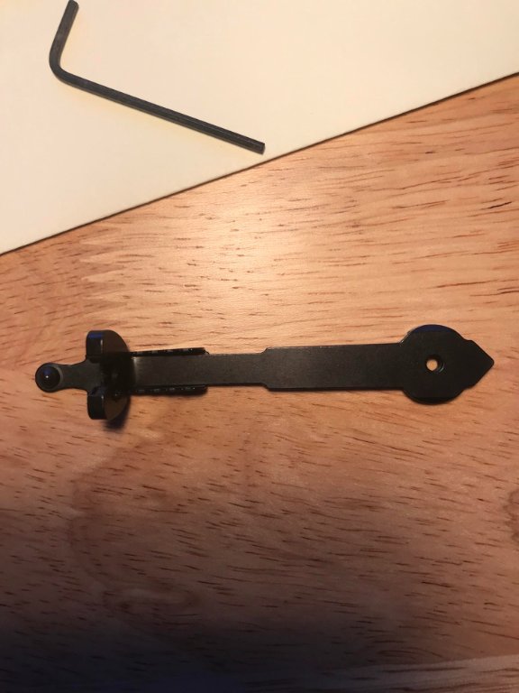

I had to remove the buckhorn for scope mounting, and am about to reinstall it and go to the range. I *think* the buckhorn was on the secondish elevation rung from the factory. Does anyone know where they are set from the factory? Did you find you had to go up/down from there?
Also, I remember taking out one screw. There is a hole on the top of the buckhorn, does the screw operate like a set screw? Lastly, any guess which of these screws is the right one? Probably one w/o locktight, and maybe it has a washer? Can one of you please take a peek at yours and let me know washer/no washer?
Thanks much, pics below

When in doubt, read the manual... https://assets.henryusa.com/uploads/202 ... Manual.pdf page 9-10.
For the number of rounds I'm sending downrange, I can probably live without the set screw, but I would like to know which one it is and the factory setting would be a little helpful but not critical.

Sorry for all the posts. I think I figured the screw out... one of these things is not like the other. It is the small set screw with a slightly smaller head the the plug screws for the bases...

You don't have to completely remove the screw. Just loosen a turn and you can tap the sight over. When at the range put a piece of light colored tape in front of the sight base and put a small mark where the site is for a reference point when adjusting windage. My Henry came with the elevation set at lowest point.
