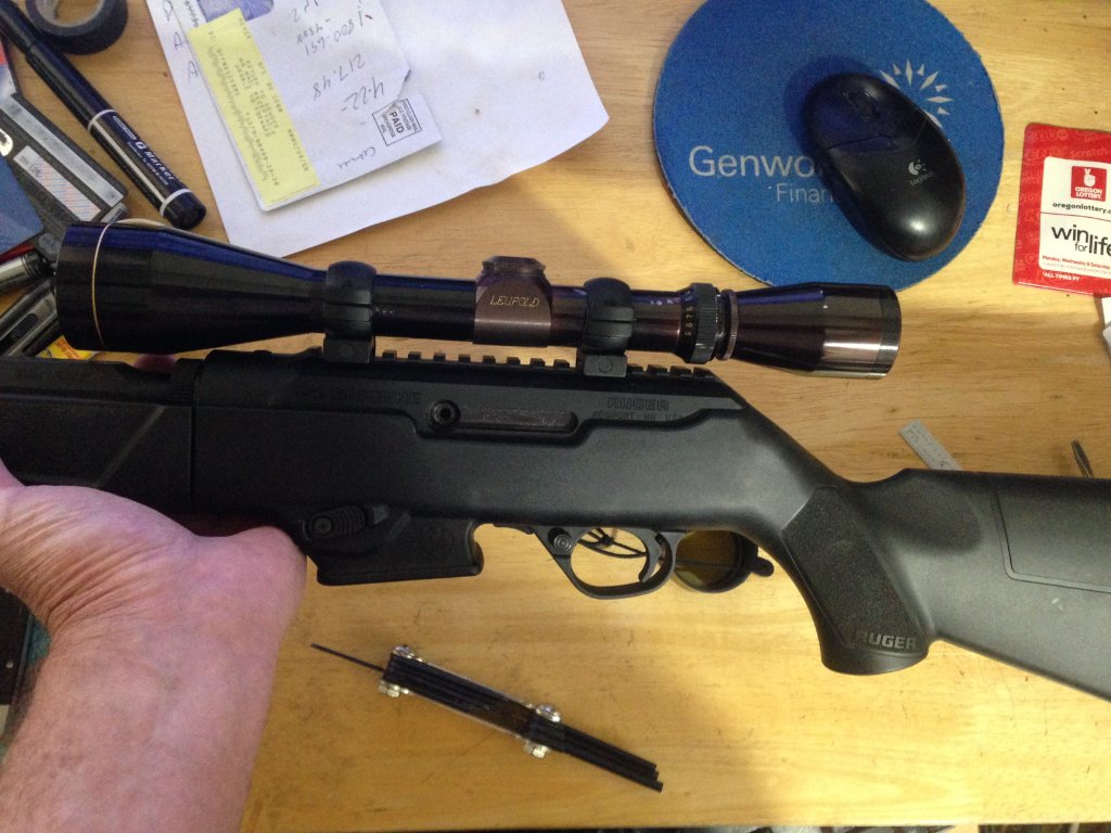

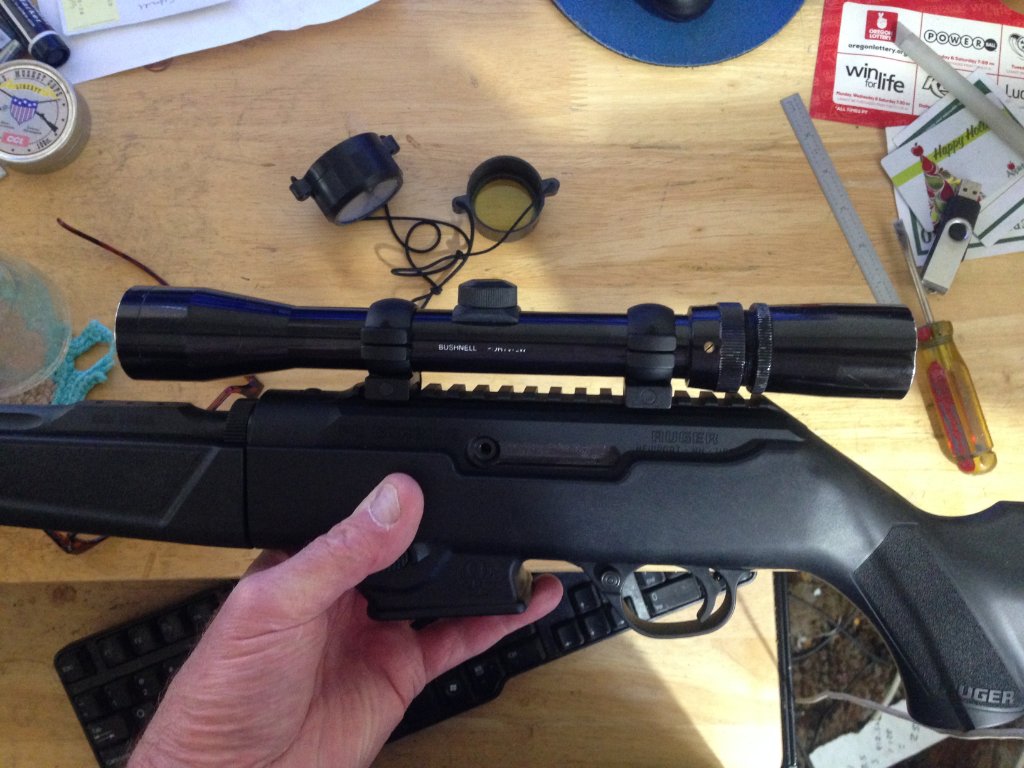

Well, I got to chatting with a guy on another forum and while doing so the question of whether a Weaver base will fit on a Picatinny rail came up so I had to go pull the scope off my Handi-Rifle (with Weaver Bases) and try it on my PCC - and it works perfectly! Basically a Picatinny rail is an improvement of the Weaver style in that it has more grooves for better fore and aft adjustment.
So the first pic is the scope off the Handi-Rifle and I got to thinking I might go shoot it to see just how accurate the PCC really is but I thought the scope looks kind of big on it - so then I remembered I had an old Bushnell 40 MM on an old .22 that is really clear and so I swapped it out - looks a little better as it is not so 'bulky'.
