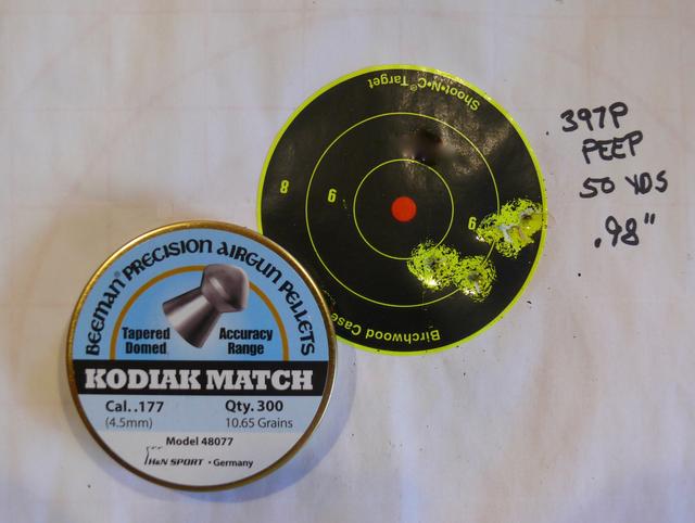

Another great pellet for my Benjamin 397s and my first choice has been the heavier Kodiak Match 10.65s. They are more expensive, but a couple of my Benjamin 397s will do well under an inch at 50 yards with them. The Kodiak Match also work great in some of our other air guns, so I usually keep a good supply on hand and often save money by buying them in large quantities.
