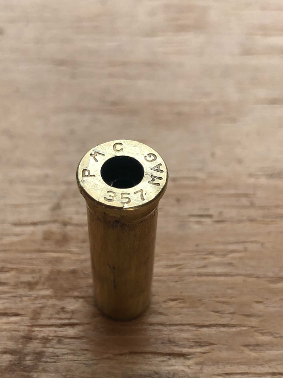

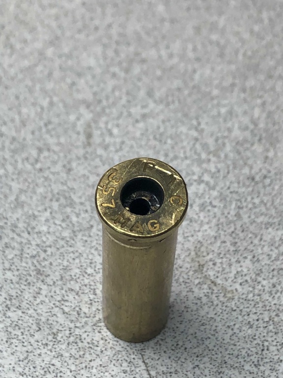

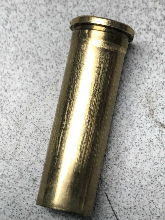

I was at the range today firing both my BBS in 357 Mag. and my Marlin 1894 in 45 Colt. I was finishing up my last reloaded 10 rounds of 357 Mag., when I squeezed the trigger on the third of these last rounds. The report and feel was entirely wrong and I knew something was amiss. i went to operate the lever to load the next round and the lever was firmly stuck in battery. I immediately unloaded the 7 remaining rounds from the magazine tube. I would not have been able to do this if it had been the Marlin that malfunctioned like this. (One of the pluses of not having a loading gate.)
After letting the BBS cool for about 15 minutes, with great difficulty, I was able to operate the lever and eject to fired case. The primer was completely blown out of the case and it was very obvious the case head was severely flattened. Afterward at home I took some measurements and the case rim measured 0.450" (max 0.440') and the primer pocket is 0.188" (should be 0.175").
The BBS appears to have sustained no real damage. I did test fire a few other 357 Mag. factory rounds I had and they functioned properly. I saved the remaining 7 rounds to disassemble and see if any of these are over charged. All of these rounds are loaded on my RCBS progressive press. At the time, I was having an issue with inconsistent overall cartridge length, and may have been distracted trying to fix this. These are a few pictures of the fired case. The first picture was taken at the range immediately after I ejected the case. The second and third picture owe shot on my work bench. Note the enlarged size of the cartridge rim, primer pocket and flash hole.
- Side view

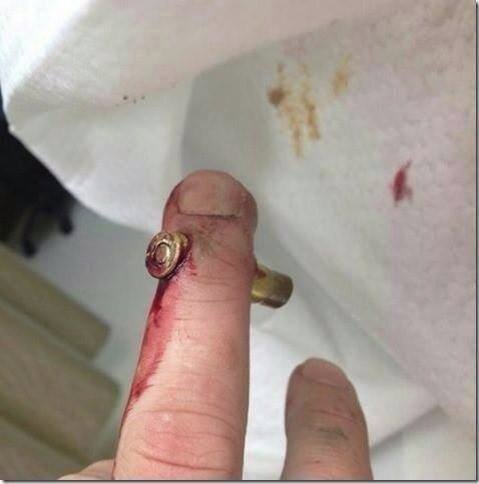

fortyshooter wrote: ↑Tue Sep 15, 2020 7:06 pmWhat the heck happened there? Primer looks like it hasn't fired??
Have no idea, Forty. Saw that on another forum a few yrs. ago & saved it. This topic made me think of it. Had to get caught in a press looks like.

Yep! The VC had some nasty booby traps. We ran across one now & then. Kept you on your toes, 24/7.Team Roper wrote: ↑Tue Sep 15, 2020 7:39 pmLooks like somebody shot you with the wrong end of the cartridge or was that something from one of them VC booby traps.

Just curious, were you trying to center up the bullet on the mouth of the case and then inadvertently pulled on the handle with the slip? Because I have done that and each time it was a close call. I have since learned to slow waaaay dooown.
BTW, one of my primary jobs over there on my first tour was Point Man. Right off the bat, they put a machete and compass in my hands and told me to drive on. I was replacing the old PM who was just days short. He tried to tell me all about the booby traps. Those little black pajamas were a crafty bunch.

Forty - The load I was using was a 158 gr. Nosler jacketed hollow point bullet over 6.0 gr of TiteGroup. From the results there was something more than 6.0 gr. in that case. Last night I pulled apart the remaining 7 rounds from that batch and all were up to spec. So it appears that only the one round was over charged. Again my best guess was i did this when I was trying to resolve the inconsistent overall length issue. At the point I did this I already had the press full with cartridges in each station and there in is the problem. In hindsight I should have cleared the press of all but the one cartridge and proceeded to troubleshoot the problem. I've done that many time before, but was just too lazy and almost paid a very big price.fortyshooter wrote: ↑Tue Sep 15, 2020 7:11 pmHeadhog...glad you survived that incident and that the Henry had a good strong bolt in it!
