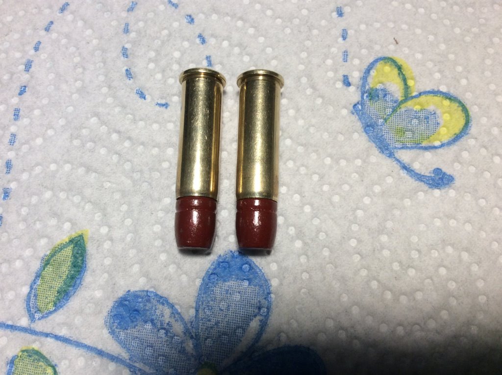

I loaded up 25 rounds to try maybe tomorrow and compare to my 180 Mag. case loads. Went with 11.1 gr. of 2400 powder on this first
batch. One thing that was causing a slight issue was a variance in my COL. I was setup for a 1.575 length but due to the lube groove being
a radius shape at bottom if there was a +.005 length difference in case length it would roll in and pull the bullet down an additional .010-.015.
Actually not a bad thing since the crimp looks better,tighter at the 1.560 length as you can see in picture.
At left is the 1.570 COL and right is the 1.560
A big thanks to Vaquero for helping out with this project! ;)

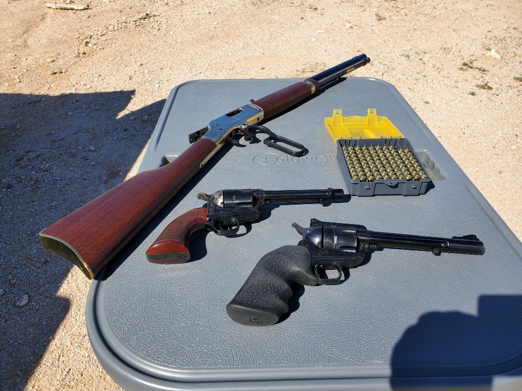

So, I've been offline for the past month. Work sucks, but I need the bucks to keep doing what I love to do.
I have never loaded 180 grn 38 loads, and I am a 38/357 guy. My go to has always been 158 grains. On the range, mission carry, whatever, I have been anal about 158 grain. Probably goes back to my early days in the early 70s and real world deployment with successful results.
I am interested to see how the 180 preform. As I said my favorite calibers are 38, 357, 45 Colt, both pistol and rifle.
On another note, I received 500 rounds of Hornady 110 grain XTP from Hornady as a rebate for the Hornady LNL Ap press I got for Xmas from the Mrs.
I have never loaded 110 grain, always saw them as sissy rounds.
Well ,slap me in the lips and call me late to dinner, I just loaded 38 and 357 and LOVE them ! (as range rounds only).
38 was with 4.9 grns of Bullseye at 950 fps, and the .357 was Alliant 2400 with 16.0 grn for pistol (1350 fps) and 16.4 grns for rifle at 1800 fps.

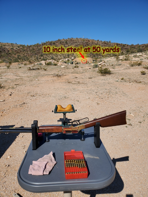

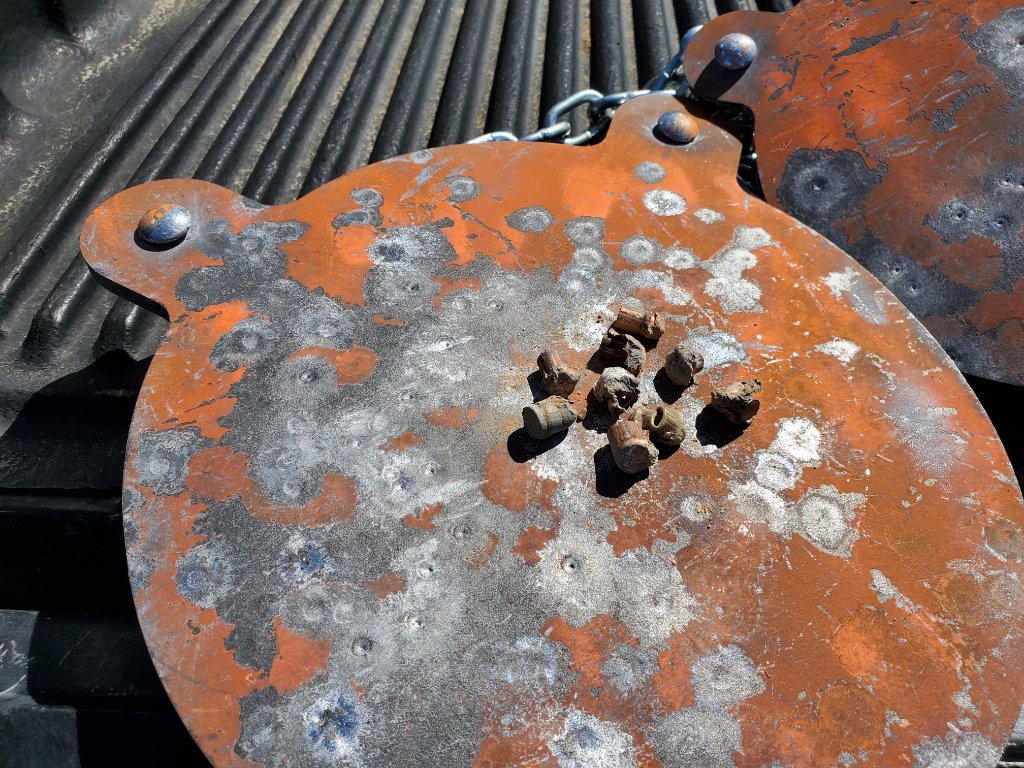

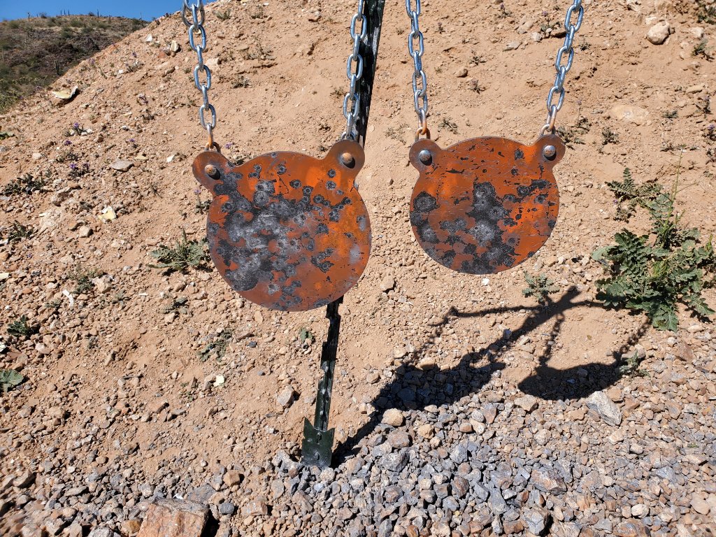

I set up my range yesterday with steel at 50 yards. Boy, was I surprised. I am sorry I did not set up silhouettes, but the 110 was hitting the steel consistently with all three loads from the bench with the Henry. Pistol was good (Blackhawk/El Patron) from the bench rest, kind of shaky from the unbraced off hand position, but hitting the steel at least one of six rounds. (yeah I'm old and my hands shake, but it was 50 yards with iron sights).
Long story short, love the 110 grn for plinking (not for duty carry), and will continue to load them up. Still very interested in the 180 grn and how they preform (Pistol and/or rifle).
Got the AP press set up for 45 colt tomorrow, more to come. Hope all hands are doing well !

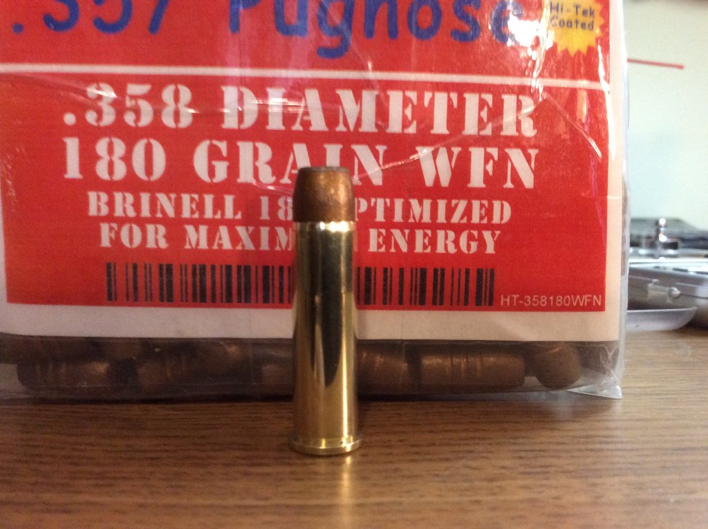

I did a short test of the MB 180 bullets in the Mag and 38 Special case. Now with the 38 Special case I seated the bullet to the empty lube groove right under the crimp groove for a 1.560 COL. I did this to give very close to same powder space as when loaded in the Magnum case...within .030 of same.
Ran both the .357 Mag and 38 Special load over my chrono. The Magnum load was 11.5 gr. of Alliant 2400 and the Special load was 11.1 of 2400.
Result was,as shot thru my Henry BB 357, 1380's FPS with a very tight speed spread like 9 FPS! The 38 Special/Mag load was close at 1310- 1327 FPS.
From that I think it could be safe to bump it up to 11.4 and might match the speed.
The 180's shoot very well in the 357 Mag case. I did this little trial since I had a bunch of .38 Special brass on hand and wanted to try it.
Now I have a new batch of Starline .357 Mag brass coming and will continue to load those.

The 180 Pugs as they are called are from Missouri Bullets and the ones I get are Hi Tec coated. I think those are 49.95 per 500 box.
But just check out their website. Easy folks to do business with!
