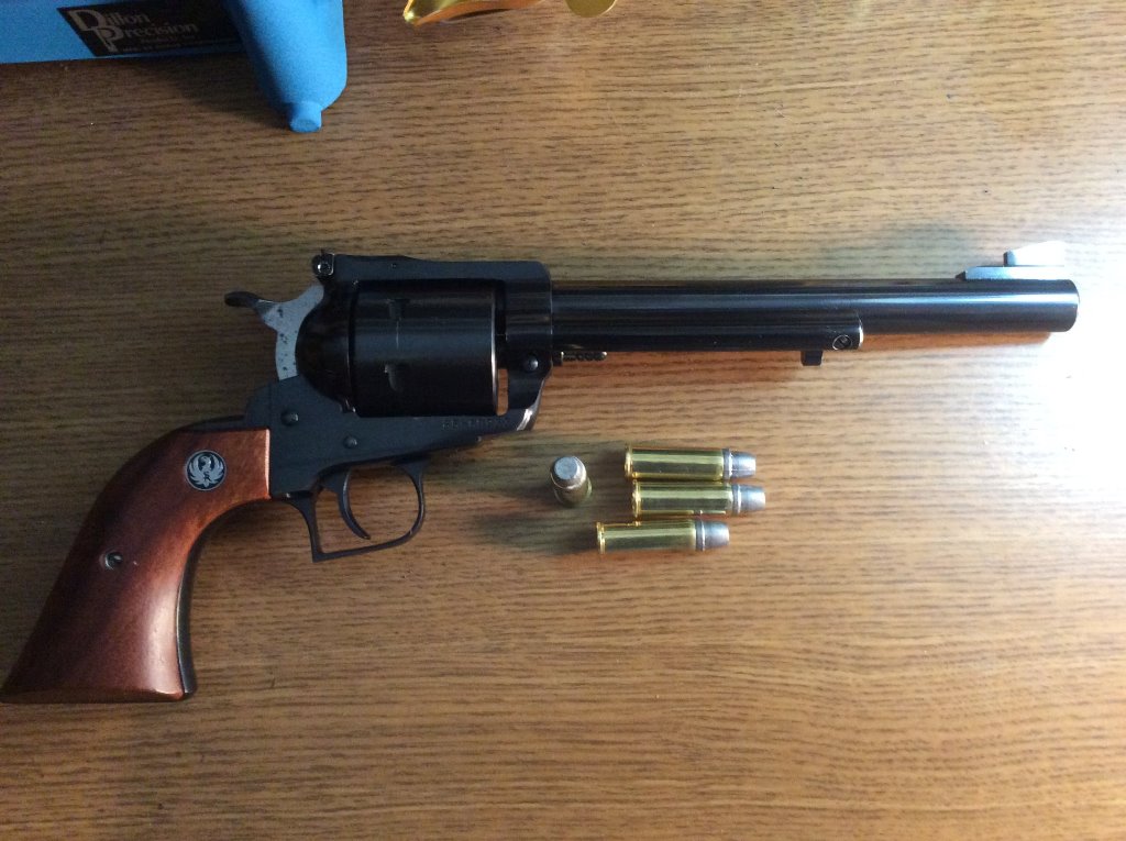

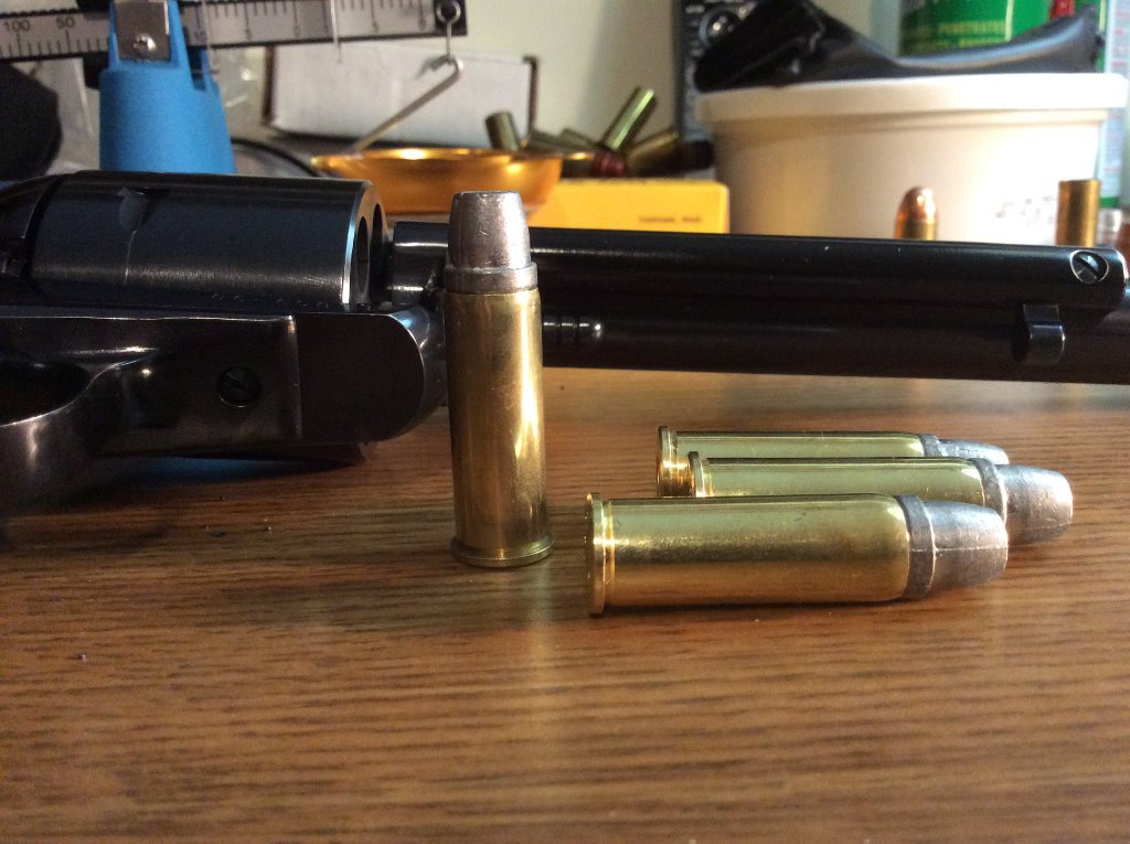

Big Al sent me some of these 250 gr. Keith style bullets to test out and suggested his 10 gr. Unique load.
I will shoot them with my Ruger SBH revolver and see how they shape up on a target. Will also test some with 18 gr. Alliant 2400 powder
as a comparison. The COL worked out to 1.700 and might be a bit long for cycling thru my Henry BBS carbine.
Many thanks to Big Al!
Range report soon!

Those look bad Forty hope they work for you like they did me.

Good luck forty, they look bad ass.
Note; last week I loaded some 300+ 44's they ended up 1.71, and would not cycle through the BBB.
I later made a dummy round, and had to shorten it to 1.63.4 before it would cycle.

Nope...won't feed in the Henry!
Re: .44 Mag 250 gr. Keith bullet loads...
Post by BigAl52 » Fri Jan 17, 2020 11:13 am
You could seat them over that drivin band and crimp on that if you want to try them that way.
