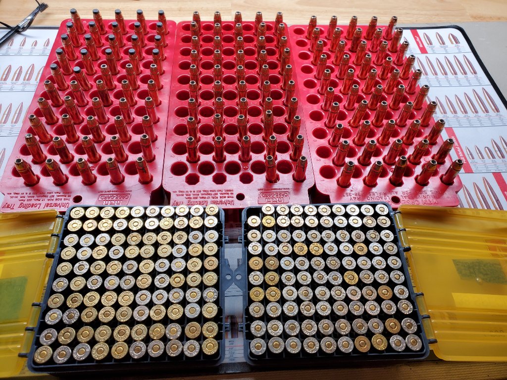

Finished up a small batch of 38 Special +P today using 125 gr. Xtreme plated bullets I've had for a while.
Had a 5 lb. coffee can full of .38 Special brass that I needed to do something with and this will be the last loading for the year!
Only have 2 revolvers that I shoot .38/357 from being the S&W M66 and the Ruger LCR .357
Always tempted to get a lever rifle to 38 plink with. Waiting for a HR 357/38 side gate maybe???? ;)

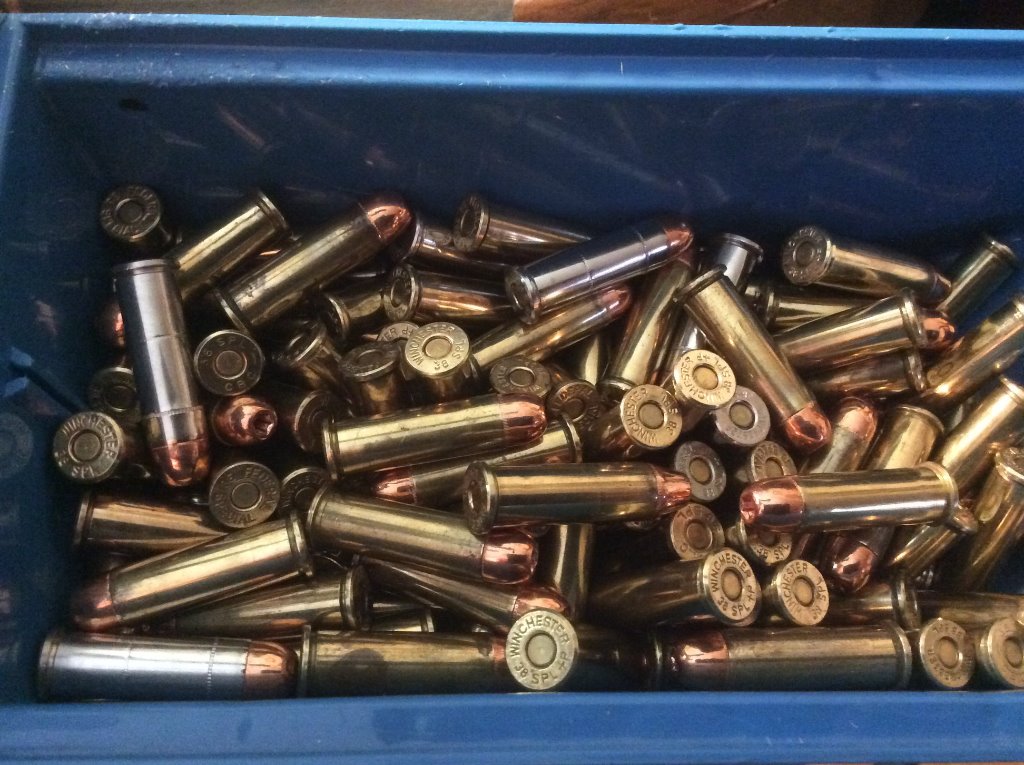

Well, how about that? Seems we have some that think the same here. I loaded up 200 .38+P for our after Christmas desert shoot. These will be thru my Blackhawk and Henry along with some .357. My .38 loads are Silver State rnfp 158's, 5.0gr Unique and mixed brass. OAL is 1.455".

I loaded those with 6.2 Power Pistol which should have them in the 1000 FPS range or so out the 4in. Smith.
