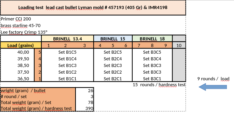

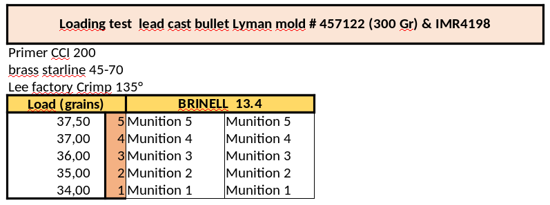

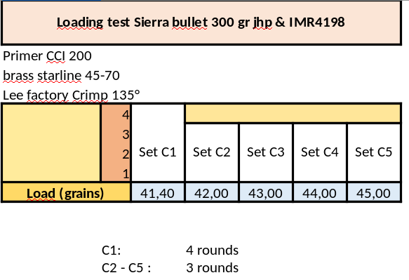

Personally for the 45-70, I make test tables based on the type of bullet cast, their hardness, the powder charge.
by comparing the results, I can then produce what suits me best.
The initial choices were based on availability (we do not find all the powders in France),
the desire to mold bullets by economy and also pleasure.
i always stay under the max load indicated on books to be sure that it is not dangerous.
after each shoot i will look at the brass to see all signs of overpressure.

All the data comes from Lyman, lee & so on...
you may be able to adapt this technique to your ammunition
friendly,
bruniX
