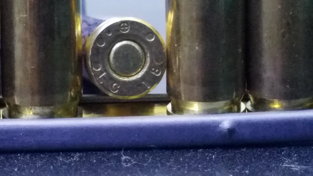

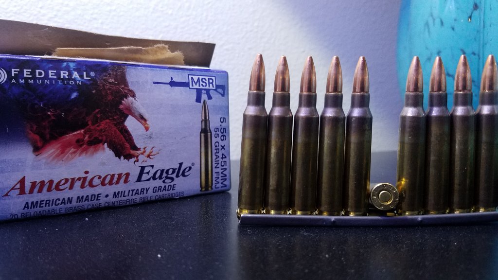

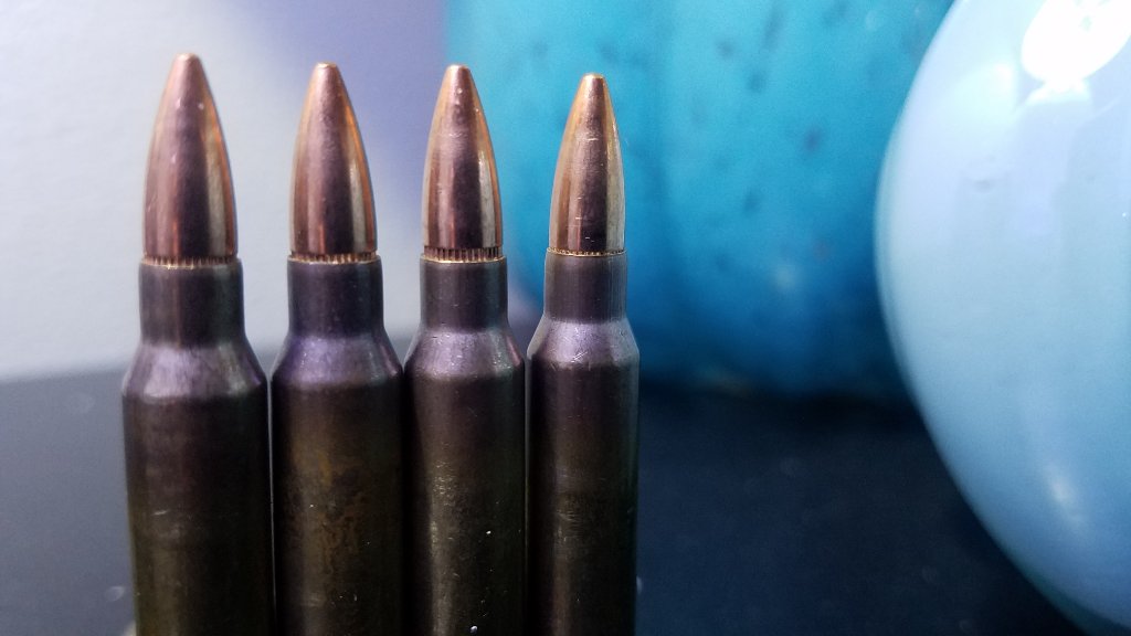

Re: Sorting brass
Post by Mags » Wed Nov 13, 2019 9:56 pm
Pictures below.
The head stamp on these LC 18, no caliber stamp. Which is somewhat perplexing. Marketed by Federal, manufactured by Northrop Grumman Innovation Systems (but originally by Remington). Some of these look like they aren't seated as deep as they should be.
Worst OAL 2.267 and best 2.247.

Post by Mistered » Wed Nov 13, 2019 10:49 pm
LC 18
Lake City Arsenal, 2018
Are the rounds in the stripper clips 'new' out of the box?
If so this is probably surplus military ammo just repackaged. I can tell by the color of the cases at the taper & mouth.

Re: Sorting brass
Post by Mistered » Thu Nov 14, 2019 6:08 am
I don't know about the 'perplexing' part and Like I said this is typical for military brass.
Again not untypical for military ammo.
It ain't match grade stuff.
