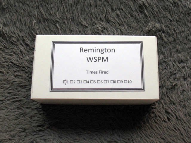

My preference is for a light load since my only shooting is at paper. I wanted a single load that would work well in both, my .357 BBB and my SAA revolver. After a bit of experimenting, I settled on 13.9 grains of H110 under ZERO 158 grain JSP/JHP bullets. It's at the lower end of the start/max range for the revolver and in the middle for the rifle.
Box of 357 Reloads.jpg (71.69 KiB) Viewed 2942 times
Box of 357 Brass.jpg (61.94 KiB) Viewed 2942 times

CT, I sure like that packaging you have there. You make that yourself? Nice and neat.

Post by CT_Shooter » Tue Nov 12, 2019 11:19 am
Thanks, Tom.
I print the labels myself just to keep myself organized. I only reload .357s (and occasionally .38s) and currently have twenty-five boxes of primed .357 brass in 50 round boxes marked with the number of times each box has been fired. I prime the brass as part of my cleaning/prep process so that reloading goes very quickly on my single-stage press; just add powder, a bullet, and crimp. Once a box is reloaded, I print a label, in the form of a cigar ring, identifying the powder charge and the bullet used. I bought the white boxes from Midway USA when I first started reloading.
Thanks CT, looks like what I am after, specific loads for rifle vs pistol. I like your ammo boxes and packaging, looks outstanding !
