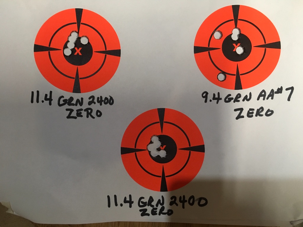

Rcwill
Re: Henry Big Boy 357 Bullet Choice
Post by Rcwill » Tue Jun 25, 2019 10:16 pm
Well, thanks all for the advice on Zero bullets. Finally was able to load some up and get to the range. Problem solved...it is now my go to bullet. 5-shot groups at 50 yards. I’m happy!

Posts: 4015
Post by Rifletom » Wed Jun 26, 2019 1:35 pm
Dang! That is some good shooting. Glad things worked out. Are those Zero's jacketed or...? Thanks.
BTW, have you tried that BE-86 yet? I like it in .357.
