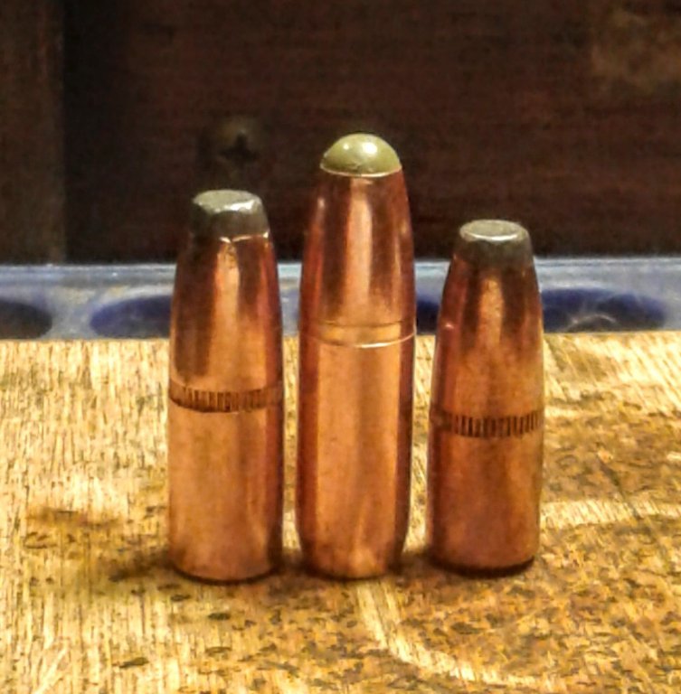

Post by Ojaileveraction » Fri Feb 22, 2019 1:56 am
Here an image of a Nosler 30-30 Etip between a Sierra 170 and 150 flat nose bullets.
You can see the lead free Nosler is longer than even the 170. The extra length is all in the bearing surface with more bullet in the case.
We will have to see how that effects muzzle velocity.
