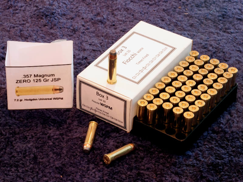

So far, I've been through about 750 of these handloads using the same recipe. They're just above Hodgdon's starting loads for use in my revolver, but I also shoot them in my Big Boy.
I keep all of my working brass in labeled boxes that identifies the headstamp and the primer. I make "cigar ring" labels for the finished box of ammo that indicates the bullet and the powder information. Then I lock them in the ammo cabinet for my next trip to the range.
Once they've been fired, I clean the brass, prime the cases, and put them back in their box, then I check off the number of times that they've been fired.
I loaded these yesterday.
.357 125 gr. JSPs Box and Sleeve

CT_Shooter wrote: I keep all of my working brass in labeled boxes that identifies the headstamp and the primer. I make "cigar ring" labels for the finished box of ammo that indicates the bullet and the powder information. Then I lock them in the ammo cabinet for my next trip to the range.
Great system. I wish I was that organized.
All of my pistol/revolver brass ends up tossed into caliber specific bins until I have enough to justify tumbling a batch. Head stamps always end up mixed and I have no clue how many times individual cases have been loaded. I'm careful to inspect each case before loading and keep revolver brass trimmed to uniform length to ensure consistent crimp.
I try a bit harder with rifle brass. It all gets sorted by headstamp and number of times reloaded gets logged.
Posts: 5797
Re: What are you reloading today...???
Post by CT_Shooter » Fri May 20, 2016 4:34 pm
Owly wrote: ...keep revolver brass trimmed to uniform length to ensure consistent crimp.
I used to trim the brass, but after doing it once, additional trimming never made a difference. Now, I don't trim them at all. Because I use brass of the same origin in each box of cases, when I crimp, which I do as a separate and last step, I reset the die for the length of the cases in that particular box. It's an easy adjustment to make. Knock on good Henry wood -- I haven't had any issues.
