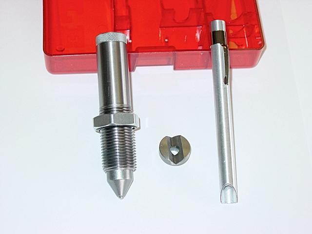

Hello guys,
has some of you used Lee Hardness tester ?
is this precise ?
