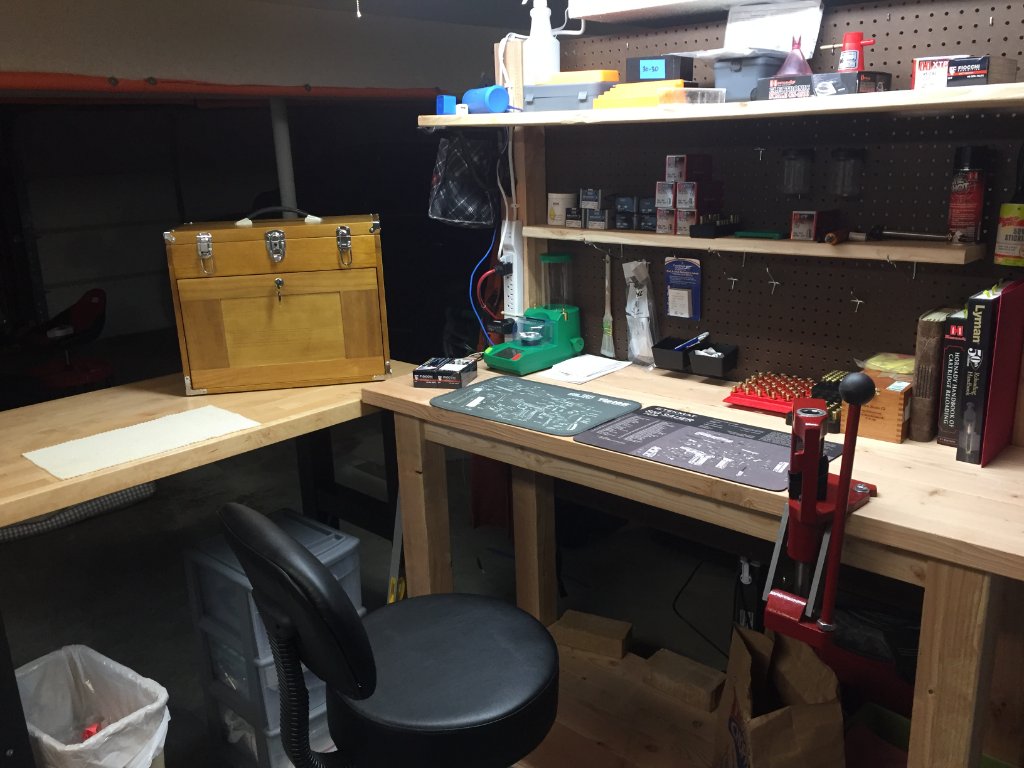

Had to get the gear in order, starting with the “workstation,” as we used to say in corporate America, and even the additional bench wasn’t enough workspace, so I added the raised table (and casters) at 90-degrees.

In the meantime, I’d also added the RCBS Chargemaster Lite, as on-press powder loading didn’t fit with my visually-oriented brain. Got it calibrated in no time. Nice adjustable feet made for quick leveling, too! I’d be lying if I said I had no problems keeping all those tiny powder specks corralled, but such is the newbie life!

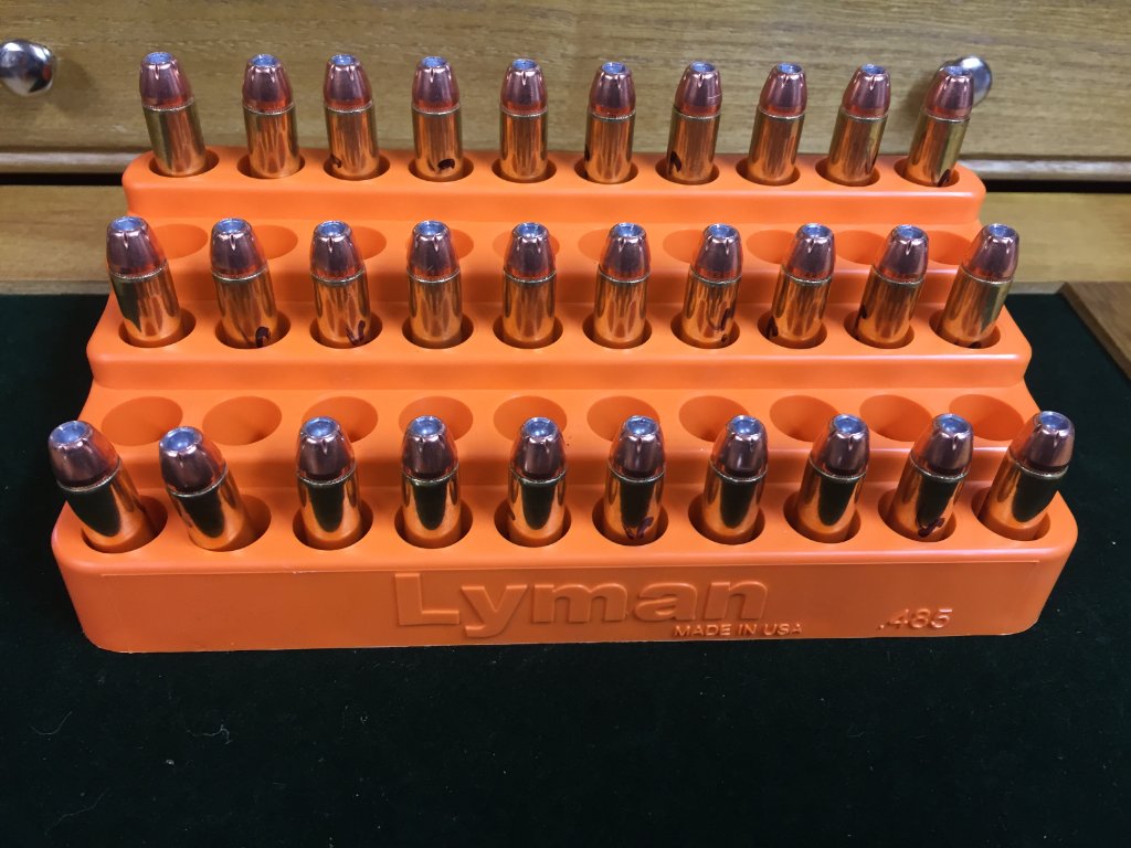

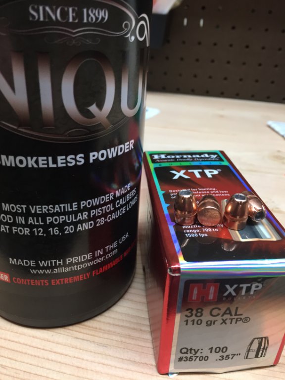

Sticking with my “walk before you run” philosophy, I only loaded up 30 rounds today, using the 110gr XTPs that Hornady sent me 500 of as part of their rebate program (for buying the Kit) and Unique at 7.5 gr, 8.5 gr and 9.5 gr (10 of each), based on Lyman’s data that called for a minimum of 7.4 gr and a max of 10.0. Winchester small pistol magnum primers.
Ended up with overall lengths of right at 1.586-1.588” (vs. SAAMI of 1.590”) which was interesting vs. my factory Fiocchi 142 gr, that measured 1.579”. It also appears that the Fiocchi has almost zero crimp, but I guess that stands to reason as it’s not made specifically for lever action rifles.
Anyway, here’s some pics of the finished lineup, 7.5s in front, 8.5s in the middle row and 9.5s in the rear (marked the cases with a Sharpie, just in case). Also a pic of the Fiocchi side-by-side with the hand-load, from which you may (or may not) be able to see the differences in the crimp. And my little workstation!

I just noticed on the bench you have a rcbs 1500 chargemaster. How do you like it?
Re: Tales from the Bench (FINALLY)!
The 1500 has all the bells and whistles. I've got the "Chargemaster Lite," which is just fine by me. Don't have anything to compare it to, and I'm sure if I had previously owned the 1500 that this one would be a "step down," but such is the benefit of not knowing any better.BigAl52 wrote:I just noticed on the bench you have a rcbs 1500 chargemaster. How do you like it?
Set up and calibration was very easy, it has an "Auto" mode that automatically reloads same charge onto the tray once you simply set it down on the platten, clean out was pretty quick and easy and, most important to me, I can see what's going on.
Not the fastest in the world (again, I have no basis for comparison), but I'd rather sacrifice a few minutes per session for the sake of accuracy, and it seems to be super accurate.

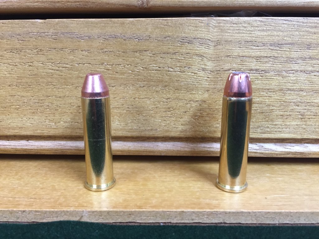

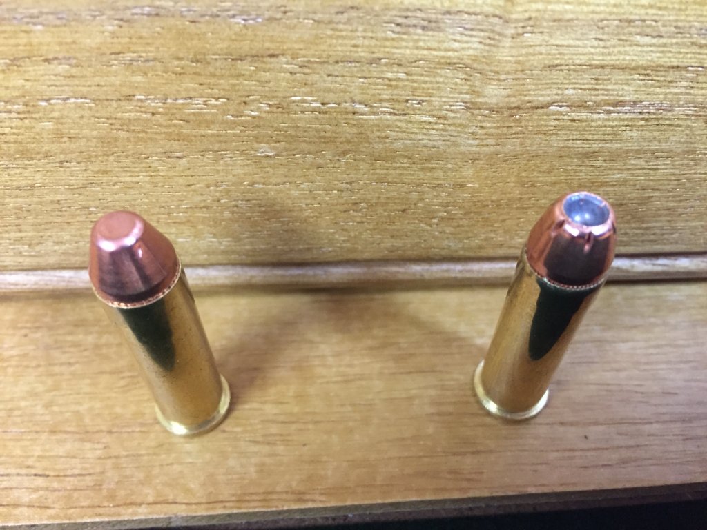

FYI. Keep your eye on the rounds you made that only have a slight crimp. When I first started reloading, I had a small batch like that, too. The bullets were pushed deeper into the cases in the mag tube from the recoil. That may not happen with yours, but be aware.
As to the crimps, they're all the same, done with the Lee FCD. It's the one on the right. Does it look crimped enough? All I could do was compare it to the FIocchi factory round (on the left), which doesn't appear to have much of a crimp at all (to my untrained eye) and with which I've had no problems with bullets retreating into the case under fire. Will watch it, though, thanks for the heads up.

Looks to be a decent crimp. Do you have a .357 revolver to try these rounds in also?
If so you could load up a few and fire all but one and compare COL to the other unfired.

I usually just tap the test round a few times on the bench. Measure before and after. If it shrinks, I adjust the crimp down a little more. I normally use a light crimp, unless more is necessary.
