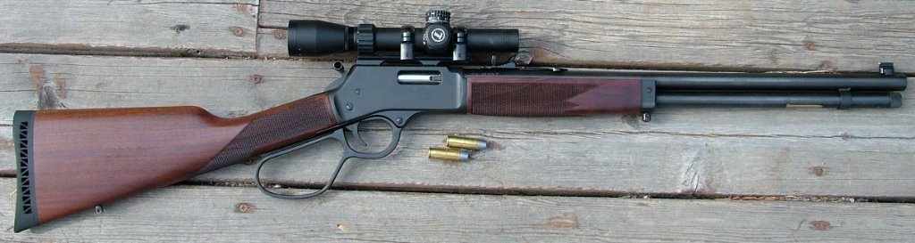

Post by wingnut » Sun Dec 30, 2018 2:46 pm
My BBS45 (not a carbine) with Leu'd 1-4x and a Cast Performance 45/360g gas checked load.
Sorry about the BIG.

Post by fortyshooter » Sun Dec 30, 2018 4:00 pm
Very nice...just like my .44 Mag version! I have some .44 Mag loads using the Missouri Bullets 300 gr. bullet but don't think the 1.700 length would feed in the stock action. I shoot them in my Ruger SBH though.
