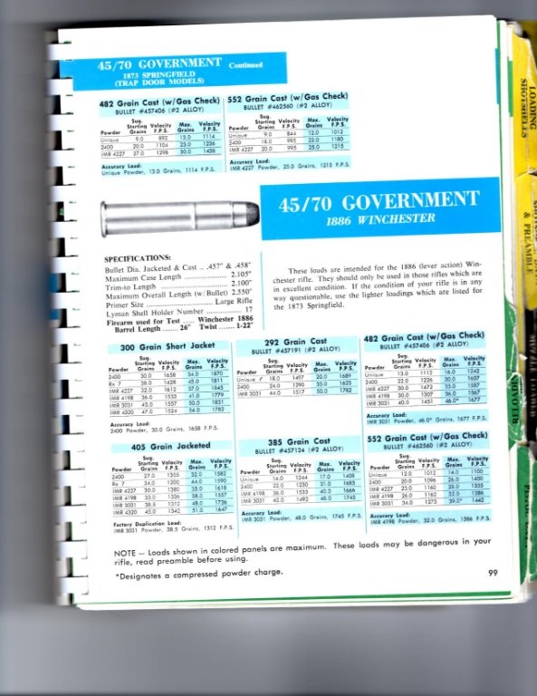

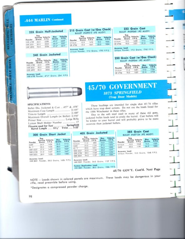

You might want to research 45-70 load data using it and give it a try - it is essentially my all - around 'go to' powder.
Here is a scan of the 45-70 data from the 'old' Lyman 44th edition load manual and it shows a few loads using Unique.
img001 (2).jpg (90.39 KiB) Viewed 3383 times
img001 (3).jpg (81.89 KiB) Viewed 3383 times
