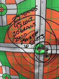

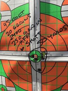

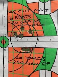

So I decided to load my own 45 colt rounds... I've been using 250 grain XTP's and I've tried H110, 4227, LIL GUN, Titegroup, and 2400. I love H110 but I'm concerned about reports I've heard of poor cold weather performance. After all is said an done I think that I really like 20 grains of 2400, using Starline brass, WLP primers, and a pretty good crimp. Here are three photos, all shot from my Henry Big Boy at 100 yards, 50 yards, and 25 yards. There have been no signs of overpressure and the recoil isn't bad in my Henry.. But pretty stout in my Ruger Alaskan. Are these fairly typical of the groups you've been getting? Any suggestions or thoughts? I would appreciate any input.

Looks like ‘minute of deer’ to me. I’ve no experience with the 45C...yet

the 100 yard group is not bad at all and the ones at shorter distances are even better .... personally, I wouldn't hesitate to deer hunt with the ammo you were using .... Ranch Roper has more experience with 45 Colt than anyone I know .... it might pay you to contact him if he doesn't see this post .... please take a look at our How Many ? thread (link below) and add yours to our community's total

Nice shooting. My 1860 has a toggle link action same as 1866 and 1873's. No hot loads for me but yours should drop whatever is comin' at ya'.
Re: .45 Colt Mag
You didnt mention anything about a scope on the rifle but if those are with iron sights I wouldnt change a thing. 2400 is a great powder in many pistol calibers. Even if a scope is used the 100 yard group is great for the 45 colt.

Thanks for the replies guys. Yes, I do have a Leupold 2x7 scope on my rifle.. The shots were with the rifle resting on a sandbag. I think that's going to be my hunting load.. Anyone have a favorite 45-70 load? I have 3031, H4198 and 2400 powder... I do have some Hornady 300 grain hollow points... I tried some rounds with the 300 grainers with 48 grains of 3031, but wasn't super impressed. What do you think of 405 grain Laser Casts?

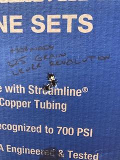

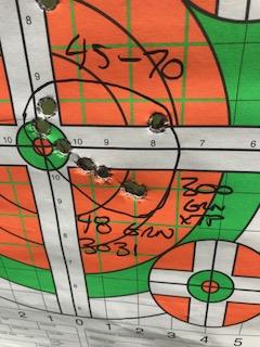

Thanks again guys.. Big Al you may be right. Here is a 100 yard 3 shot group with my Henry 45-70 and the 325 grain lever revolution. Pretty dang tough to beat that factory ammo! But it's fun working on loads.. I also included an interesting 'string group (with one winger)' That was 8 shots at a hundred yards with 300 grain hollow points and 48 grains of 3031.
I think I will take your guy's advice and try some cast bullets, lighter loads, and slow moving freight train velocity... Some loads that I've tried pretty much kick you into the next day.
