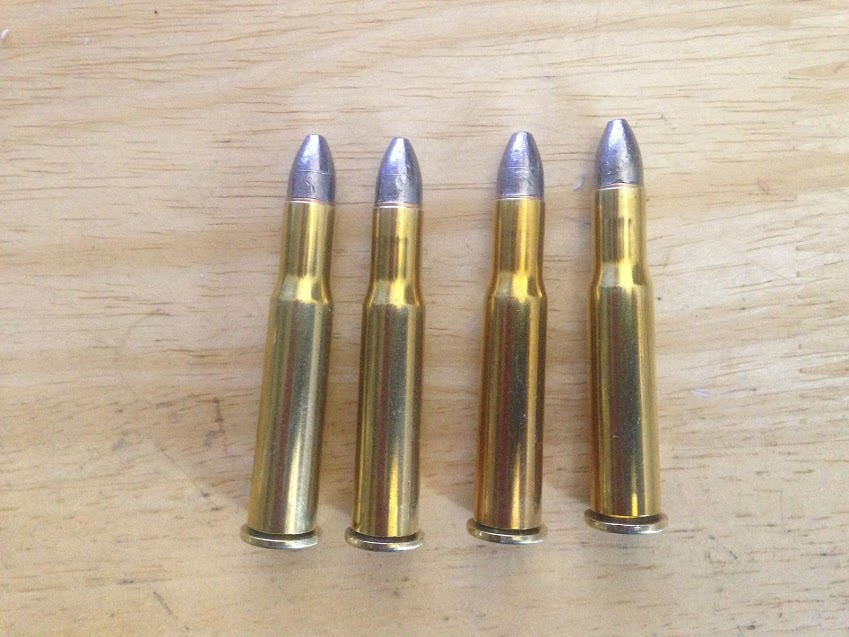

Post by Mistered » Thu May 17, 2018 10:46 pm
These are 30-30 loaded with 12 Grains of Unique and 100 gr Hornaday short jacket bullets (Speer Plinkers are better however)
Chrono at about 1700 FPS and very accurate...
The brass is some old .32 Win Spl I reformed to 30-30. I may have mentioned this brass before. After tumbling it turned a very deep orange/yellow color and does not tarnish! Better brass in the 'old days'?

Mistered
Re: 30-30 Loads
Post by Mistered » Fri May 18, 2018 1:21 am
Well I have been reloading for a 'while' - and learned a few things along the way! The nice thing about reloading is you can create as 'attractive' ammo as you want - and while not appreciated by all I like my ammo to be nearly 'new' looking when I am done - and it doesn't take much more time to clean the brass to like new condition before reloading.

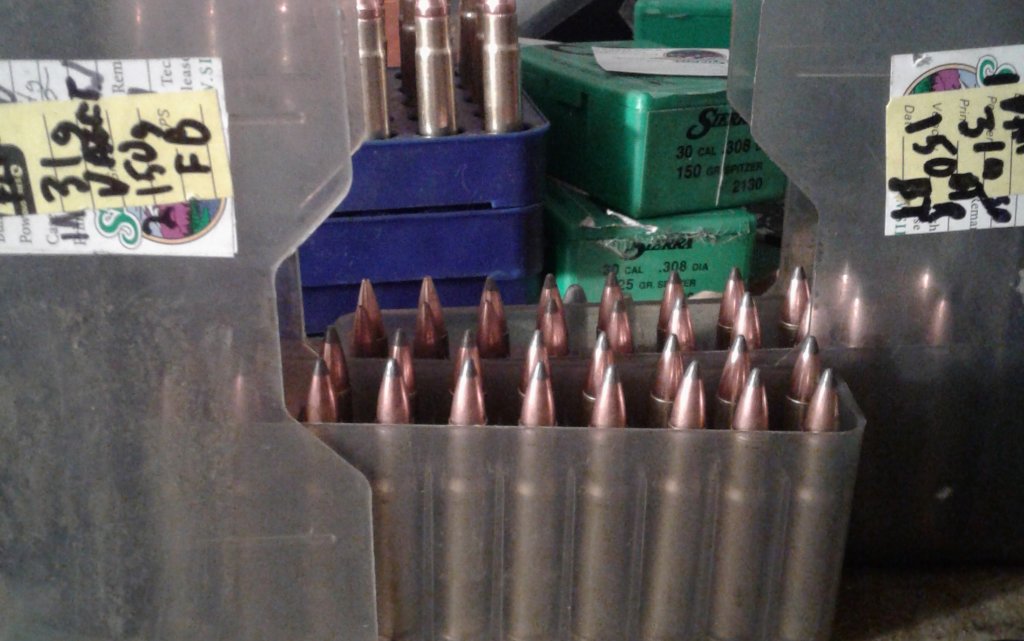

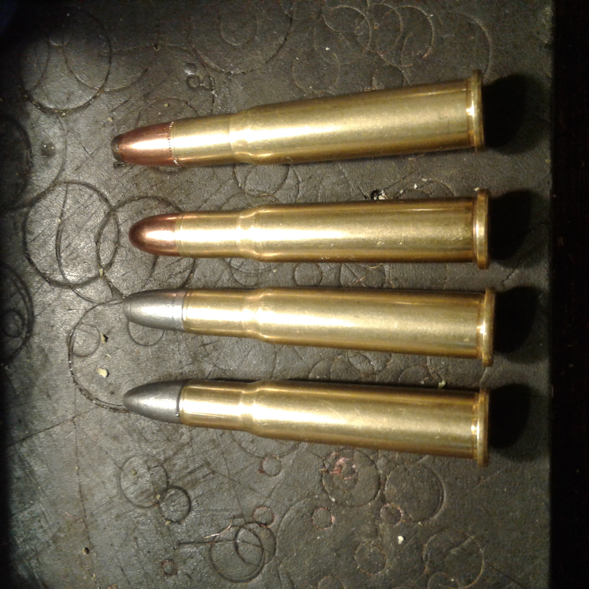

Ojaileveraction
Re: 30-30 Loads
Post by Ojaileveraction » Fri May 18, 2018 10:51 pm
These are four different loads I'm shooting. Tumbled Winchester brass.
Top to bottom
For my Zane Grey
150gr Sierra FN over 30gr of IMR3031
110gr Sierra RN over 30.5gr IMR3031
To try in my new 336xlr
170gr FN over 15gr H4198
160RN over 9gr Traiboss

Re: 30-30 Loads
Post by Rifletom » Tue Sep 04, 2018 11:28 pm
I know this is an older thread, and the loads look nice. Can you load those pointed type bullets in a tubular magazine and shoot? Curious.
Posts: 20450
Re: 30-30 Loads
Post by JEBar » Wed Sep 05, 2018 8:31 am
as a general rule, spitzer point bullets should not be used in a tubular magazine .... I don't like them, I don't use them but for those who do, Hornady LEVERevolution bullets are an exception ====> https://www.hornady.com/ammunition/rifl ... olution#!/
