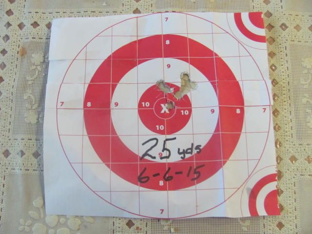

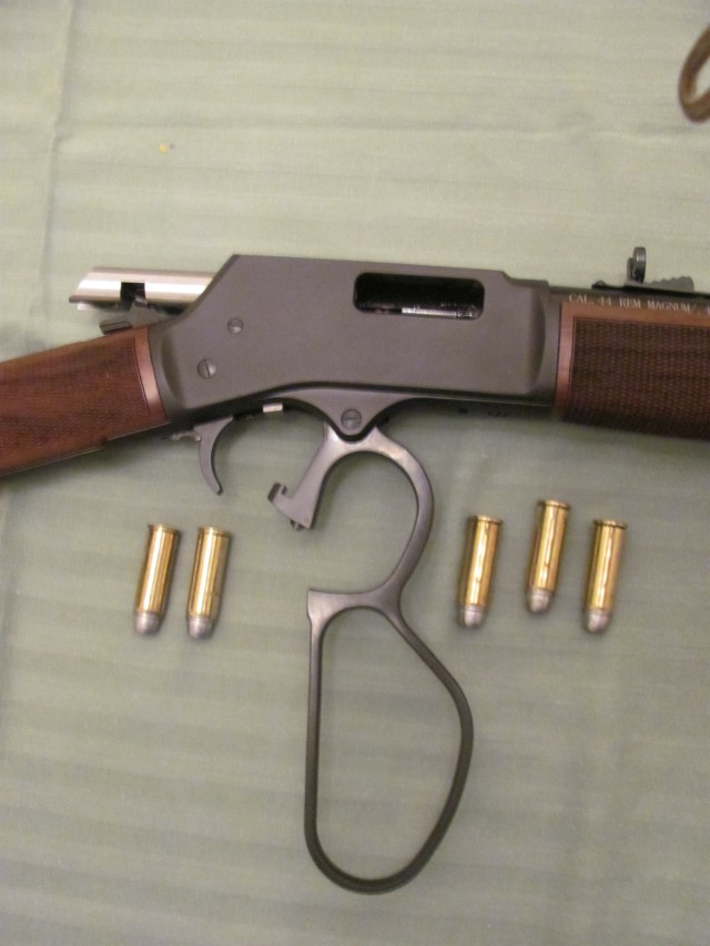

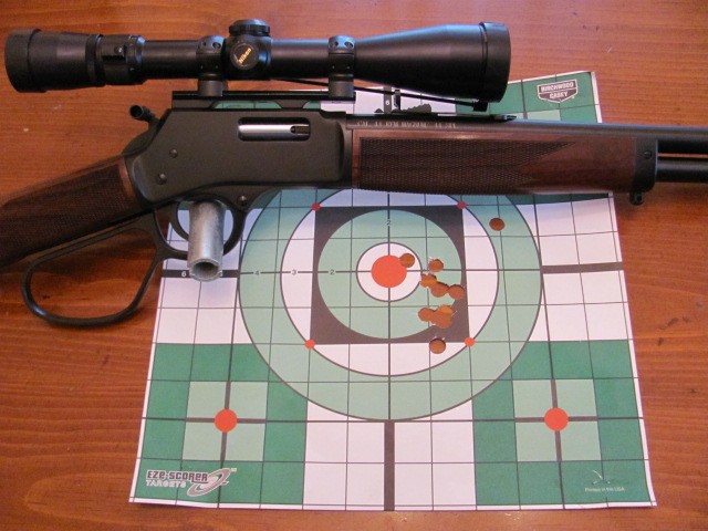

below are a couple of pictures showing targets when we were loading 240 gr Missouri RNFP bullets .... the 25 yard target was fires with Henry Buckhorn sights ... the other was fired, as best I remember at 75 yards, when we were sighting in a scope
