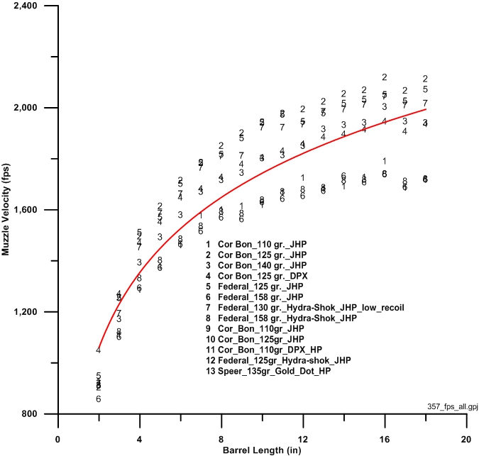

When I started reloading for my Henry 357, I found very little commercially published MV data for a rifle length barrel. It seems that nearly all powder manufacturers’ data is based on revolver lengths. (Hodgdon being the exception – their LilGun pistol data is based on a 10” barrel. Hodgdon does not list a rifle load for LilGun and 158 projectile.) Somehow I needed to extrapolate this information to a 20” Big Boy barrel.
For those not familiar with the resource “Ballistics By The Inch” (BBI) (http://www.ballisticsbytheinch.com/ ), I recommend that you review their results. These researchers start with a long barrel Thompson Contender Encore and shoot for MV. Using a chop saw, they reduce the barrel length by one inch and repeat the chronograph shots until they have produced a table of ballistics by the inch for each ammo tested. (I salute these guys for their work.)

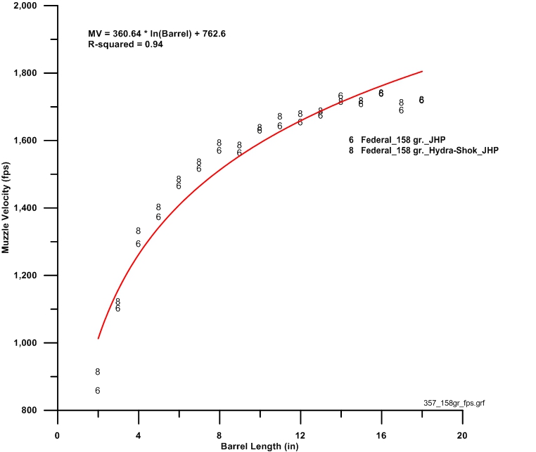

Using their data, some graphics and curve fitting, I developed formulas for 357 MV for various bullet weights. The first attached graphic shows the results for all 357 bullet weights tabulated by BBI. The second graph is for the two 158 grain rounds BBI reported. The curve represents the average results for the two rounds, and provides a good estimate of how to extrapolate pistol length data into rifle length data.
For my particular application, I wanted to estimate the 20” MV from Lilgun data reported for a 10” gun using a 158 grain Hornady XTP. From the graph, you can either estimate the MV for 10” barrel, or back-solve the equation for a more precise estimate. I got 1,593 fps. I then repeated this for a 20” barrel and got 1,842. The ratio is 1.156, so multiplying the LilGun data by 1.156 gives a calculated estimate of what the MV would be from a 20” barrel.

Well, I finally acquired a chronograph and compared the measured MV with the estimates derived from the procedure I posted last year.
For the Hornady 158 grain XTP my estimate using Ballistics By the Inch data was low by 1.8%. For the Hornady 180 grain XTP it was high by 1.4%. For MV data, I am more than happy with an estimate using free internet data that agrees within 2% of measured chronograph results when you don't own a chronograph. But your mileage may vary.
