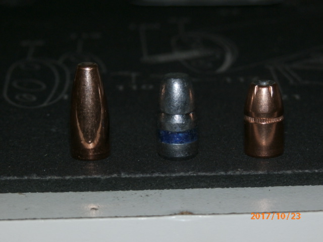

As I reload for both the >327 Fed and 7.62X39 I ran across something interesting. In developing a target load for the 7.62 I ran across a plated flat point bullet of 123 grs that happens to be .313 dia. It works fairly well in the mini-30 ,up to 2100 fps. My BigBoy steel in .327 Federal shoots the Hornady Xtp(100gr) fairly well(2008 fps) , but I would like a heavier bullet for game over 80 lbs. The plated bullets have proven themselves to be cleaner than cast, more economical than jacketed, and capable of higher velocity. I believe I'll try the 7.62 bullet in the .327. The diameter is right at .313 which is the same as the cast 115 gr. 32-20 bullet I use in the Fed, and within .001 of the Hornady 100 grainers .312. Length is my only problem, the plated bullet is .092 longer than the 32-20 bullet. To function in the rifle, I must keep within the max. C.O.A.L. , so I may have to use a 32H&R case. Anyone been here before? Let me know what you think.

Any ideas on charge weight or powder?
The meplat looks wide enough for a mag tube.

I was thinking Long shot or Unique to be safe. I have been using the Lyman cast bullet hand book for plated bullet loads. I have used them with good results in my .357 BBS. I have chronied this bullet in the 7.62X39 at 2200 fps. It held together fine.

I think the bullet in the middle is the prettiest.

The prettiest is the 115 gr cowboy(RNFP) from x-treme. Hard cast and reasonably accurate, but leads the barrel above 1100 fps.

gunman5646 wrote:The prettiest is the 115 gr cowboy(RNFP) from x-treme. Hard cast and reasonably accurate, but leads the barrel above 1100 fps.
Try hard cast from Penn bullets.
http://www.pennbullets.com/32/32-caliber.html
their 95 grainer is rated to 1600 fps
I've had good luck running their .357 hot with no leading.
