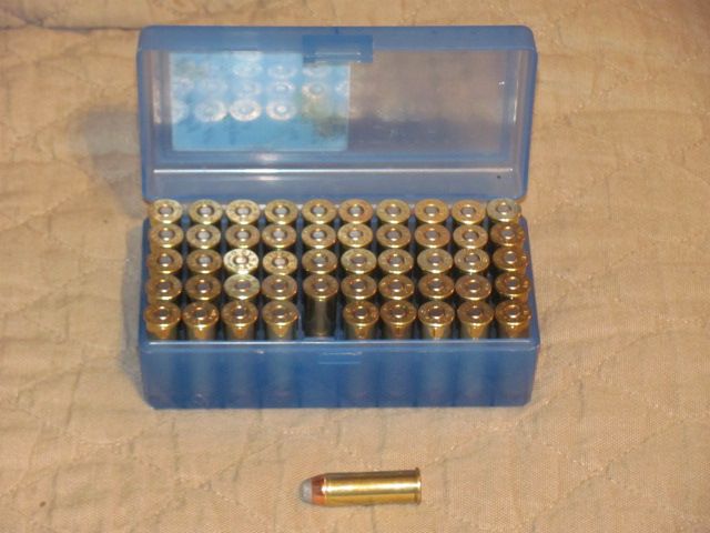

picture one shows our Ruger Redhawk and Henry BBS

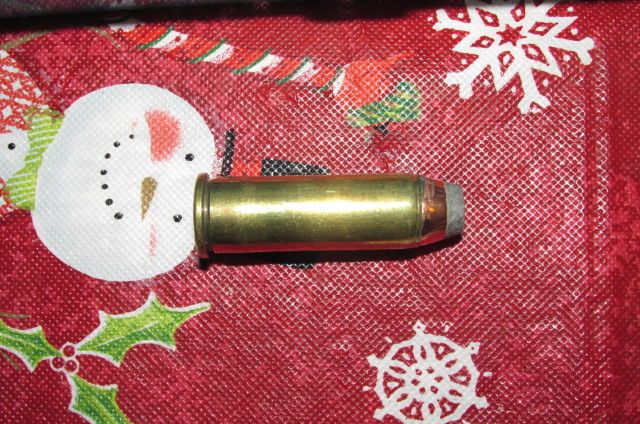

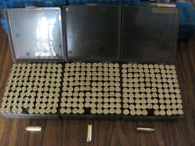

pictures two and three show our practice load .... 240 gr Oregon Trail pushed by 7.2 gr Bullseye (yep, we go through bunches of them
pictures four and five below our hunting load .... 240 gr Nosler JHP pushed by 23.8 gr of H110 or W296
- 160422 003 Henry @ Redhawk 44s 002.jpg (107.37 KiB) Viewed 2266 times
- 161207 002 44 practice 001.jpg (75.53 KiB) Viewed 2266 times
- 160903 005 44 Mag Practice 002.jpg (70.54 KiB) Viewed 2266 times
- 161207 004 44 practice hunting 001.jpg (104.24 KiB) Viewed 2268 times
- 161020 001 44 msh hunting 002.jpg (53.35 KiB) Viewed 2268 times
