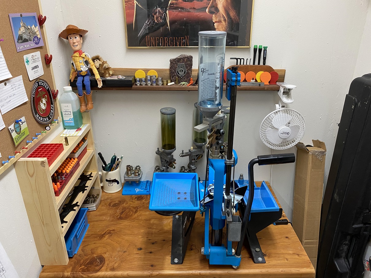

- BrokenolMarine
- Ranch Foreman
- Posts: 7516
Re: Dillon Square deal
Before I made my reply to the OPs original post, I looked at the Dillon Site, and they had the following upgrades listed as options for the Square Deal B press:
22312 - Square Deal B Bullet Tray Kit + $69.00
62395 - Strong Mount With Cartridge Bin Mount | Square Deal B + $130.00
19441 - Square Deal B | Toolholder w/ Wrench Set + $43.00
16306 - Low Powder Sensor + $55.00
I have The Bullet Tray Kit and Strong Mount and Cartridge Bin mount on my press in the picture above for the 550B. I didn't have a need for the tool holder as I mounted peg board beside the press and had made stands for the Allen wrenches and drivers.
I also pointed out that the Square Deal upgraded could work fine, but the OP might decide they wanted to upgrade to a faster press. I have been happy with my press all these years, but I have never been one to worry about speed, I actually enjoy the quiet time at the press.
