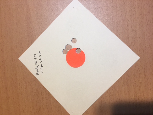

So another follow up. Got a chance to shoot the 140FTX load that worked for me before. Picture is here:
That was fired at 50 yards, and it was after a little scope adjustment on earlier shots/groups. Seems like the rifle tightens up after a few rounds downrange, so this was the last and best group. Still may be able to click a bit left to really center that up, but I'm ok with it there for now. That load shot at an average of 1825 fps for the five shots you see, and my Pact Model 1 worked like a dream today. Might be able to get more velocity too, and I've had those bullets loaded with a few grains more of Lil Gun, but it looks good enough now that I'm inclined to just stay at the 1800+.
This may just end up being my deer load too, but I'll have to see how those cold bore shots work out in the weeks ahead.
I'm still thinking that I could probably load the 110 XTP down a lot, and get good groups, but since these 140s and the 158s all shoot well, it really doesn't offer the option I had hoped it would. I'll just shelf the remainder of the 110s until something else pops up.

Re: Loading .357 With The 110 XTP
Do yourself a favor and do some research on the FTX bullet as a hunting bullet. Me myself if I were to choose a bullet for deer hunting it would be the XTP bullet in 158 grain. Also Lil gun is okay in rifles but I stay away from it in pistols. Its hard on forcing cones. Freedom Arms says dont use it in there guns. I might be off base here but it seems as though you are fixed on the speed of your bullet. Thats a nice group but Im not a big fan of that bullet. Just my.02 worth

Thanks Al. Appreciate your response.
Not fixed on speed, but it's a big part of the equation. As good as that 158 XTP is, it wouldn't be so good at 700 FPS, it wouldn't open up. Might as well be a FMJ at that speed. Staying at or above the range that a bullet is designed for is important, especially for an expanding projectile like a HP
The deal with Lil Gun is probably a good subject for a topic unto itself.

I can't speak from experience with 110's because I've never loaded any. I do know that if you kick the 125 gr. XTP out at 1700 to 1800 fps any varmint inside of a hundred yards is going to come unraveled. I'd take a guess that accuracy would be much better too.
I have never loaded the FTX either but your rifle sure seems to like them.
