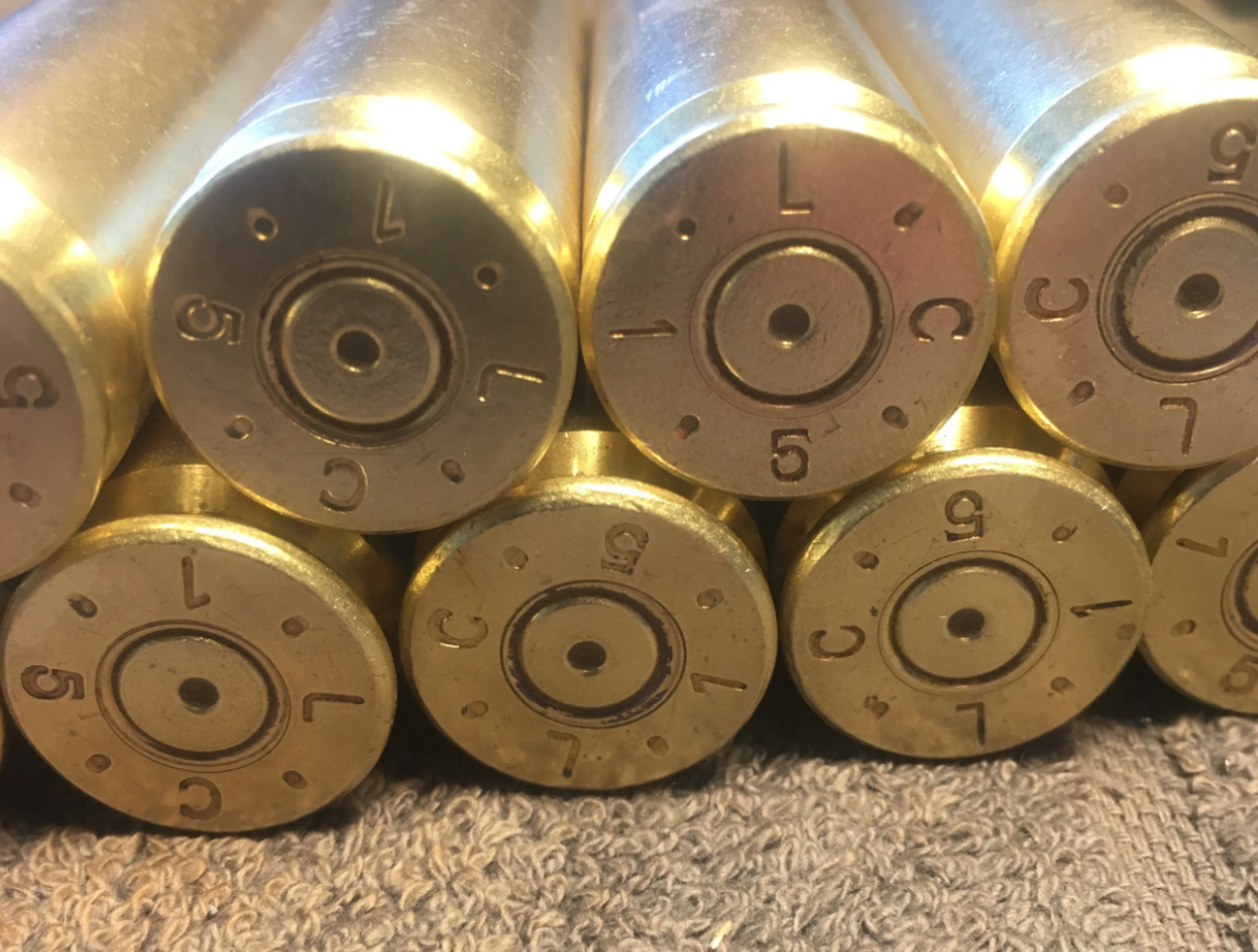

I want to try some for a pet project, as inverted “end caps” for .327 Federal Mag snake (shot) loads, which uses .312 bullets. I can’t find these used primers for sale anywhere, got a source you can share? If you reload this caliber, I am willing to pay a very small amount, negotiable. Also, if we can’t meet, I would be willing to pay for cheap shipping in a padded envelope.

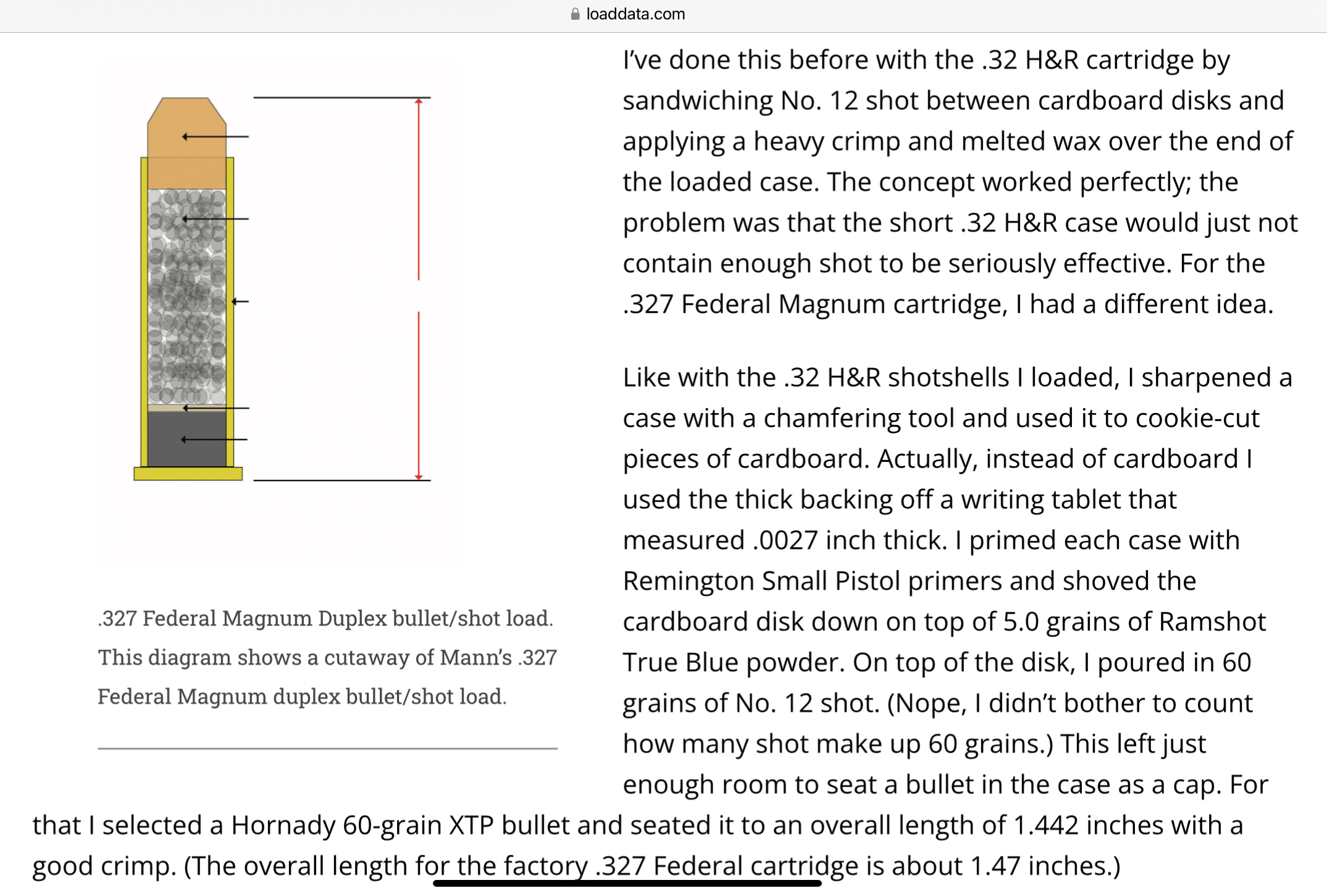

BTW,I found a neat article for a duplex snake load using a .60 gr .312 XTP bullet, but those are long discontinued, and I can’t find any replacements. I think an upside down .50 BMG primer *could* work well in place of the bullet..

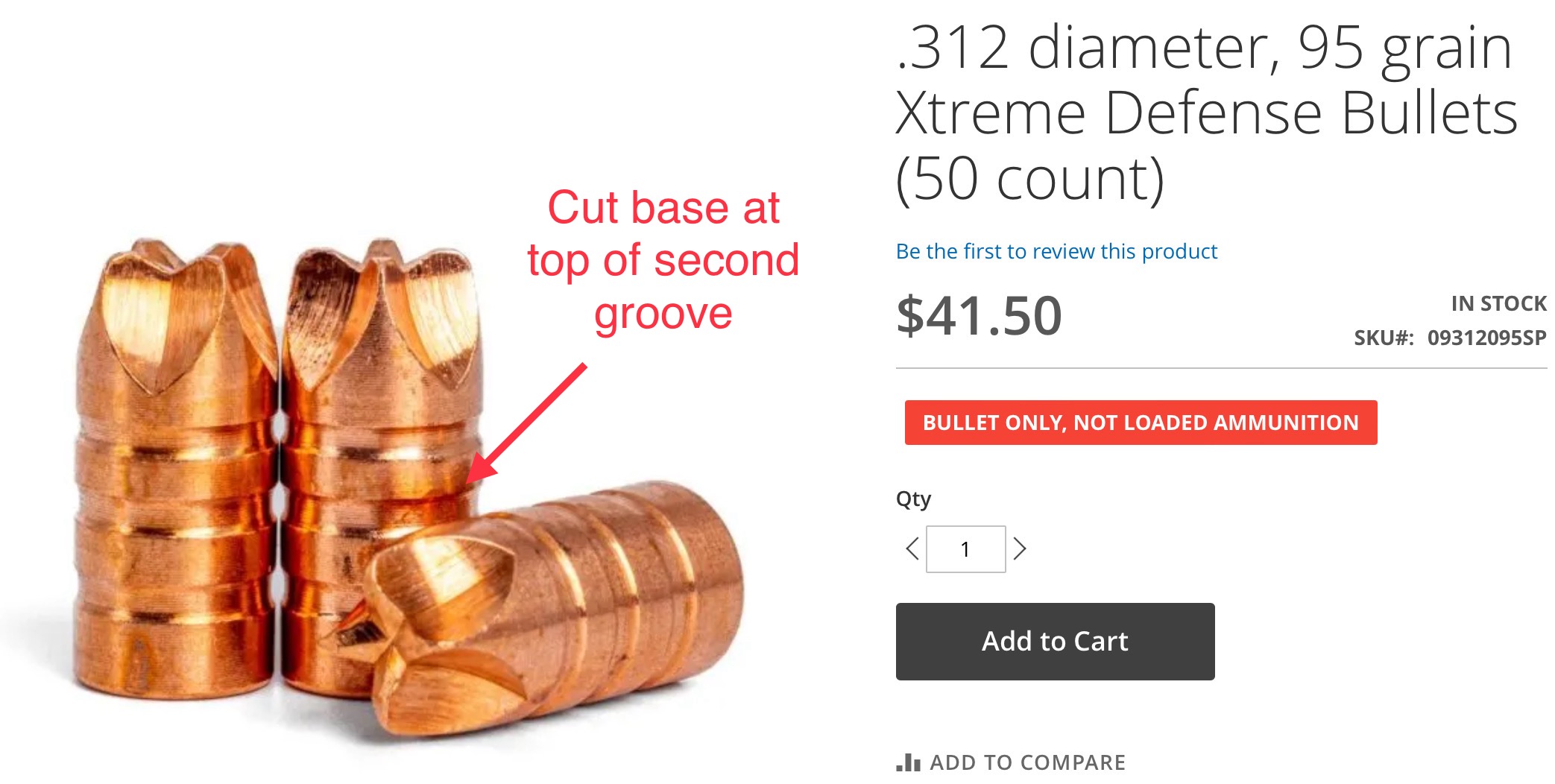

An alternative solution is to cut down LeHigh Extreme Defense 95 gr solid copper bullets in a lathe, as short as possible while retaining a single crimp groove. I would counterbore the base deeply so I can get additional lead pellets inside it. I already have those bullets, and a Sherline micro lathe, but I would prefer a cheaper, much less labor intensive alternative…. Used primers.

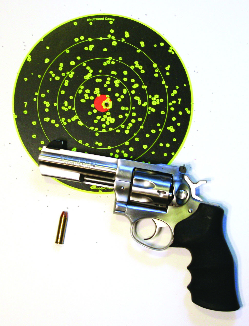

Thanks for the comment. I want to kill a rattlesnake at 6 feet, collateral damage to structures is not exactly a design goal….
The #12 duplex load mentioned in the article patterns nicely:
https://loaddata.com/Article/BenchTopic ... Magnum/138

Second, aren’t they a little oversized, since you run the cast bullet and gas check through a sizing die to form them before loading it into the case? I know that spent.50 BMG primers will work, as per a different forum, because the primer pocket on that cartridge is .312. Exactly the right size.
I may end up just using those .312 LeHigh bullets, because I have a couple of boxes already and I can machine them shorter. LeHeigh offers that style bullet for .32ACP (50 grain) but they are .311 and I prefer not to shoot them in my SP 101. Though one reviewer says he got 2200 fps from a 4.2” SP101 barrel with good accuracy and minimal recoil. I find that information a little hard to swallow.
