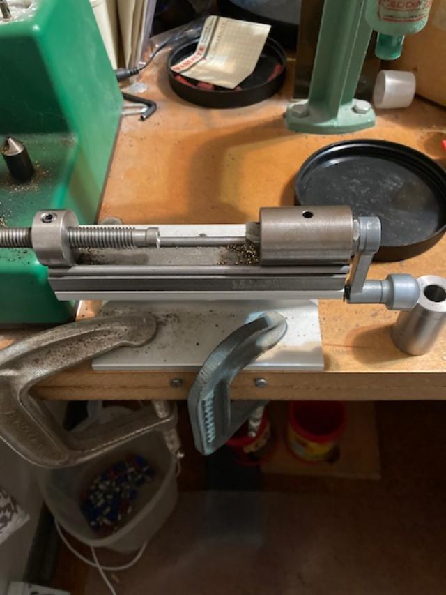

Most of my manuals show a maximum case length and a trim to length. The .30/06 for example is 2.494" max with a trim to length of 2.484". Back in my precision shooting days I bought a L.E. Wilson case trimmer. It requires a different case holder for each "family of cartridges" such as .243 Win, 260 Rem, 7/08 Rem and .308 Win can all use the same case holder. It will trim cases consistently within .001". I doubt if that sort of precise trimming is necessary in a factory production rifle and doubt if .003" variation would be noticeable on paper.
Case trimming is my least favorite part of handloading but when cases reach maximum I grit my teeth and start cranking. Case trimmers have progressed a lot since this 45 year old Wilson but someone else will have to chime in on the latest developements.
Case trimmer.jpg (55.77 KiB) Viewed 2480 times

You're sure getting the most out of that Wilson!
I'm using a Lyman Universal with a drill to drive the cutter. I also have a Lyman Express which works pretty well.
