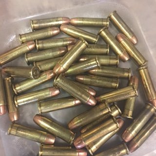

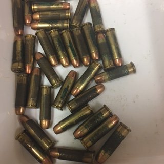

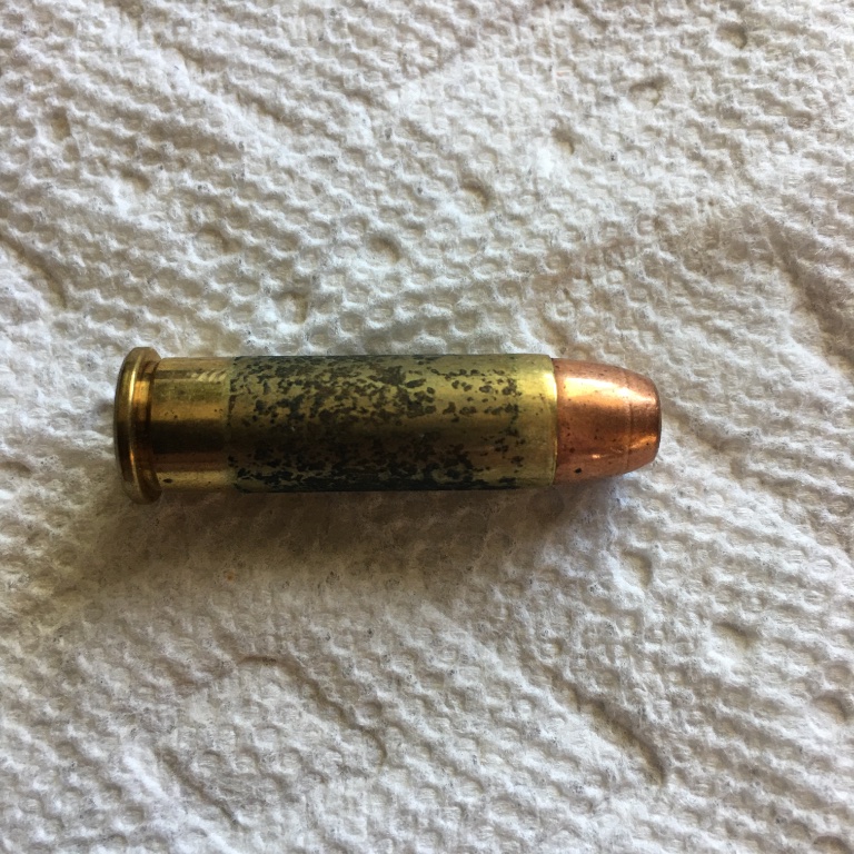

Hey y’all. I’m looking for ideas to clean the corrosion off of loaded rounds. These 38s have been in a bandolier too long.
I’m leaning toward using my pin tumbler. Risk of water contamination?
I have a couple hundred, so hand polishing is not going to happen. Unless you know of a miracle wipe.
What do you think?

They were too sticky to load. I went ahead and ran them through my tumbler. No water, just wet pins. After I was done, it took a good pass with dawn. That cleaned my pins. About 30 minutes per 15 rounds on the cleaning. Not bad results. After shooting, revolver only, they will get a real clean and polish.

Do not use the Brasso version that has ammonia. It causes corrosion stress cracking in hard brass. I would have dry vibrated them in walnut media, I never put loaded ammo in a liquid.
