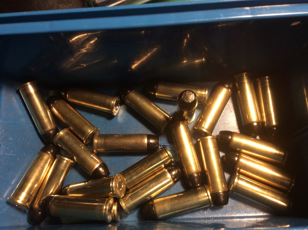

Loaded a small batch of MB 200 gr. Cowboy #5 bullets with 8.5 Unique to try in my 1873 Uberti Carbine. Much the same as a .44-40 load but in the Magnum brass. Should be in the 1200-1300 FPS range and will check that while testing.
- 200 gr 44 mag load for winchester 1873 8.5 unique.jpg (131.17 KiB) Viewed 1725 times

Re: Mild 44 Mag load using 200 gr. RNFP
Looks good... now to see if the Uberti likes 'em.
Hoping to get out Sunday to try them out before late afternoon rain moves in.
