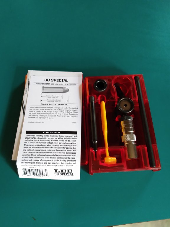

Things are starting to trickle in.. If you just want to get your feet wet on a light budget LEE makes this handy little loader, it's slow but quite satisfying, you will get a press but these little kits are great to have. Just wanted you to know another option..OB

Re: How to get started
Ha! Have one of those for my 30-30. Right there in the cabinet.
That's the one I started with OB, 12 bucks back in 1970 !
