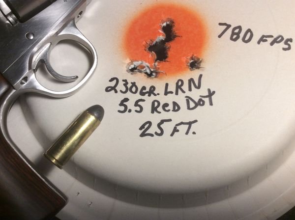

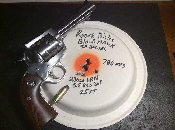

Tom I haven't used it in 45 ACP but it shoots well in 45 Colt for target loads. Try 6.0 gr with a 250 gr. bullet and might work just as well with a 200 and 230 in the 45 Colt brass. I use 5.5 gr of Red Dot with soft lead Speer 230 gr. bullets in 45 Colt for my 1858 Remington revolver.
In 45 ACP you might want to reduce the load due to less case volume.
nice mild 45 colt load.jpg (40.71 KiB) Viewed 1822 times
230 gr speer swaged lead with red dot powder 45 colt.jpg (37.36 KiB) Viewed 1822 times
