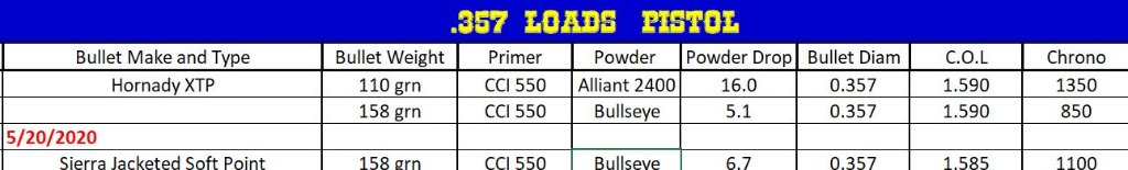

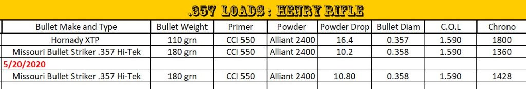

Post by runnin n gunnin » Mon Nov 22, 2021 7:08 pm
I have not. I have been using Bullseye and Alliant 2400 for .357 for both pistol and rifle. As you can see by the data, I have not played with loads for over a year as I was out of small pistol magnum primers. However, I just scored 2 bricks of Federal SPM and 2 bricks of CCI SPM, so I will be gearing back up soon.
Here is what I shot and how they preformed:

runnin n gunnin

Post by runnin n gunnin » Mon Nov 22, 2021 7:09 pm
Well that sucked, sorry for the distorted pictures.

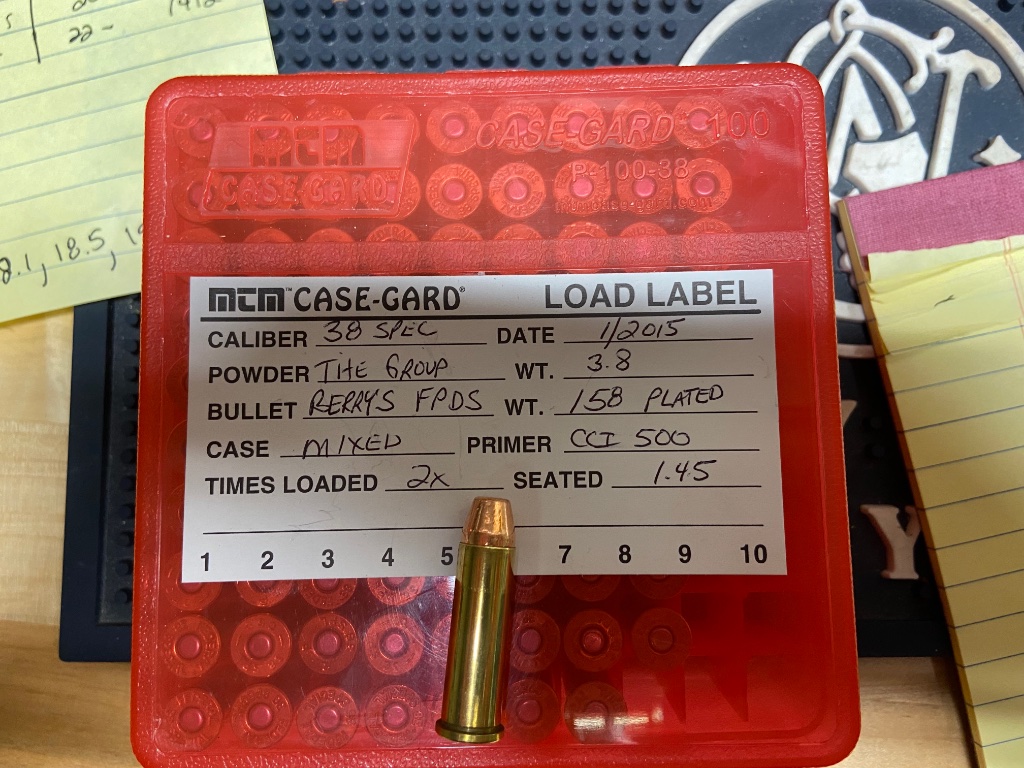

Post by Hatchdog » Mon Nov 22, 2021 7:52 pm
I have these 38’s loaded using Tite Group and a plated bullet. I didn’t run much of an accuracy test as I recall as I loaded these for casual shooting in a Poly Ruger LCR and my K frame Smith 19 that I don’t run many full power 357’s thru. But, seeing the load date of 2015 I guess I had better get out and shoot some!

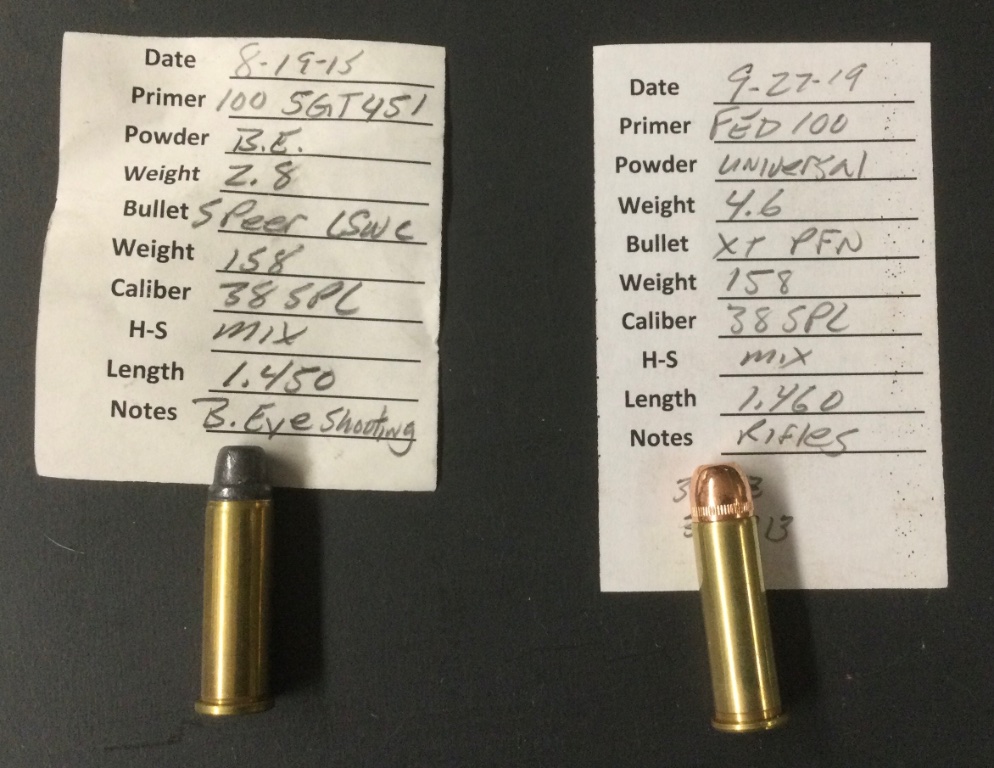

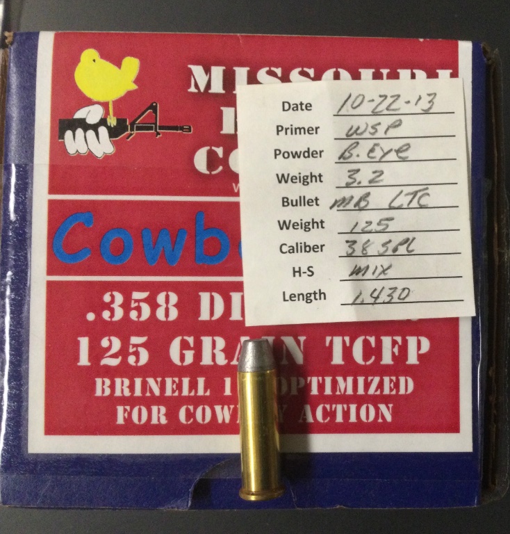

Re: .38 spl loads
Post by Ceapea » Sat Dec 18, 2021 10:28 am
Here are a few of my recent favorites.
Pay no attention to the dates shown. I initially put together many different recipes, and didn’t get to test them for a while. :shock:
Also, I say recent because I recently found them to be excellent in my fairly new rifles. Previously, they were made for handguns.
