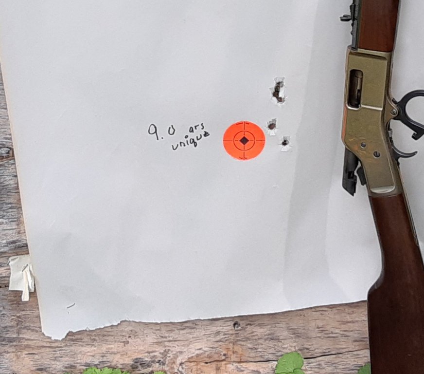

John, I haven't played with mine very much since I got it back from Henry last year.
But I was messing around with it a couple months ago using a 240gr Smasher from Missouri bullet co over some Unique. Those are .430 in diameter.
Here's the best I got that day, was shooting from around 40 yds.

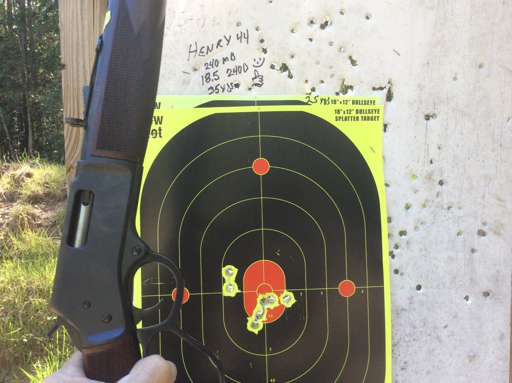

Re: Cast bullets in the 1/20 twist 44
I shoot the MB cast 240 gr. bullets in mine that are supposed to be 18 bhn. With light magnum loads under 1500 FPS I would get a key hole in 7 shots and point of impact was off. Bump up the load to 1500+ FPS and no key holes and POI would move more to center with a nice group.
The bore on mine slugged out to .4315 which isn't giving a whole lot of rifling engagement. Bumping the load up to higher level Magnum must be expanding the bullet just enough. Now when shooting Jacketed bullets like the XTP everything seems fine even though those bullets run .430
Count yourself lucky you got the perfect .429 sized barrel!! If you go with the softer bullets like 11-12 Bhn stick with speeds under 1500 FPS unless they are coated bullets.
This is the load I like with the .44 Mag Henry Carbine and the cast 18 Bhn bullet!
